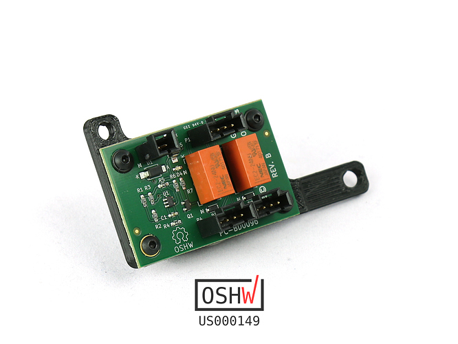

2 - We then moved the Z cable to E0 on the board, heated up the nozzle to 150*, and extruded either direction (but in actuality we were trying to get a signal to the motor, not the motor on the actual print head.) pinout below:
Didn’t get any Z movement on either motor when doing that.
3 - Then bypassed each Z cable from the z brake board, directly into E0:
and I got movement from both motors separately!
So, looks like the Z Brake Board is bad and will have to be replaced.
Just wanted to update this thread in case anyone else runs into a similar issue.
So if the Z brake board is actually bad, you could verify that in another way. You can actually take both the motor cables that plug into the Z brake board and plug them directly into the two Z connectors on the Einsy Retro board. You should be able to power the printer on and get movement of the Z motors. Not sure why I didn’t think of that before.
The purpose of the Z brake board is to try and hold the Z motors in position when the printer is powered off, and I don’t believe it actually does much when the printer is powered on. The side effect of bypassing the Z brake board is that when you power the machine off the X axis might droop down on one or both ends.

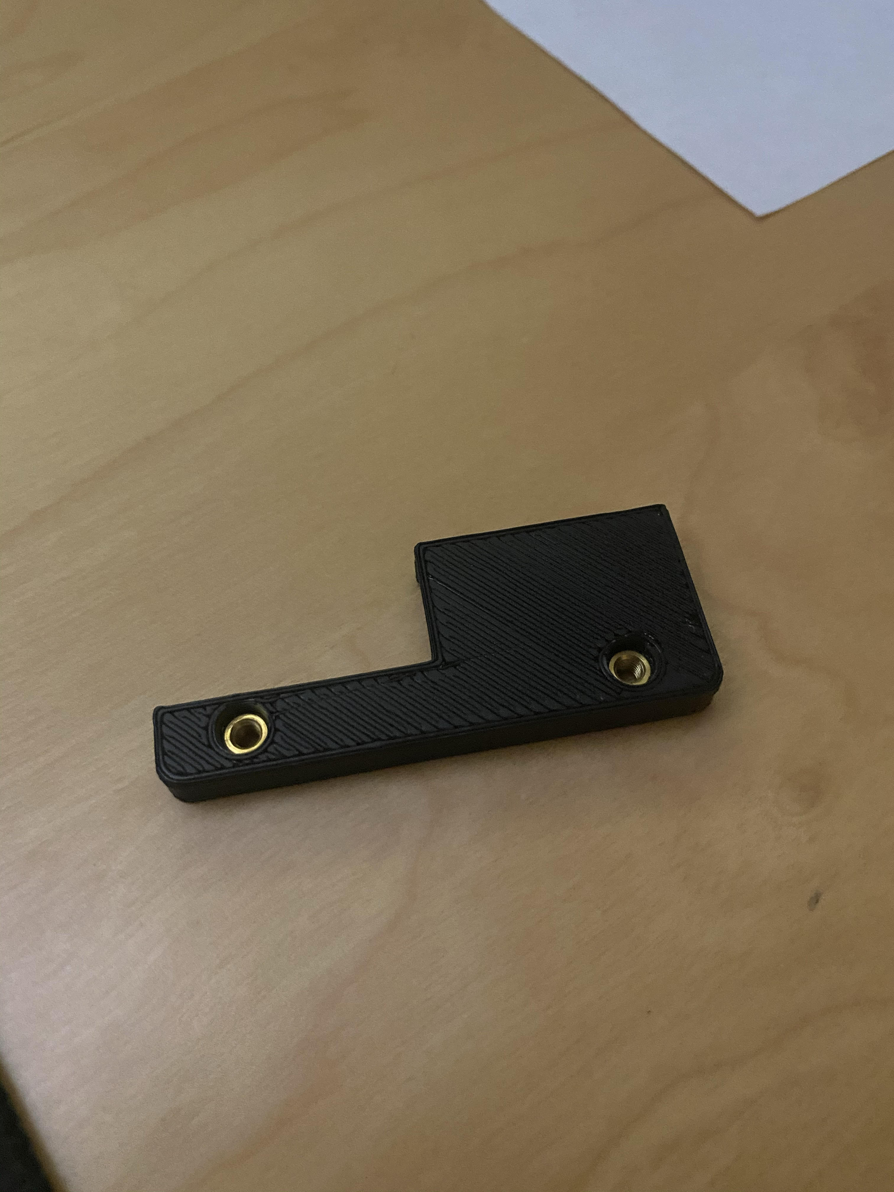

Wonder if this part that I’m not sure where it goes has something to do with it? :slight_smile:
It feels like the switch isn’t being pressed so it keeps going up.
Any idea where it goes?
That looks like the bracket that holds the LCD ribbon cables to the left side plate of the frame, above where they come out of the control box cable hole. Not sure why it isn’t in your printer. :slight_smile:
See the OHAI assembly instruction page for Mini 2 final electrical assembly, step 15, to see where it goes and how to install it.

I tinkered a bit more with this and got it going. I manually pushed the Z all the way to the top, and while it still struggles from time to time, it’s good enough for now. I feel like the bushings might need some cleaning. The right side tends to “push” down and looks uneven when I level the X axis as well, but it still prints “ok” (could still use some tuning).
In general my lulzbot needs some maintenance - I have over 53 days of print time without doing any major maintenance on it so I’m going to run through the maintenance documentation and do that. I also ordered a new .5 nozzle along with the z brake board.
That part was removed because I mounted my octoprint pi to the side of the case - the screws go into the same holes as the rogue bracket I found. Surprised I still have it around years later!
