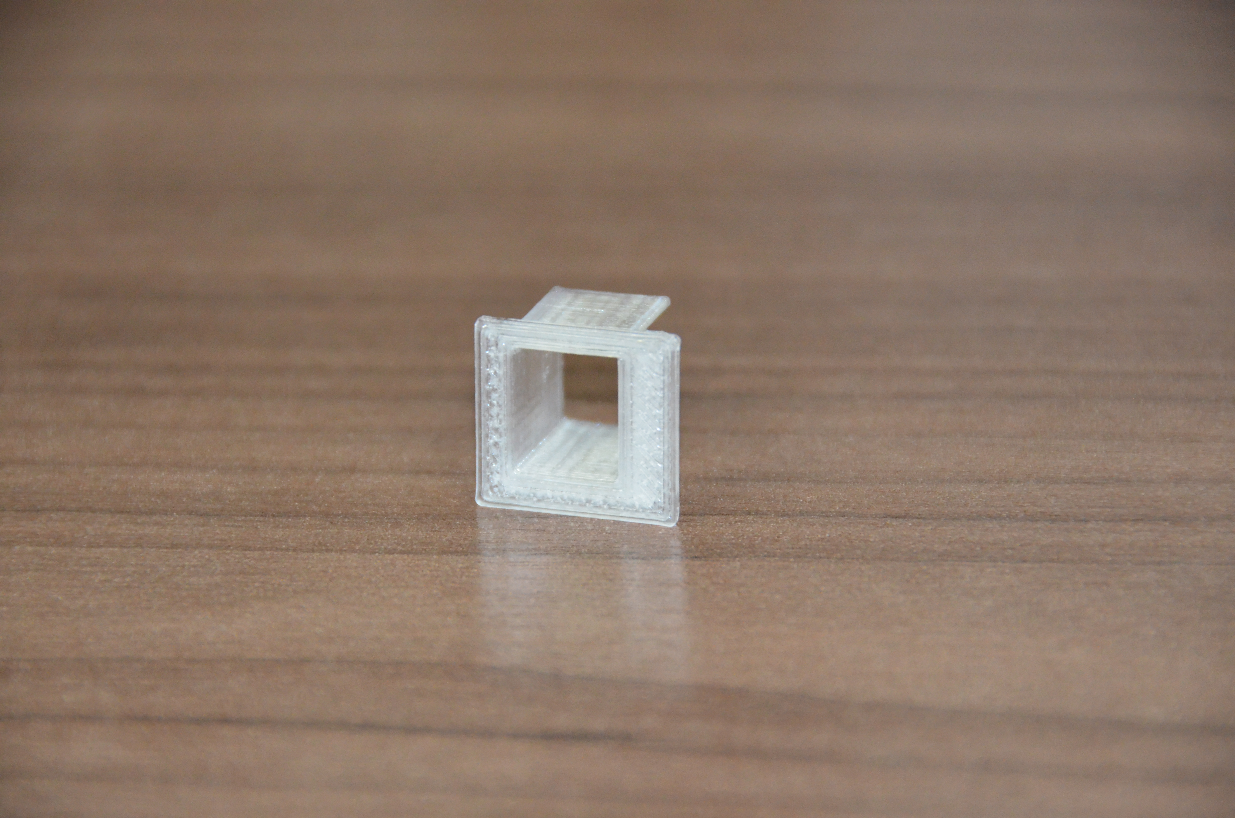

After seeing a broken USB port on a Mini, we did a little design and came up with this USB support (so that solder is not also acting as a mechanical joint).
The whole idea is print one out, snap it into the opening for the USB port on the mini-RAMBO and it helps prevent the USB port from breaking off. Enjoy!
(More improvements likely to come)

Nice! Does that line up with a Taz USB port as well?
I tried my Taz 5 and my Taz 6 and they did not. :cry:
Works great! See attachment.
Works Great!
Does installation require opening up the RAMBO enclosure?
Edit: It doesn’t want to just slide in on my mini. Do newer minis already have some kind of support added?
Nope

Thanks, guys. I figured it out (fairly obvious once you actually print out the part - no way it could go on from the outside). I was able to install it without unplugging the case fan. I just opened up the case just enough to reach the USB socket, and slipped it on.
