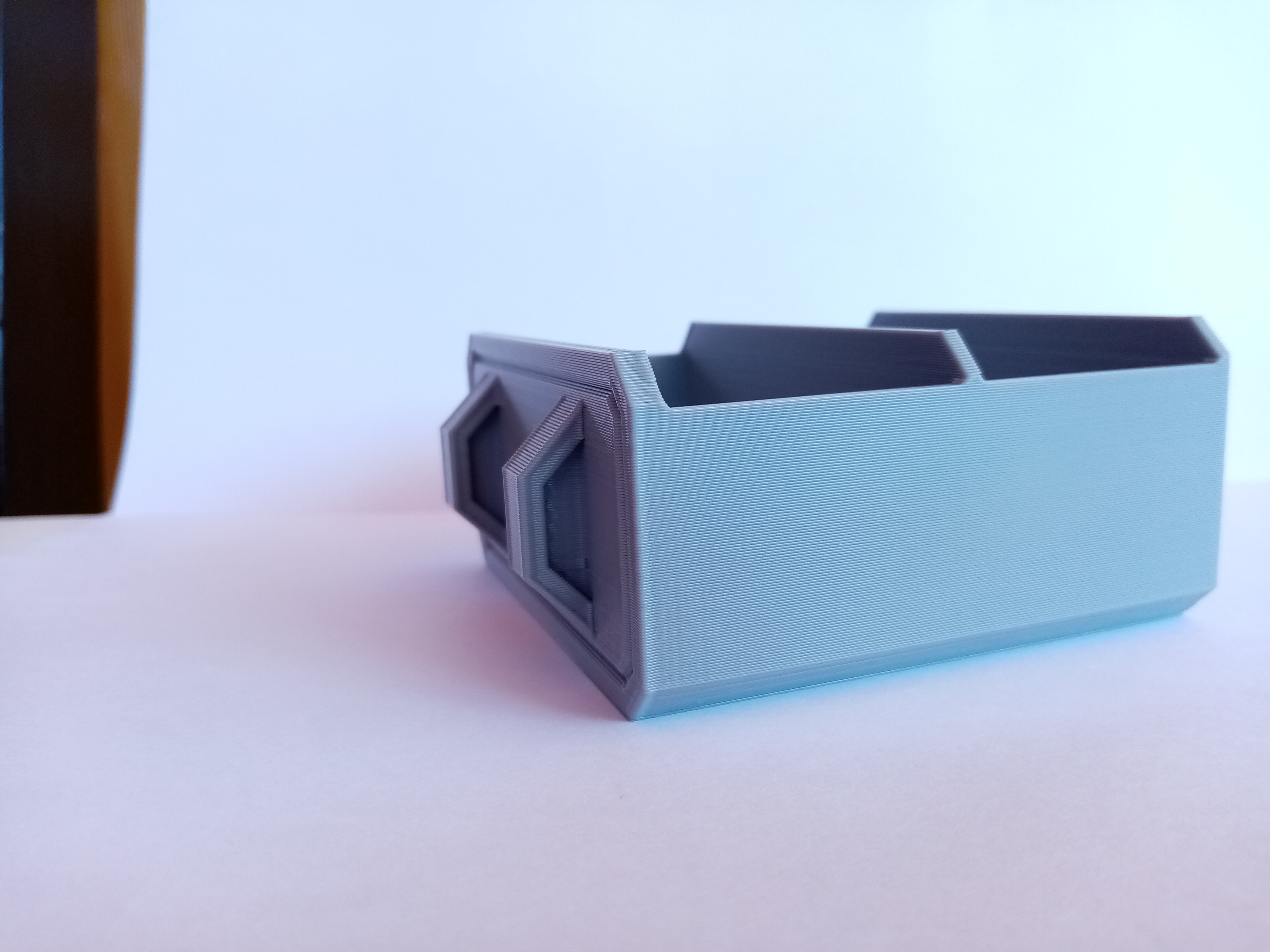

My lulzbot Taz workhorse does not leave good finishes, I already checked and adjusted all the mechanics well, some things were loose but still I could not improve the finish, I printed it with polimaker pla, how could I solve this problem because with this finish it is not enough to do print jobs

I would advise you to check all the bolts of the mechanics, in my case they all came loose I had to tighten all again

Tightening the bolts helped a lot, mainly tightening the xyz axis motors, the printed parts that make up the linear bearings of both the impression base, z axis and extruder support.
Also remove heal settings which I would not use, settings like jerk control, acceleration, small gap fill, etc.
With all this if you achieve excellent finishes.
I also reduced the extrusion flow to 95%

Congrats! that print looks amazing!!
Thank you!!
In my case that ise and the results are excellent, I practically checked all the printer bolts and tightened the loose ones
