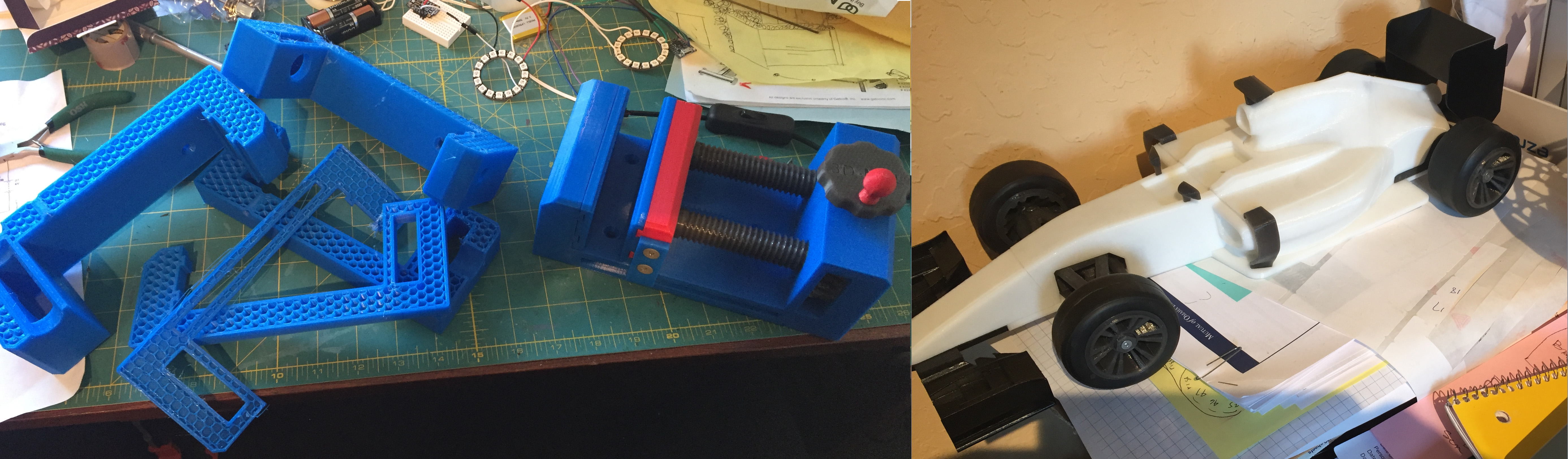

SO I purchased some of their filament a month or so ago. Couple rolls of their maker series. Printed like a charm. Used it to print the OpenRC F1 car. No issues. Bought from “standard” inventory.
