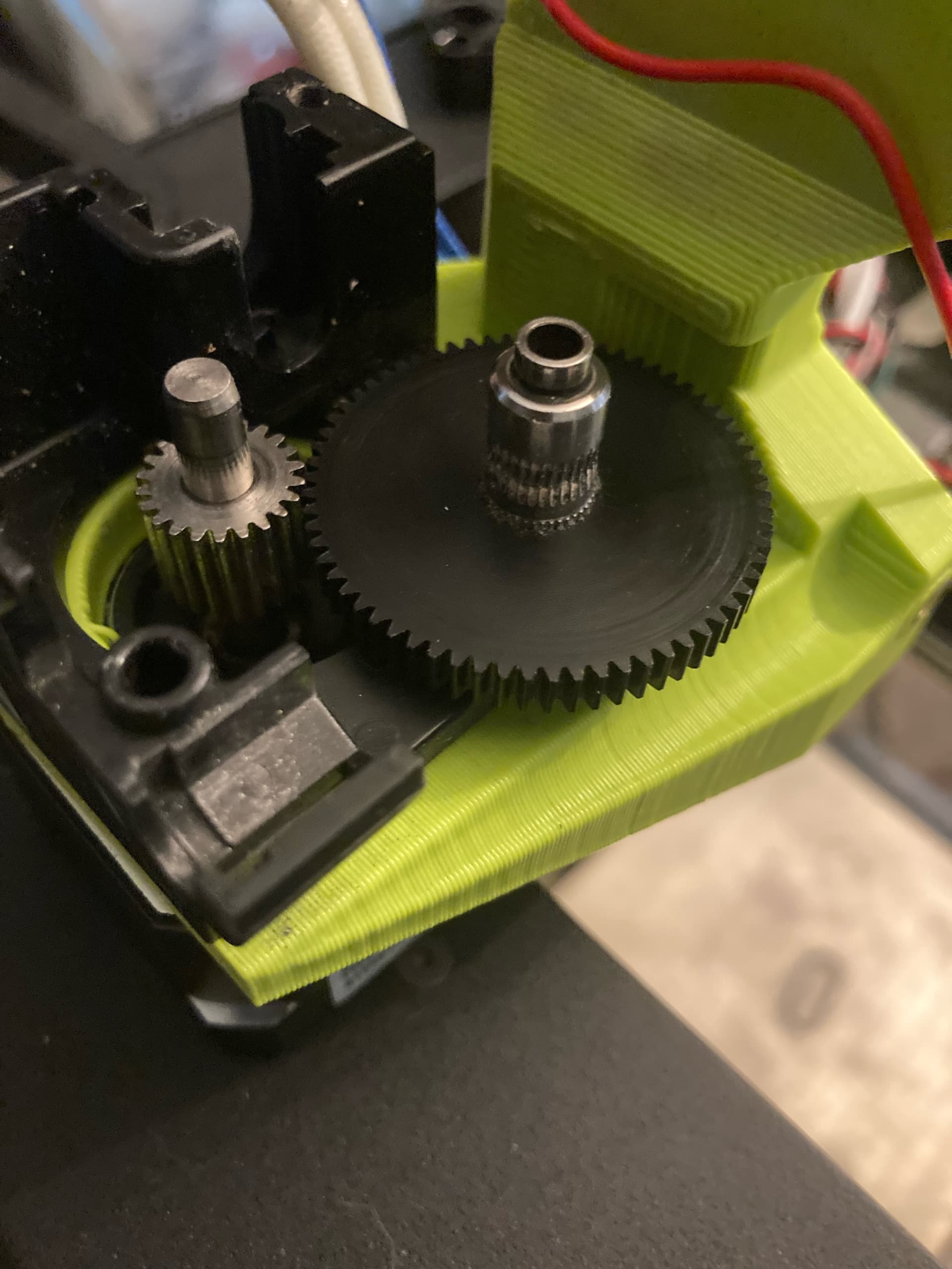

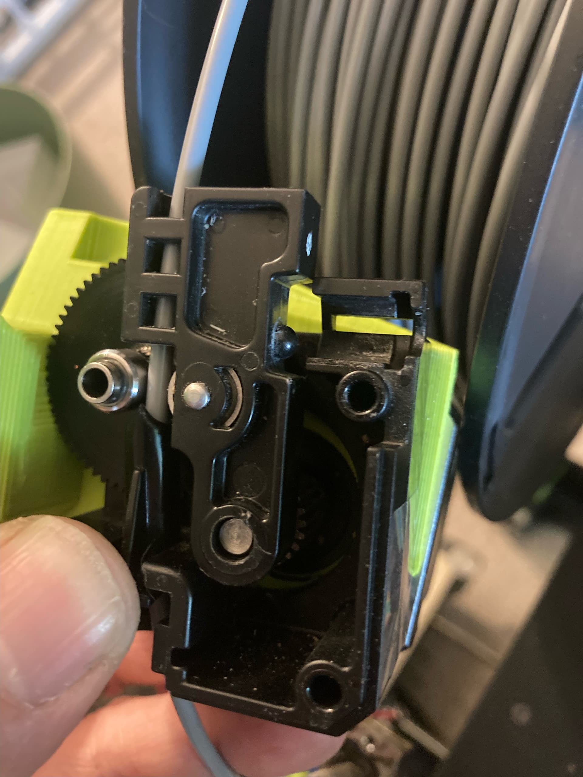

Anyway, attached are the pictures. And for however many times I’ve done this, the grounding wire crimp ring broken finally broke off this time just so I could get these shots. :slight_smile:
Everything here pictured looks ok, but the tensioning screw, spring and nut aren’t present, and would be one of the more likely things to be the cause of failure.

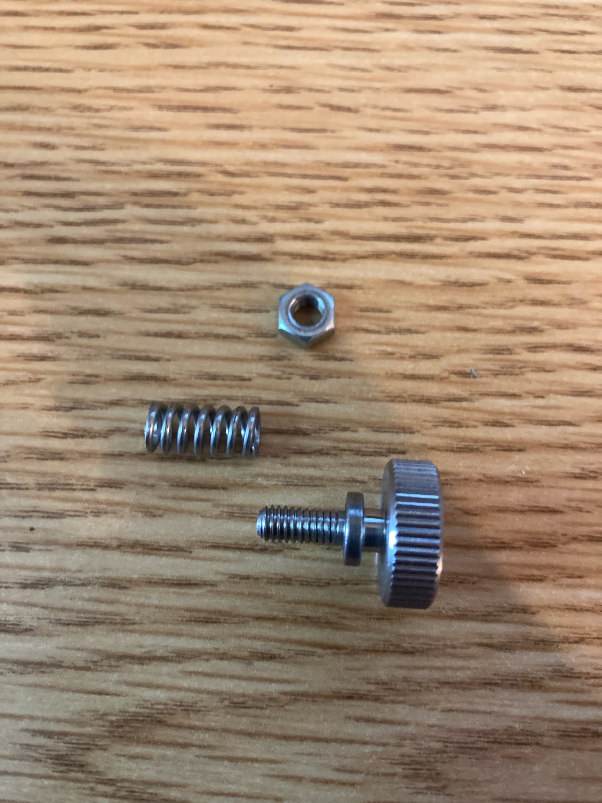

That’s because I took them out to get a separate shot of them. Apparently, the forum software didn’t like it.

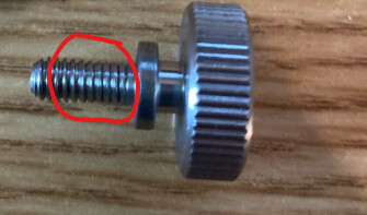

Yeah, these threads are stripped:
Should look like this:
Cheap to replace though: E3D Titan Thumbscrew - 3DJake International
Be sure to replace the little M4 nut too.
