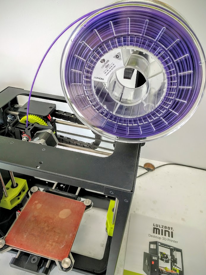

Thanks for the info, i-t-w.com, that’s pretty much what I figured. I have been experimenting with different filaments and really like the way nGen prints but some prints with thin walls are a little brittle. I tried some nVent but never got to the same level of print quality as the nGen, of course that was probably my settings, but I could never quite get there. I have done well with PETG and like it for certain things. I just received a roll of XT and am going to try that this week. I’m looking for strength and beauty… (who isn’t?) and dimensional accuracy, so Inova 1800 may be just up my alley, and I like the idea of supporting my local businesses. That’s one reason I bought my Lulzbot Mini in the first place. I also bought my replacement bed from IT-Works recently following a tragic print removal mishap and the new bed is excellent. Given my great experiences purchasing from my Loveland neighbors, I will have to try some Inova 1800. :smiley:
