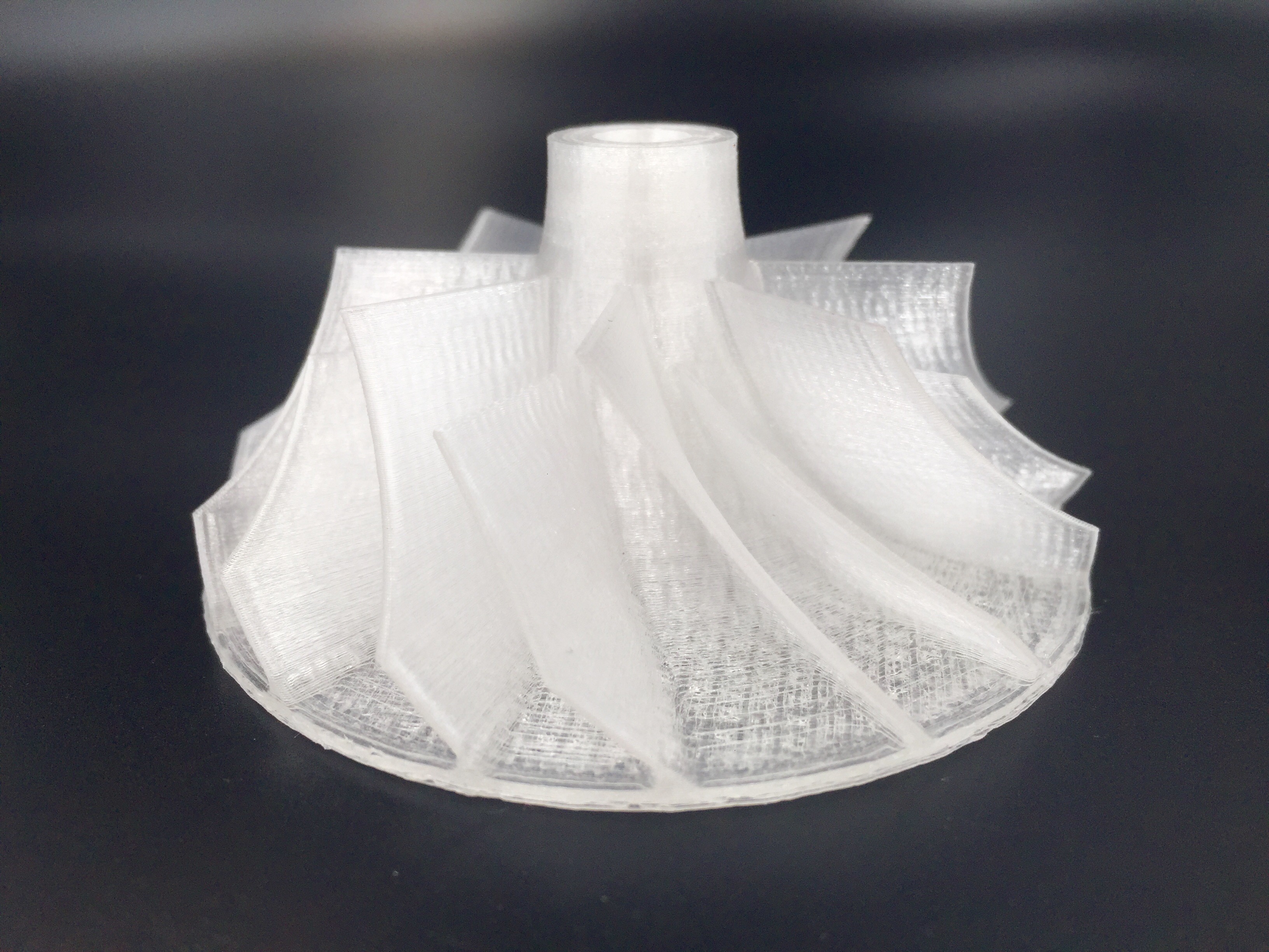

Hey Robajohn, I bought a my first printer two months ago (Taz 6) I compulsively test things and with my limited experience the best prints I have gotten were with colorFab nGen; however I have to add that the clear printed much better than the white. I’m not sure why there would be a quality difference but this was my first print with it. I did use S3D and only tweaked the cooling and heating settings. Their bamboo filament prints beautiful as well but make sure the retraction speed isn’t to fast. It broke and I didn’t notice for an hour, it took me about 3 hours to unclog my hotend.

Cool! Good info! BTW, that impeller looks awesome!
