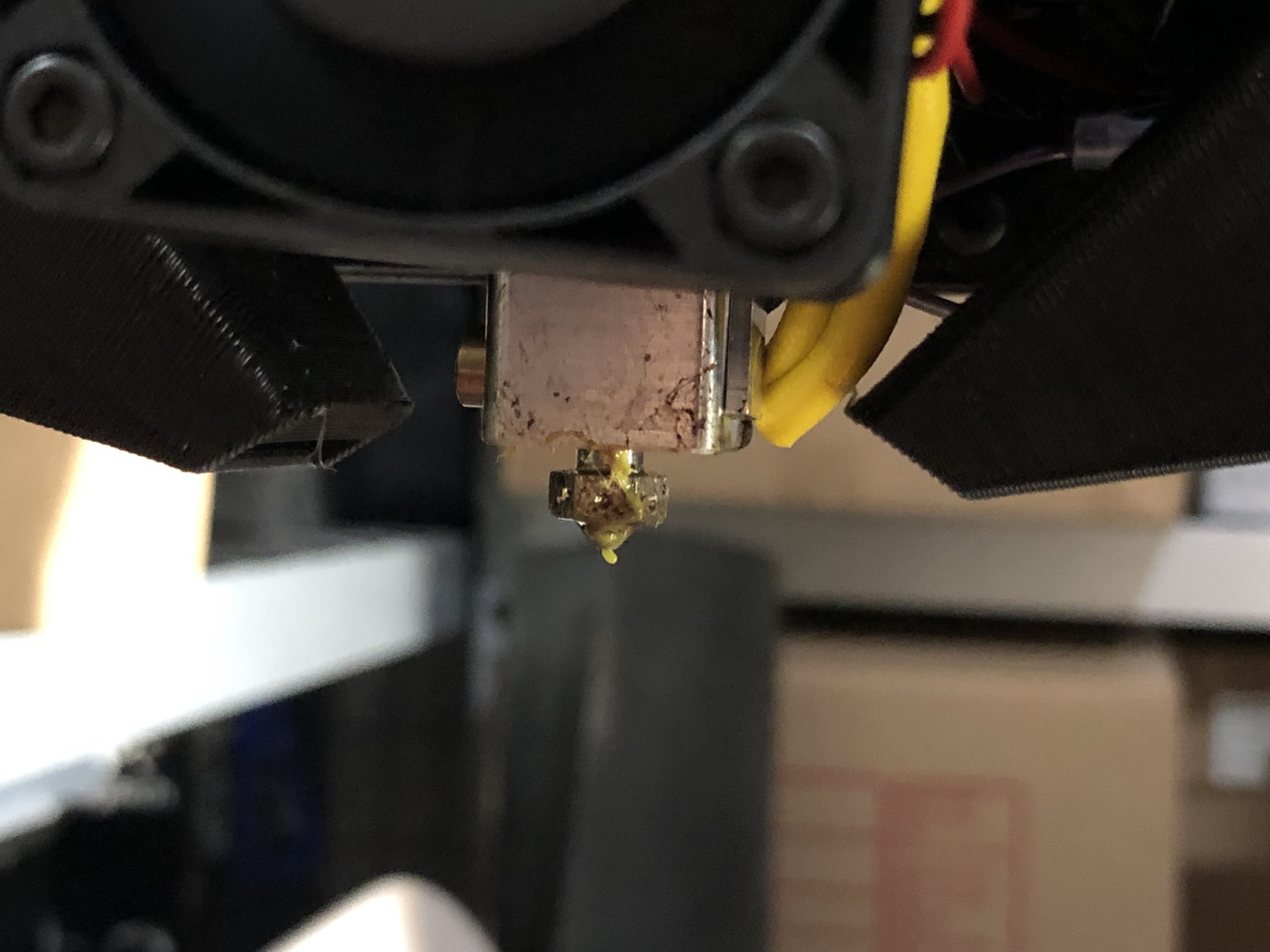

Pic of the extruder below. I tried to turn it but would not budge, maybe there is material above that will not allow it to move up. I did not adjust. I will need to figure out how to do the direct code above for the leveling and then can report back.

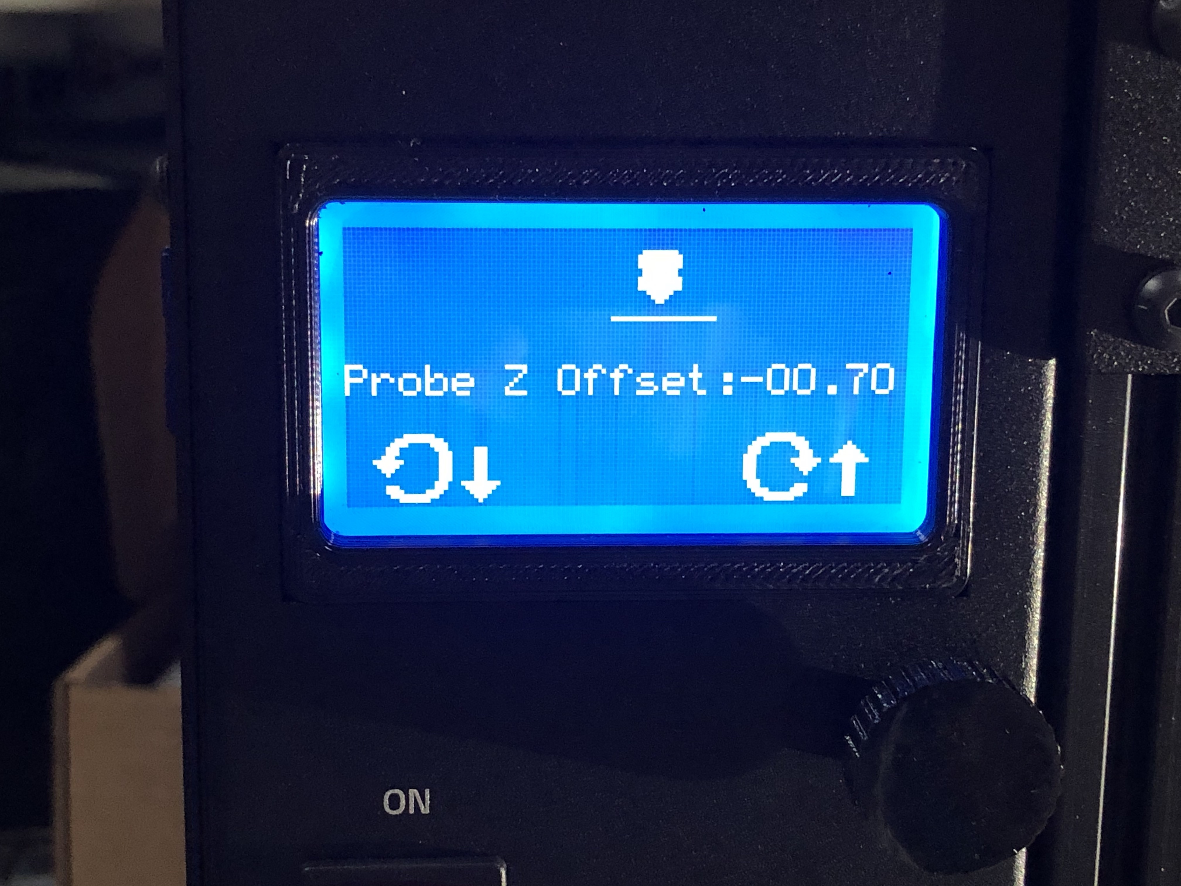

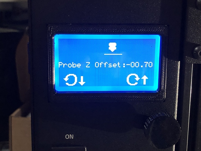

For the Z offset, I went directly into the printer, Configuration>advanced settings>probe z offset and then turned the knob to get the desired number. I changed it to -.5 for the print I am doing this morning, see blue coaster, definitely more bead like.

Also, your nozzle appears to be screwed in all the way. Do not over tighten it, you risk the chance of snapping it, brass is a fairly soft metal.
