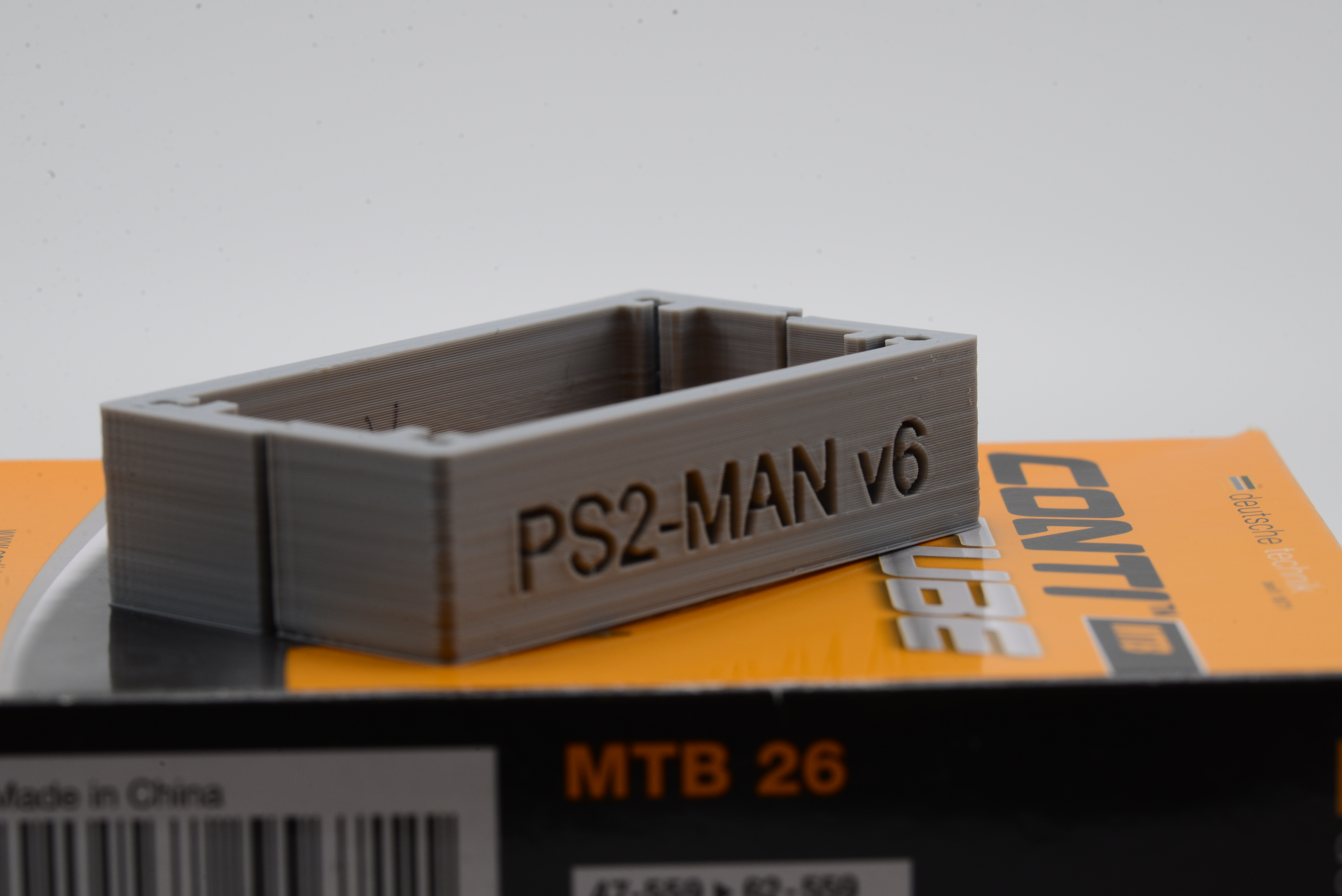

As soon as I attempted to make the print that I am trying to work on, I noticed the massive elephant foot on my first print. It is two halves of an extrusion which I had hoped to prototype with this technology. Both sides are exactly the same and when rotated 180 degrees they lock together. Initially the parts could not connect because of some slicing issues (the extrusion was too fine for the nozzle I have on this printer), but I quickly figured that out and modified the model to match my printer’s nozzle size.
Once I solved the nozzle size issue I quickly noticed the elephant foot after my next attempted print. It had always been there, but wasn’t really an issue for the rocktopus (as it had no straight edges to see it on,) and it didn’t cause any issues with the fidget spinners I printed for the kids. :wink:
You can see it is very pronounced on these early model attempts (images above,) so I looked into how I can get a better print. I quickly discovered the first layer flow rate factory setting of 110%, and reduced it to 100%. At this time I also calibrated my extruder steps, as they were also substantially off using the factory setting.
Things got a bit better, but the elephant foot was still there (see image above.) At this time I decided to try building the model with the side flat on the bed as well as vertically, this is when I really noticed how smushed into the bed my first layer was. I had absolutely no detail in the text at all, in fact some of it was completely smushed together, this indicated a z-index offset issue (see image below.) So this is when I started to try to adjust this as above.
The point to all that is that I did find the initial flow rate setting, and have tried anywhere from 90% first layer flow rate, to the factory 110%. The only way to reduce the smudging (smearing?) I was experiencing was to raise the z-index offset. Which has now gotten me closer to where I had hoped to be out of the box, the parts actually fit together now, but I cannot print like this on different parts of the bed, as the prints stick differently everywhere. Sorry that I forgot to mention that in my first post.

I am confident that my flow rate and percentage are good, again evidenced by the last part I made (grey). The issue is that the machine is not laying the first layer onto the bed evenly, and the z-index offset seems to be wrong on certain areas of the bed .
