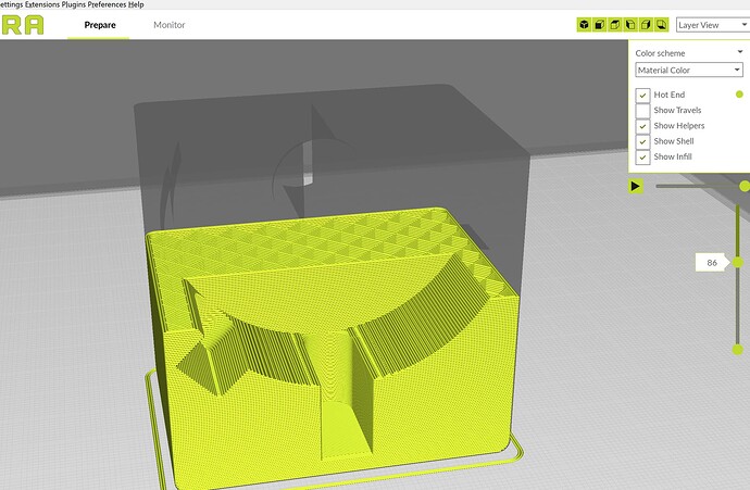

Once you’ve done that, slice, go to layer view, find the layer you want to pause at:
Under extensions, go to post-processing → modify GCODE:
Put the layer number or height, and where you want the head to park (Y should be 290 to bring the bed forward). Close and slice (Prepare) again. If you look at the GCODE, you’ll see the pause settings inserted before the layer you chose:

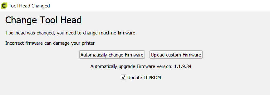

I set the tool head to SE0.5 and set the EStep from it previous working firmware value and launched a Pause height test print and it come back with
When the printer initially boots it lists the Universal 2.0.9.0.13 as loaded
I ended up using the Auto update and it went back to Firmware1.1.9.34. witch the pause worked as should.
w CuraLE 3.6.40. I couldn’t get the universal 2.0.9.0.13 Firmware to load.
You should stick with 2.0.9.0.13 universal. You’re risking incompatibility issues with 1.1.9.34 and 3.6.40.
