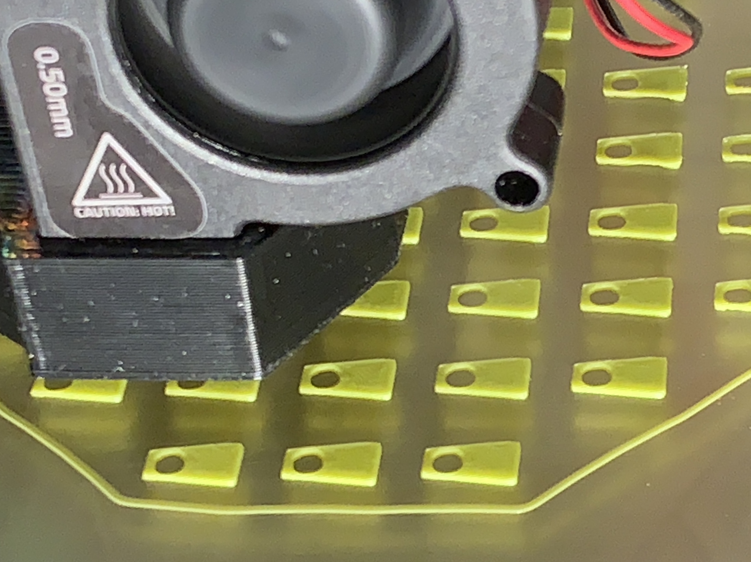

Most of my printing is of small parts… positioned in the center of the build plate.
However, when I print a group of refined parts (50-100) I am reminded that I loose quality in the back right area of the plate. My mini 2 has had this problem from the start. Something in the leveling? I have removed the plate, cleaned and reassembled with same torque at each of the four corners… Suggestions??
Check the belts. Looks like its an anomaly with the X & Y-axis… Clean the rods, check the belt and attachment points to the bed and x-carriage. Try printing a calibration cube in the affected area and take measurements / post pictures.
