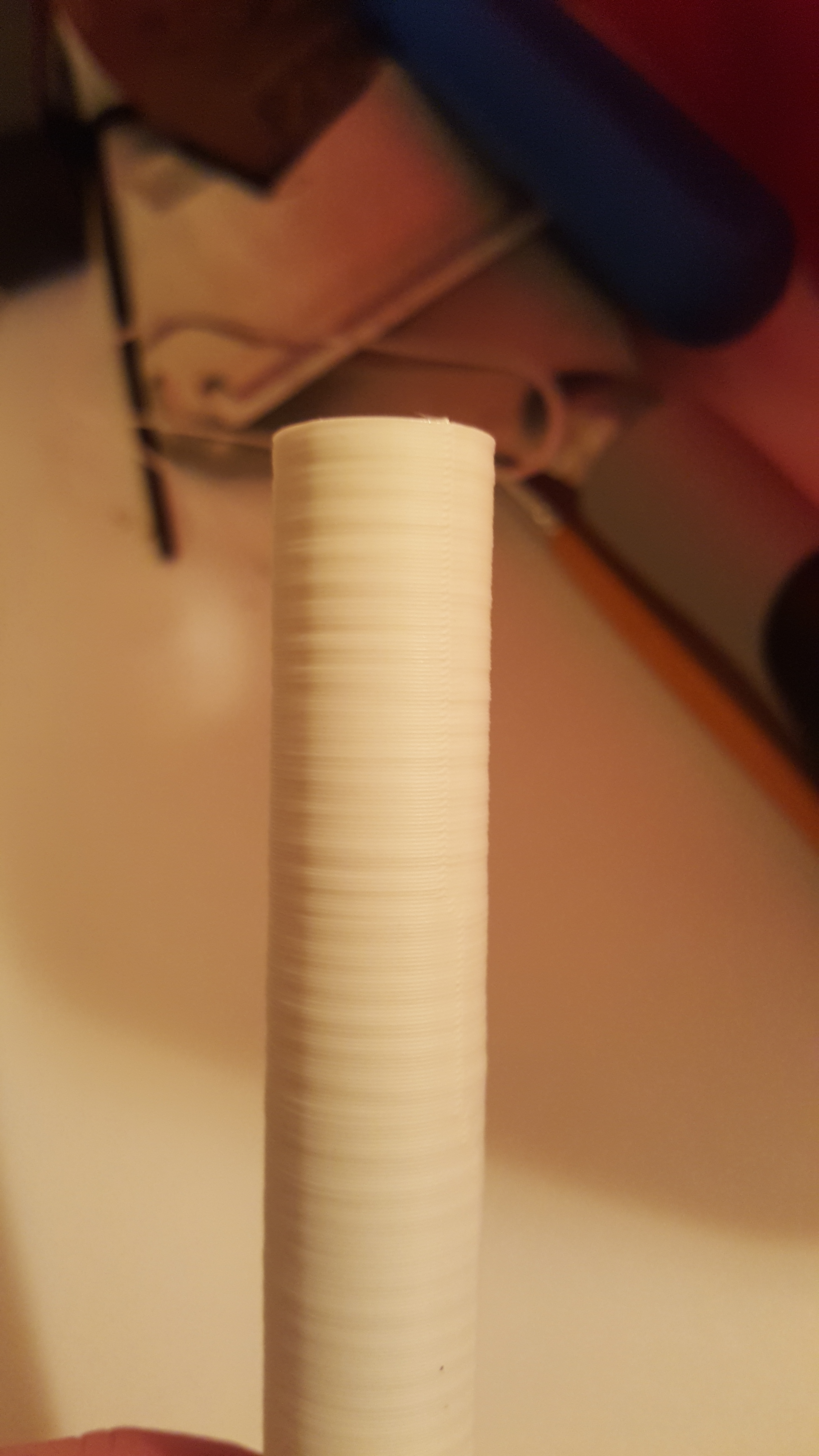

Maybe I got a really good stock Taz 5 regarding wobble. But recently I’ve notice not as smooth of surfaces and some rippling on my prints. It’s significantly worse than months ago.
My problem is, is that nothing is obviously wrong so I’m not 100 percent center on what to trouble shoot.
I plan to eventually upgrade to piercets open rail builds. But in the mean time it would be nice to get print quality back to its original state. Rather than banging my head against the wall I thought I’d ask the community.
(I should note that there does seem to be higher than usual play in the back Y axis bushings. Could this be the cause?)

While good information, this has nothing to do with Z-Wobble. Start by checking the aforementioned 8 screws. Check for play in the x carriage also. The wobble you are seeing is from the z-nut moving, not binding.

There is definitely a little play on the X carriage (it’s always been there). But what is the solution to this?

I’m now noticing a non uniform… Humming? Vibration? Coming from the right right side of the printed (Z rod?) when moving the nozzle in the Z direction. The mainly a occurs in the height range between 90 and 180.
I then attempted to do what David.h suggested and it didn’t help. A few more test prints and things are getting worse.
Looks like it’s only happening in the X axis and it’s always drifts to the right side. What causes this?
I think you initially were seeing wear on the Z Nuts that was allowing the X wobble to increase giving the banding you were seeing. After your work on the Z axis I am not sure what you are seeing now on the X axis.
