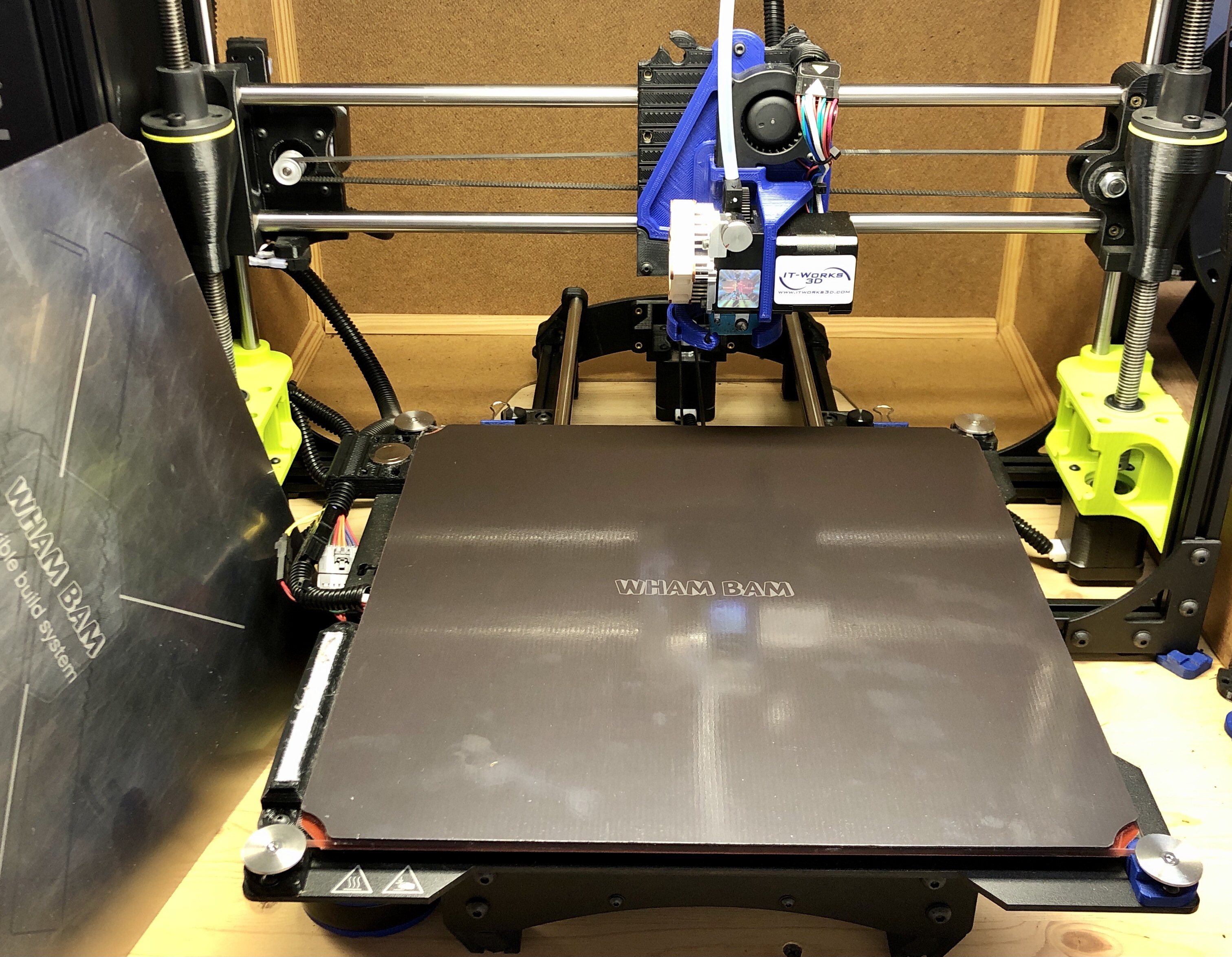

I have this on my TAZ6.
@TigerMike What other parts did you need to replace on your TAZ 6 to get this Wham Bam system to work?
Hi there,
I didn’t have to replace anything. All I did was remove the worn original PEI sheet from the glass bed. I then attached the adhesive backed magnetic bed onto the glass. The kit from Wham Bam included the magnetic bed, two steel flex sheets and two adhesive backed PEX sheets. A plus using the PEX surface is that I do not have to use a glue stick when printing PETG.
The only downside to this is that fact that my Z-offset is now approx +0.5 mm. I have not done anything to reconfigure the height of the initial switch, the corner washers and the nozzle wiping pad due to the raised height of the Wham Bam system. I’m extremely happy with my setup.
Here’s a pic of the magnetic bed and the flex steel sheet on its side to the left.
