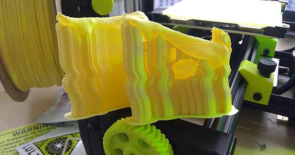

Prints have a waving pattern in them - photo included in link below. Having read a bit online I think this is due to some friction somewhere? I don’t see any obvious blockages or points of friction that could be inhibiting movement. Something must be loose maybe? I have no idea what to look for if there is some screw that needs to be tightened.

Your shifting problem is harder to diagnose on a message board, but the first thing I would do is check that the belt tensions don’t feel really loose, and then, with the printer off, push the bed back and forth and just feel if the amount of resistance is inconsistent. However much resistance it has, it should be close to the same through the whole travel distance. Do the same with the X axis - slide the tool head left and right and feel that the drag feels the same all the way back and forth. If not, try to inspect the printer to see what is happening when it suddenly gets tighter.
It sound like you might have already done this though. So next thing I’d check is that the tiny set screws in the pulleys on each motor are actually tight. You need, I think, a 1.3mm hex screwdriver to do that. If the pulleys slip on the motor shaft a bit, that can cause layer shifting.

I had a skipping problem on my Sidekick, and it took a while to realize that a cable in the back was hanging down and was being caught on the frame. A simple string around it and tied to the upper frame, lifting it up, solved the problem. Probably not your issue, but worth checking.
