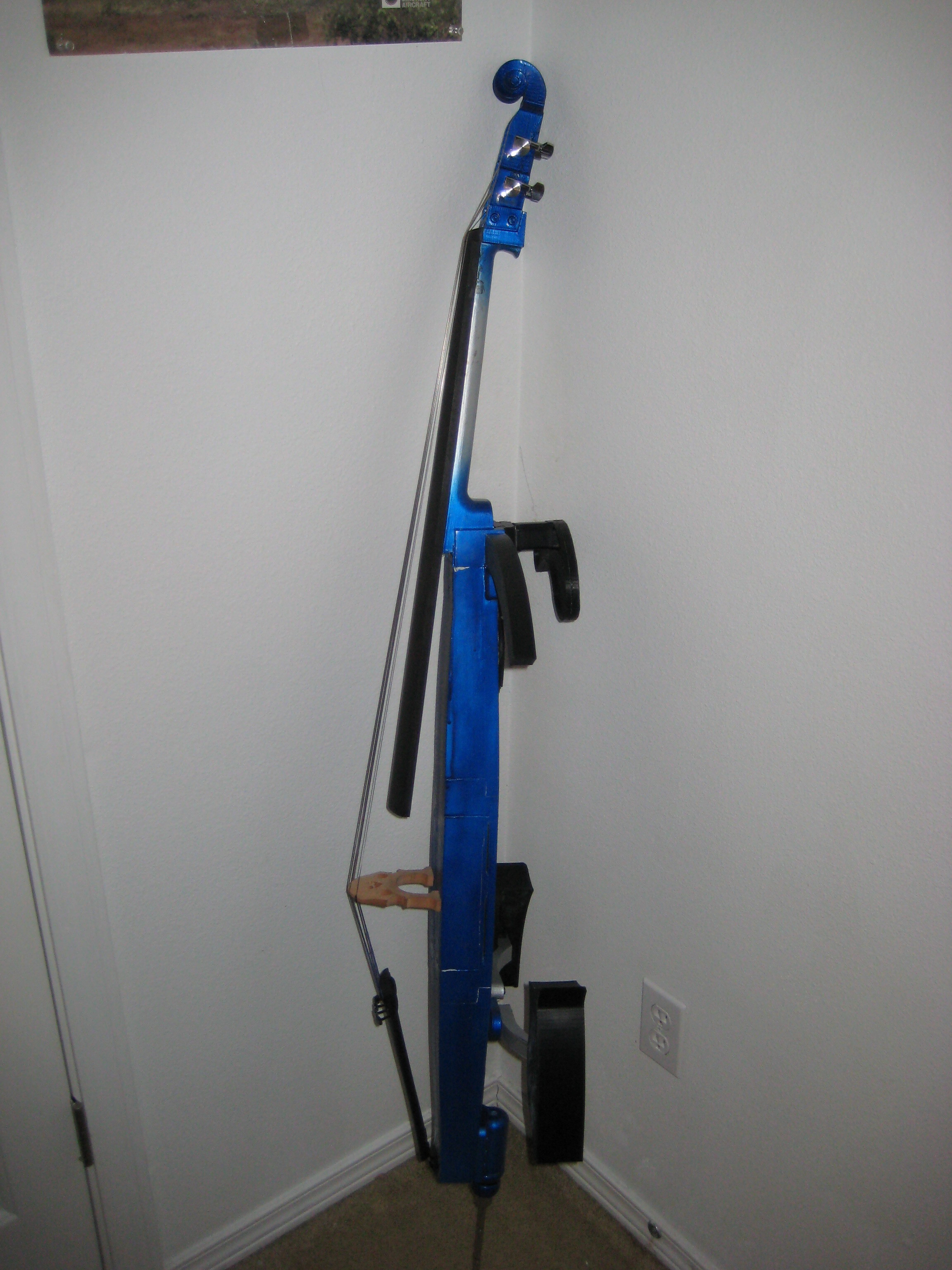

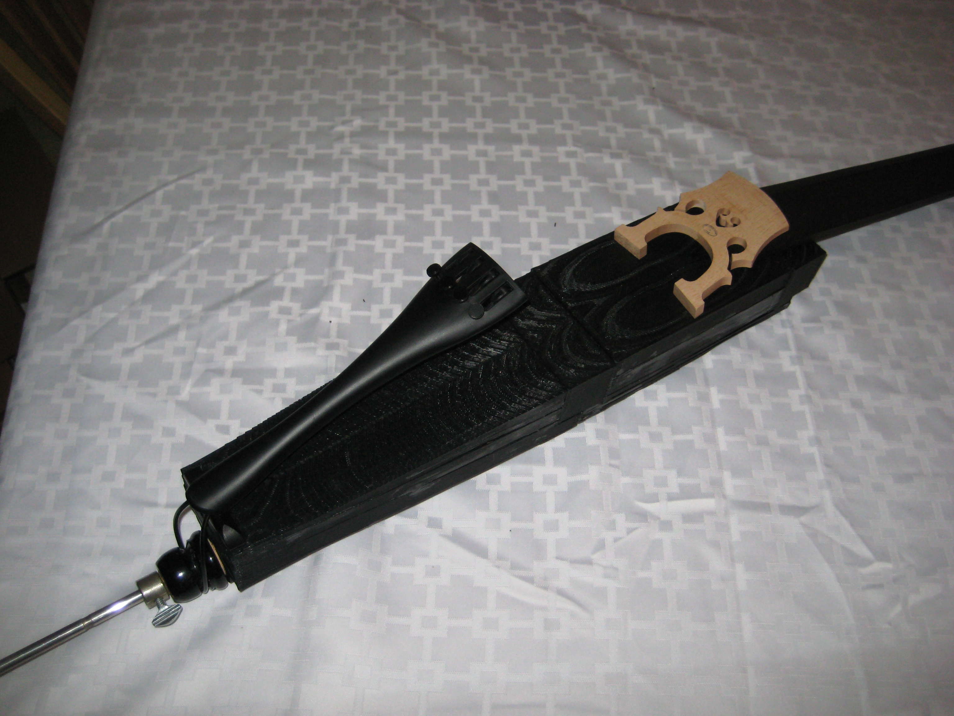

Well, the Cello did make it back from the cello bridge shop, but you will note that it does not yet have strings. After keeping my cello for 9 days, I finally got a phone call letting me know that the angle of cello neck 1.0 was off, and that they wouldn’t be able to fit the bridge until I make a new one. Also the fingerboard I have right now is apperently warped (new one on the way). So, I went and got it, brought it home, made neck 2.0 and pegbox 7.9 (don’t ask) to fit on the new neck, and designed the arm rest and the leg resty things. Aaand, thats about the time I ran out of fillament. One of my suppliers is being a jerk, but more is on the way. So i decided to start fixing the sides (please note, all the layer issues visible on the sides were user inflicted. I upgraded my computer and it was having a power supply issue that caused it to randomly crash reboot without bluescreens at random 9 hour-ish intervals, so it kept dying in the middle of really long prints that I was sending from my usually reiable computer. (by the way, if anyone needs to know how to stop random reboots on a socket 2011-v3 Asus motherboard, I know the trick now.)
Anyways, here are the pictures of the unit as it currently stands. You can also see the powered preamp and piezo pickup. Once I get a few more things taken care of on the back in preparation for paint, the wires will be installed and an insert containing a power switch will go in the back hole there. I also still have yet to design and print the “back positiony cello rest thingy” piece. Once the new fingerboard arrives, but before I paint it, this assembly will go back to the luthier, get actual strings, and then finally be ready for painting.
Color coats of the paint are on. there will be a bit more touchup required in a couple areas, but they should be minor. The main issue was the string I was using to support it while I painted. This will get several layers of gloss clear over the next several days. The new non warped fingerboard also arrived, but is not pictured. Assuming it meets standards, the whole thing might get strings and electricals and be playable starting next week + however many days it takes to fit the stuff. The current plan is for the arm rest and leg spacer thingies to get painted gloss black, as well as the as yet to exist back spacer piece that will be partially visible next to the arm section.
Looks like it’s coming along nicely!

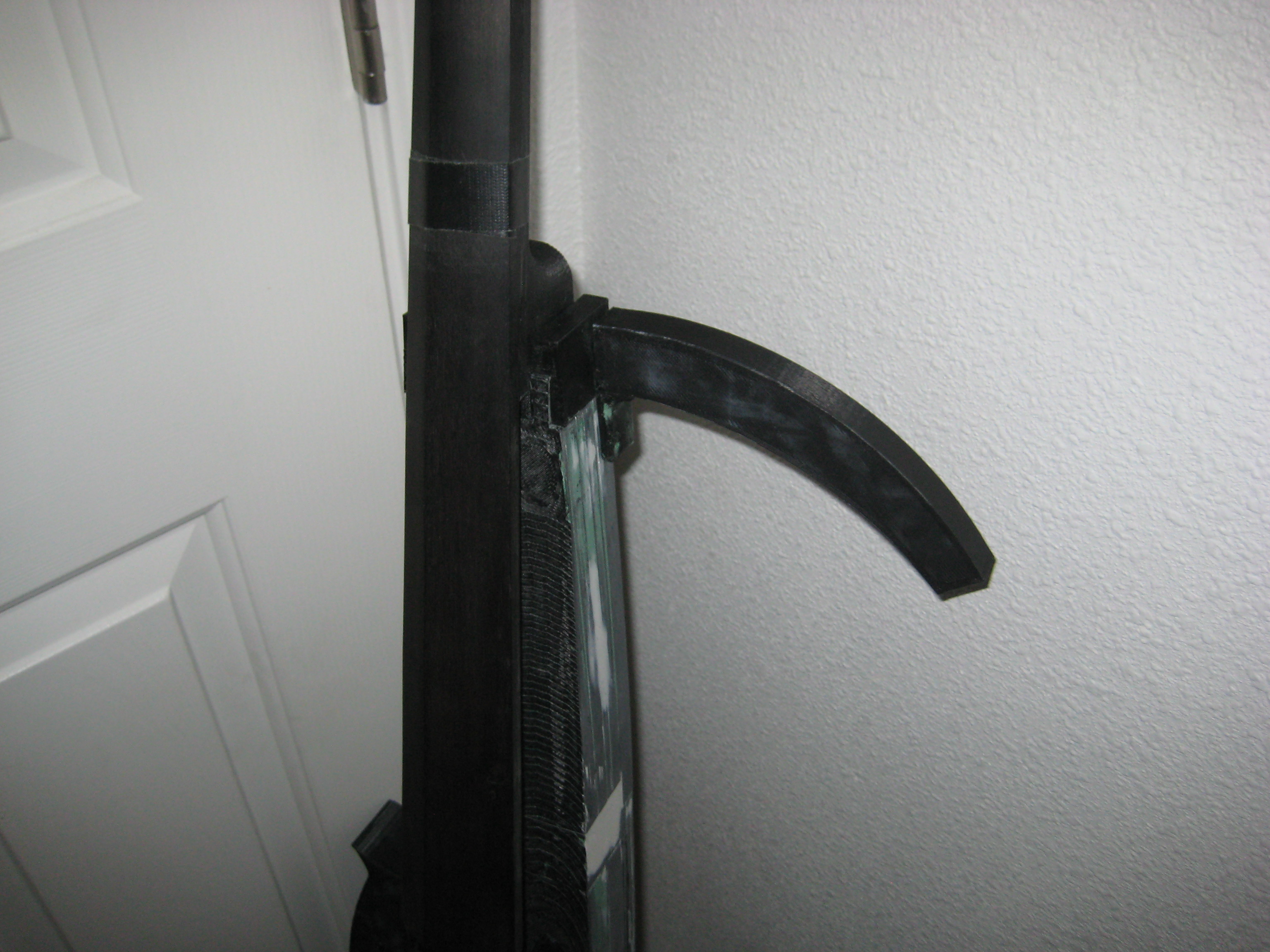

Finished up the last of the 3d files and printed pieces. It’s heading back to hopefully actually get strings this time. I really don’t want to print a 3rd neck.
In the pictures you can see the new back spacer thing, the other leg spacer, and the faceplate for the preamp. I’ll have to have the whole thing apart one last time to get the wires to the right places, but it’s basically structurally done at this point.
Strings attached! I do need to adjust the neck slightly to take the angle out of it, but it is holding it’s tune, didn’t fold in half and actually sounds halfway decent even without the electronics running. It’s definitely loud enough to practice with if nothing else. I’ll pull it apart one last time this weekend to run the pickup and fix the neck issue, but aside from that and a bit of paint touchup / black piece painting, it’s essentially done. Video will be posted when I either figure out what the hell is wrong with my web camera or get a new one on the way…

I printed this with ABS, which for such a large section, isn’t a great idea, though the printer had no problems with it. The sections I had to glue together were all caused by computer related issues with my new motherboard (now thankfully resolved) . I think it would actually probably work better as a PLA or Ngen project, since the final cello had a bit of excess flex in the neck. The center section should theoretically sound better with a less flexible plastic like PLA, though it still seems to sound fine as it is. It still holds tune and sounds great though, and once the strings were on the flex went away, so it was not a major issue.
The paint is the Duplicolor metalcast system http://duplicolor.com/product/metalcast-anodized-automotive-paint The neck silver is the bare base metal coat, the blue metalic is that metal coat with the blue chrome top coat. You can find the paint locally in automotive supply stores usually. I know Auto Zone carries it for sure, but most of the others that stock paint should also have it. I put down 3 layers of base, and 5 more of the topcoat. It’s rated for use with engine blocks and exhausts, and seems to be binding just fine to the plastic. The minor paint flaws you see in the picture are actually joint locations that had model putty in them, and the tension force when the strings were attached caused some of the hardened putty to flake out, which resulted in a few spots I need to touch up. I need to take the entire thing apart one last time to finish the internal wiring anyways, I’ll respray those sections then. So far aside from those areas, the paint has held up quite nicely and I have no concerns about it being an issue later on. ABS plastic is basically model plastic, and acetone based paints bond really well to it. There is actually a heavy wear section on the leg spacers where the “keep from folding up notch” is that is painted, and is a bearing surface. It’s held up fine to a few hundred folds and unfolds even without the top clear coat.
One thing to be aware of with the metalcast paints, the top coat goes on extremely thin. it’s possible to go from perfect paint job to major run in about 2 nanoseconds. Lots of thin, light coats is the way to go with it. I can’t stress enough how runny this stuff is. Also, when you are done with the top coat it will look to dark and solid. Over the next several days it will cure and turn more translucent. That process takes a full 7 days. I plan on spraying a top coat of clear over the blue and silver parts when I am done.
I had the electrical pickup attached externally this weekend. It sounds great so far. I’ll take video of it as soon as the new web camera gets here since I apperently melted the microphone of the old one somehow.
