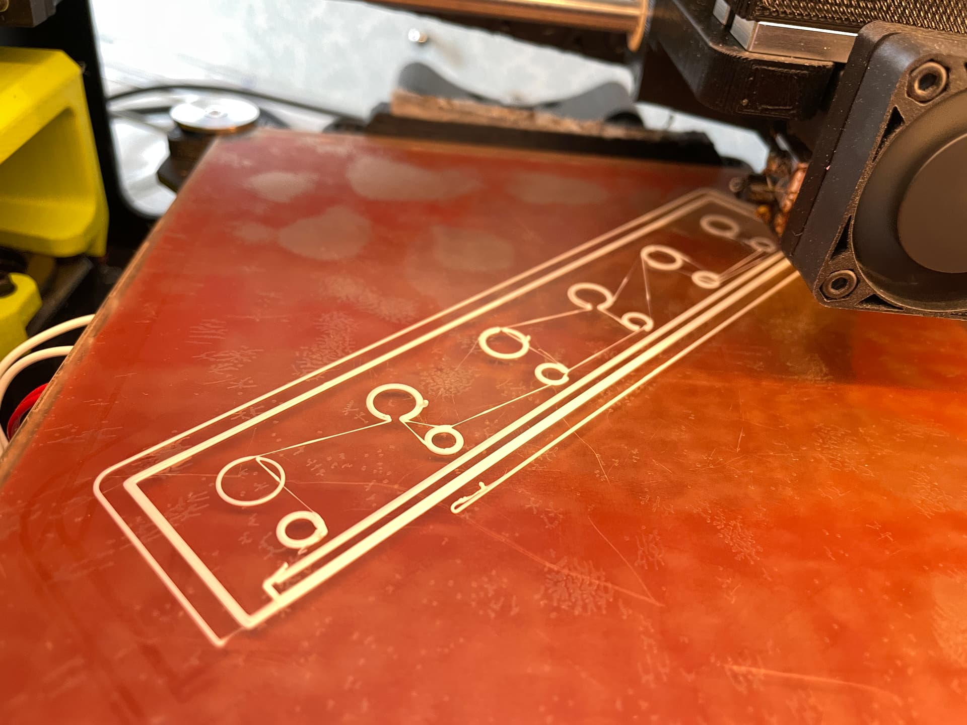

My prints are showing stringing between modelled holes on the first layer. Looks like this.
It happens similarly on later layers too.

If you haven’t done it already, go to Settings, Configure setting visibility..., and set Check all. One the right side of the window next to Print Setup click on Custom. You can now either scroll down to the Materials section or type “retract” in the Search... box.
Here is an introduction to understanding and adjusting these settings. Another link and a video. These links may use Ultimaker Cura instead of CuraLE but they apply to both.
CuraLE 3.6.36 is the latest version available at this time. It is possible to use Ultimaker Cura instead by configuring a custom printer with the Mini’s settings including the start and end gcode and you will have to change some of the variables (between the curly braces, {}). You can search this forum for more details.

I see it (for my Custom material) that retraction is set to 6.5mm
