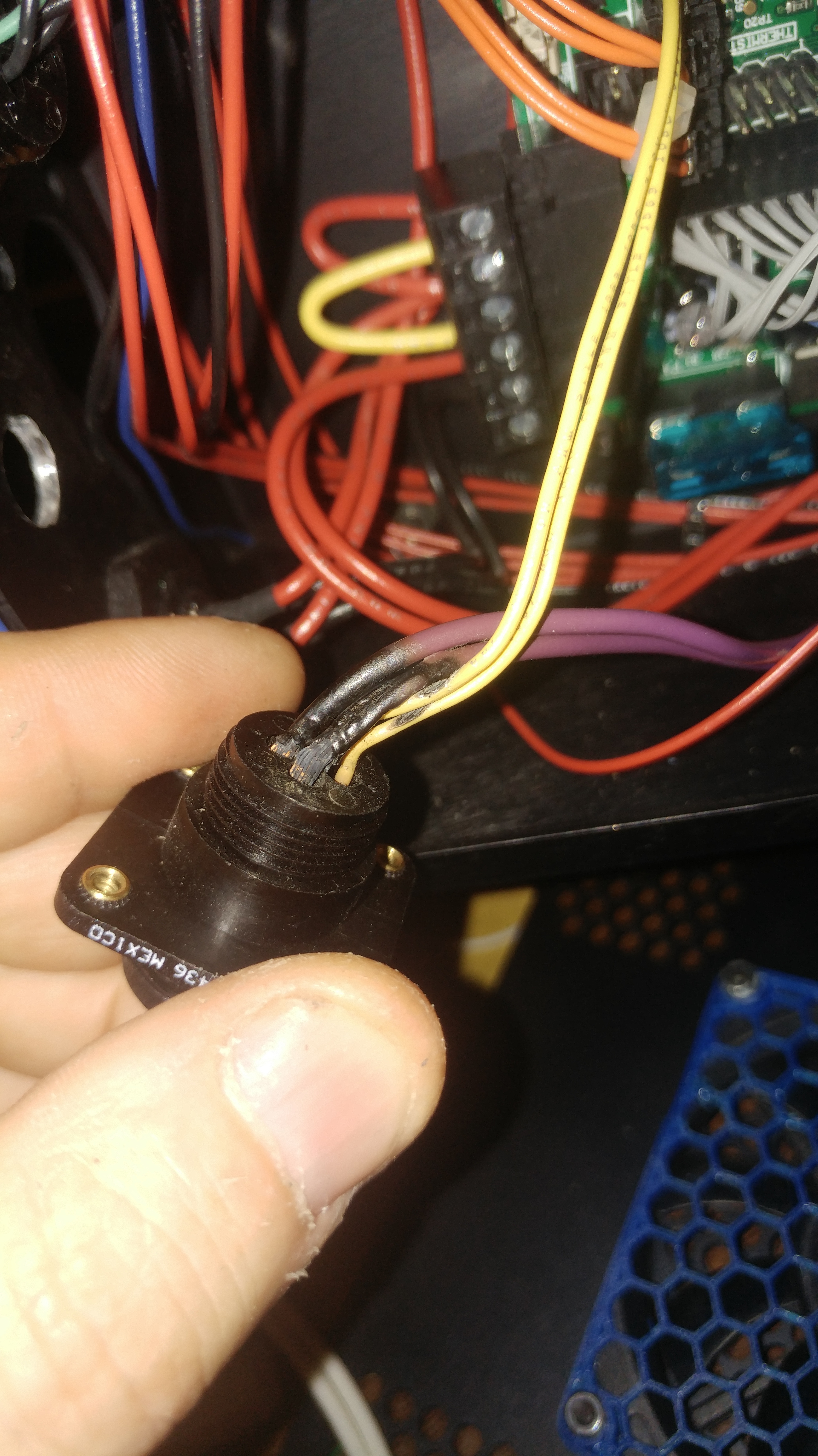

Taz 5 bed not heating connector issue
I read through all the other threads on this topic and did not find what I have. The connection points in the box to the quick connect cord have burned up. Please see the pictures. What is the name? Model of this connector?
There are a number of posts on this burnt-up bed wiring in the control box. They also have the cables for purchase in their on-line store. Depending on how badly the pins on the external cable got overheated you may need to replace them.
https://www.lulzbot.com/store/parts/taz-45-control-box-bed-harness
Digikey WM2900-ND - internal four pin housing.
Digikey A31997TR-ND - female pins
Digikey A31998TR-ND - male pins
Digikey A1357-ND - Cable connector body.
Lol super old post but I just had the same exact issue on my taz 5.
I would suggest removing the connector entirely and installing the passthrough harness.
Already ordered and sent. Can’t wait I don’t like my printer idel for over 3 hrs.
UM! I just replaced the bed heater wires and took out the 13 AMP connector pins that have 15 amps going through them at start up with wires passing through the connector housing! Like 4-5 years ago.
