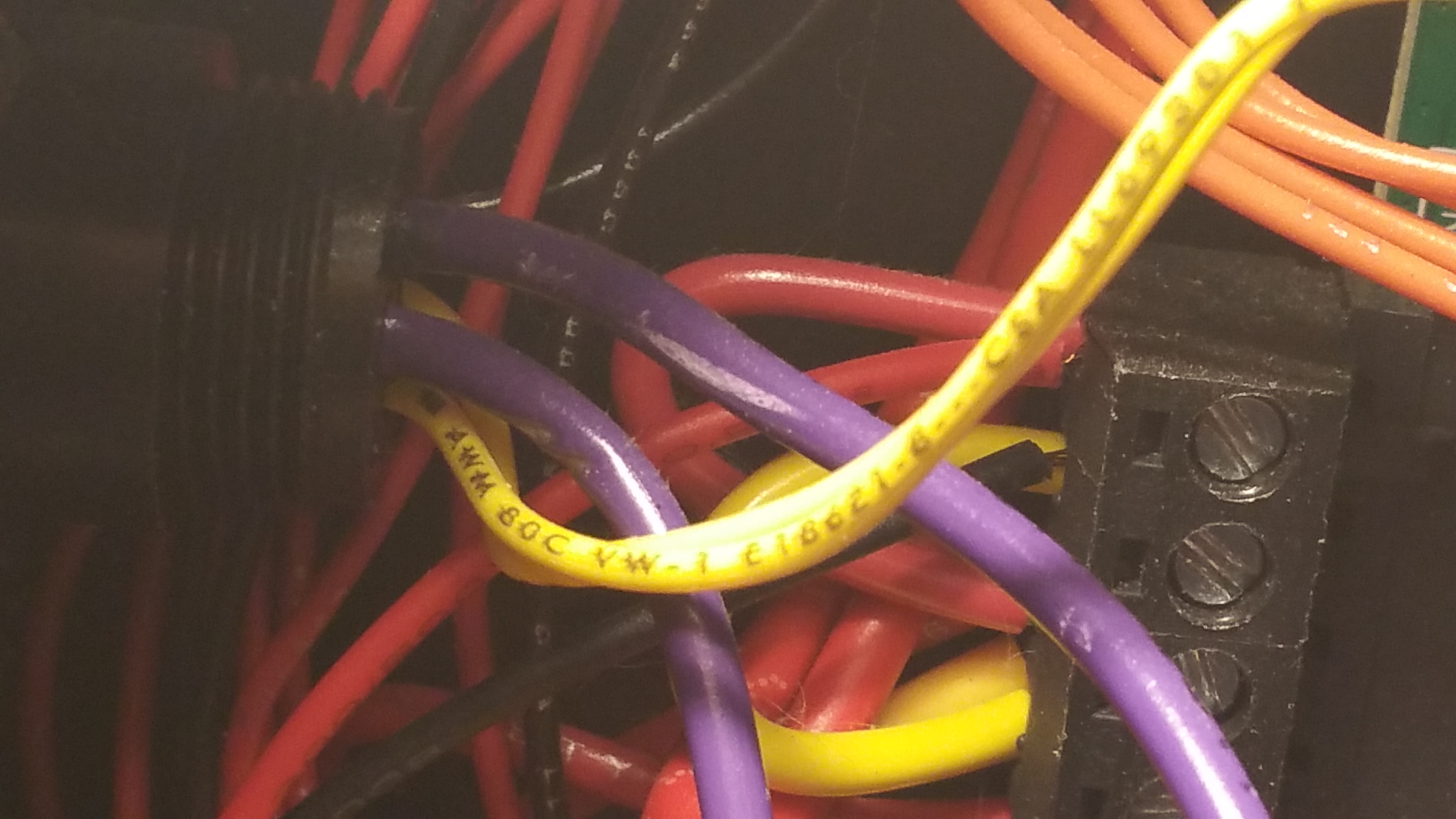

Can you see burned wires inside the box ? the two purple wires…
“… magic smoke”

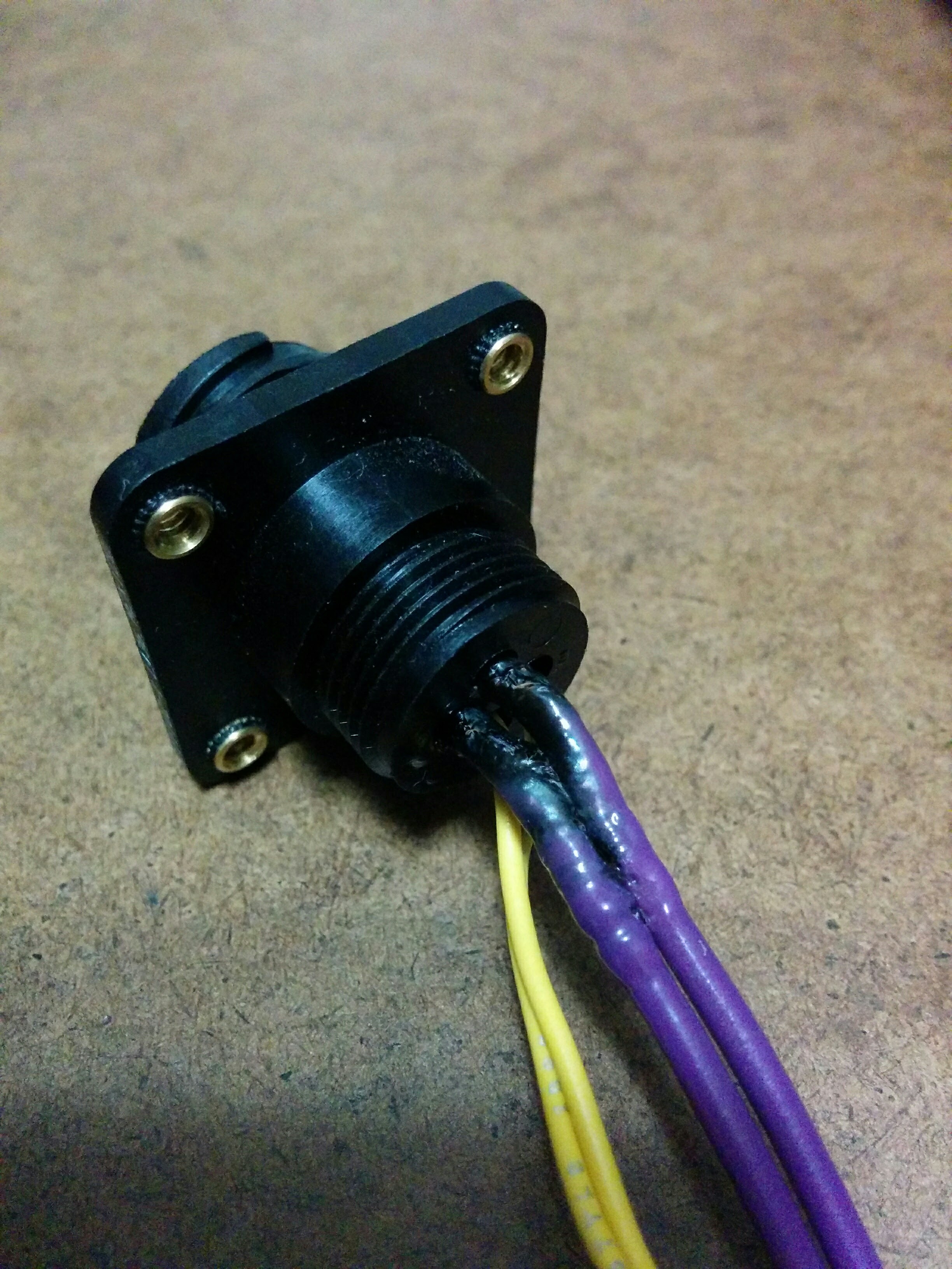

Finally pulled the TAZ apart to find the culprit. Looks like Pin 2 on the Heated Bed Connector has been getting mighty hot. The purple wire on both sides was fused it’s neighbors and the socket on both sides is melted. I’ve had several beds on this printer and never had an issue until this latest one. I wonder if the heater core is drawing too much current. If my math is correct 100% duty cycle should pull 25 amps. I believe my settings should be pulling right at 20 amps.

Looks like I joined the TAZ 5 magic smoke club today. I want to thank everyone for the helpful information in this, and related, threads. It looks like I’ll be rebuilding the heated bed harness and external cables I think I’ll use thicker wire and solder the pins. I’d actually like to get a six pin connector and split the heater current over more pins. I guess I’ll have to research connectors now.

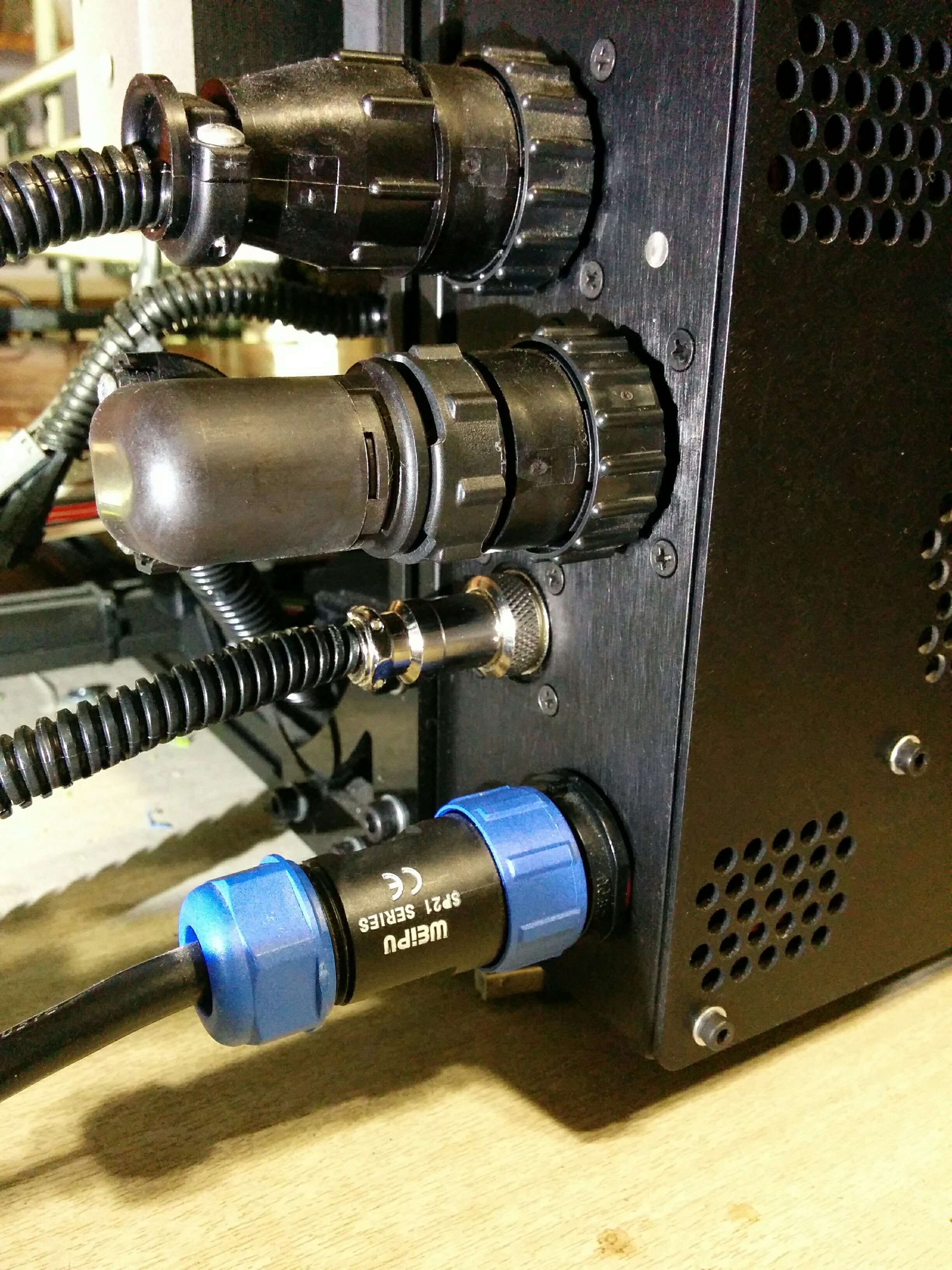

Well, I got replacement connectors from Digikey and repaired my existing cables. I did have to replace the connector shells, as the scorched pins had fused themselves with the plastic and could not be removed. I added solder to all the crimped connections for the heater power while I was at it. With the repaired cable I can feel a slight warmth near the connector when the heater is powered.
I also bought some of the connectors that piercet mentioned and built a new cable and harness using that. I printed an adapter for the panel mount connector, and I reused the threaded, brass inserts from the old, burned out connector. With the new cable I don’t notice (by hand) any warming of the connector when the heater is powered.
Here are a few pictures.
Edit: I’ve added the FreeCAD and STL files for the adapter plate.
TAZ5_Heated_Bed_Cable_Adapter_Plate.stl (43.4 KB)
TAZ5_Heated_Bed_Cable_Adapter_Plate.fcstd (13.2 KB)
