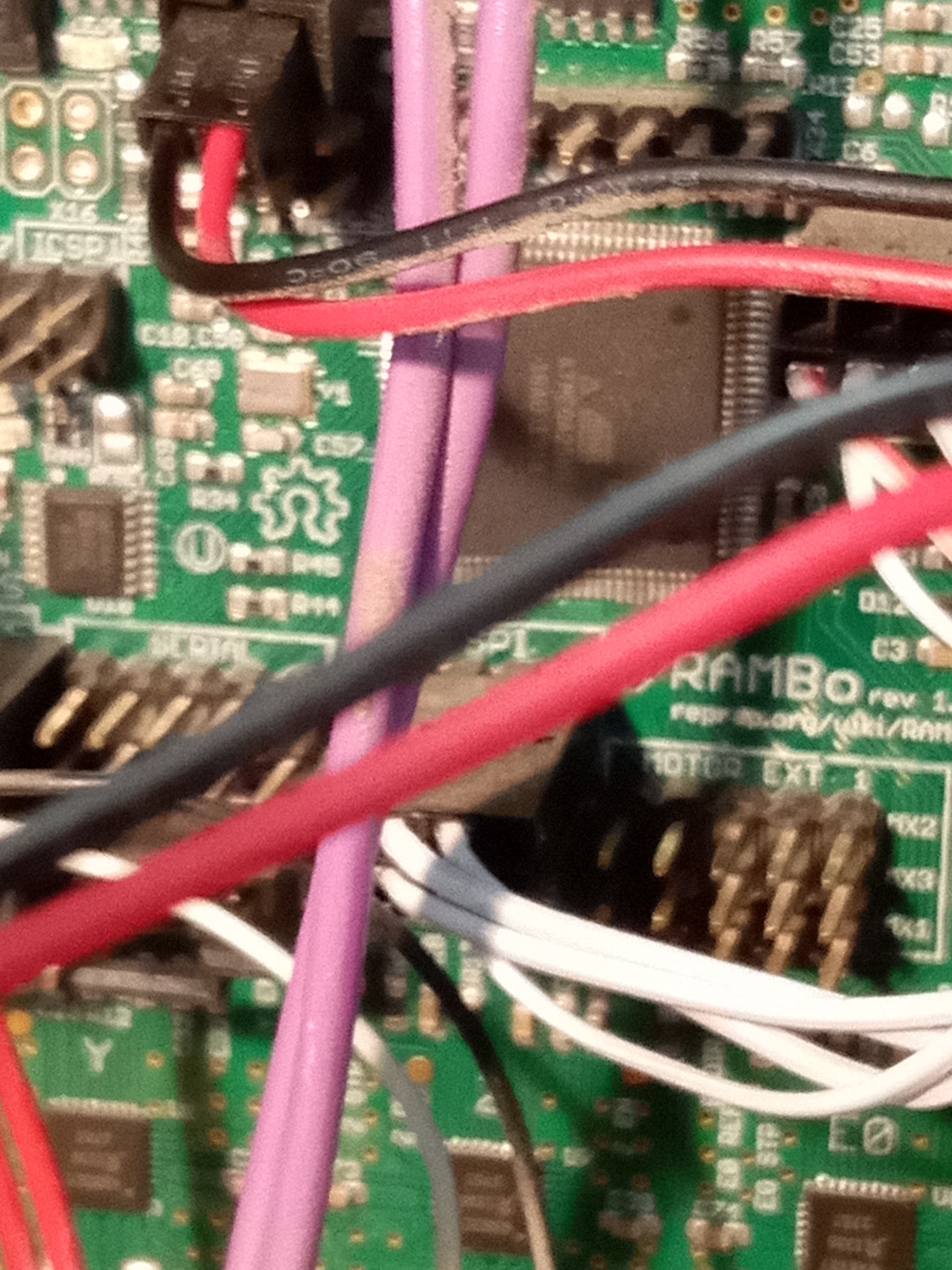

If you can provide some detailed pictures of the board, wiring to it, the endstops, and anything else wired in, we may be able to help further, but there may be some changes that will be difficult to revert.

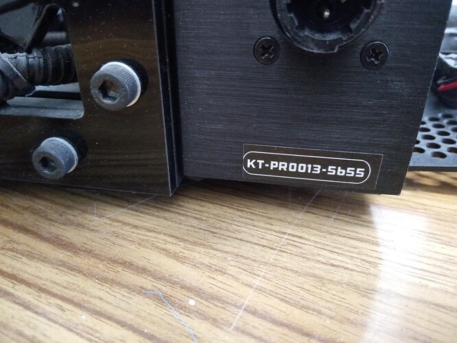

The number on the outside of the control box is KT PR0013-5655 and the board inside it ia a “RAMBO” board with the number 10006542 .

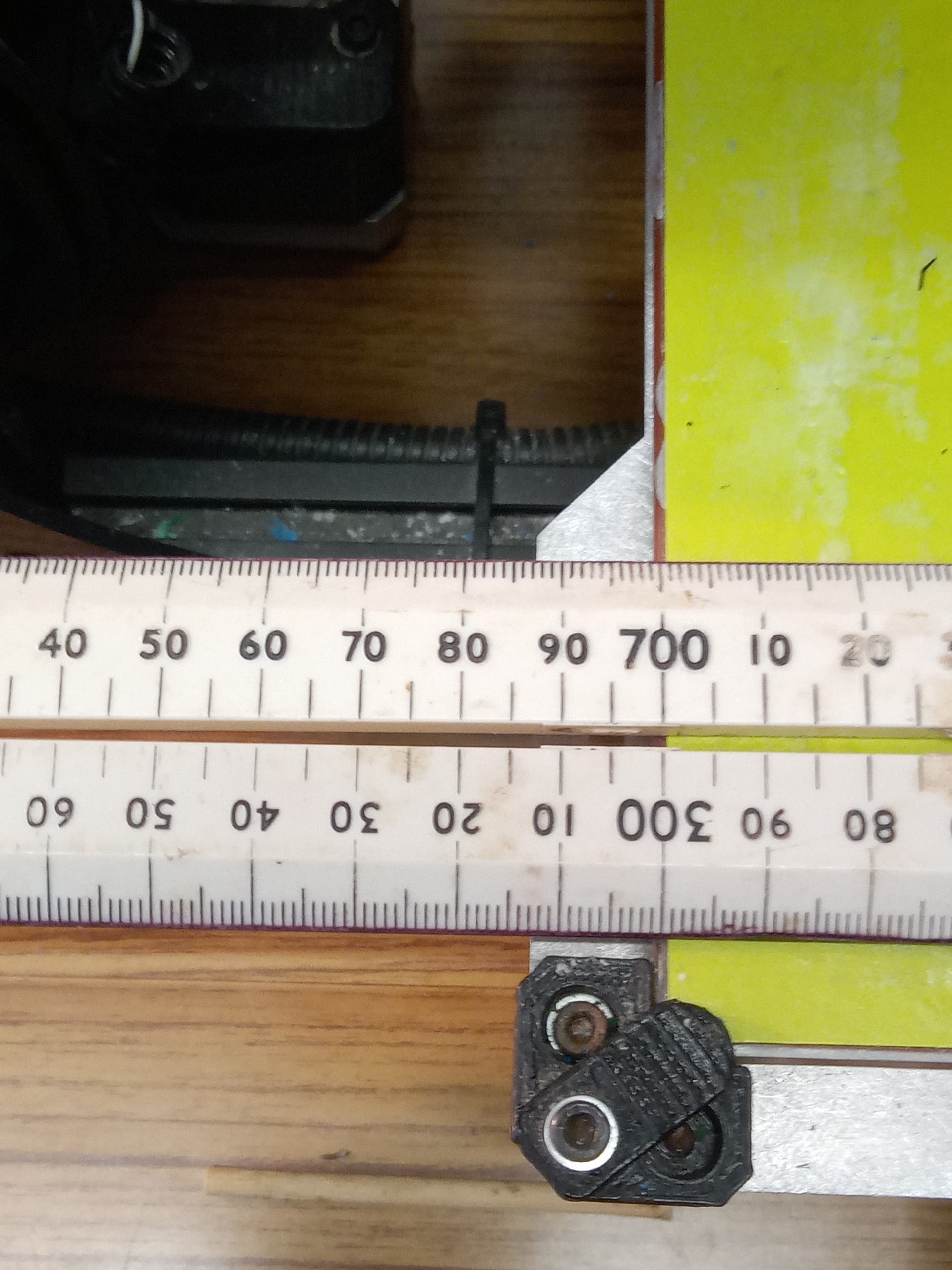

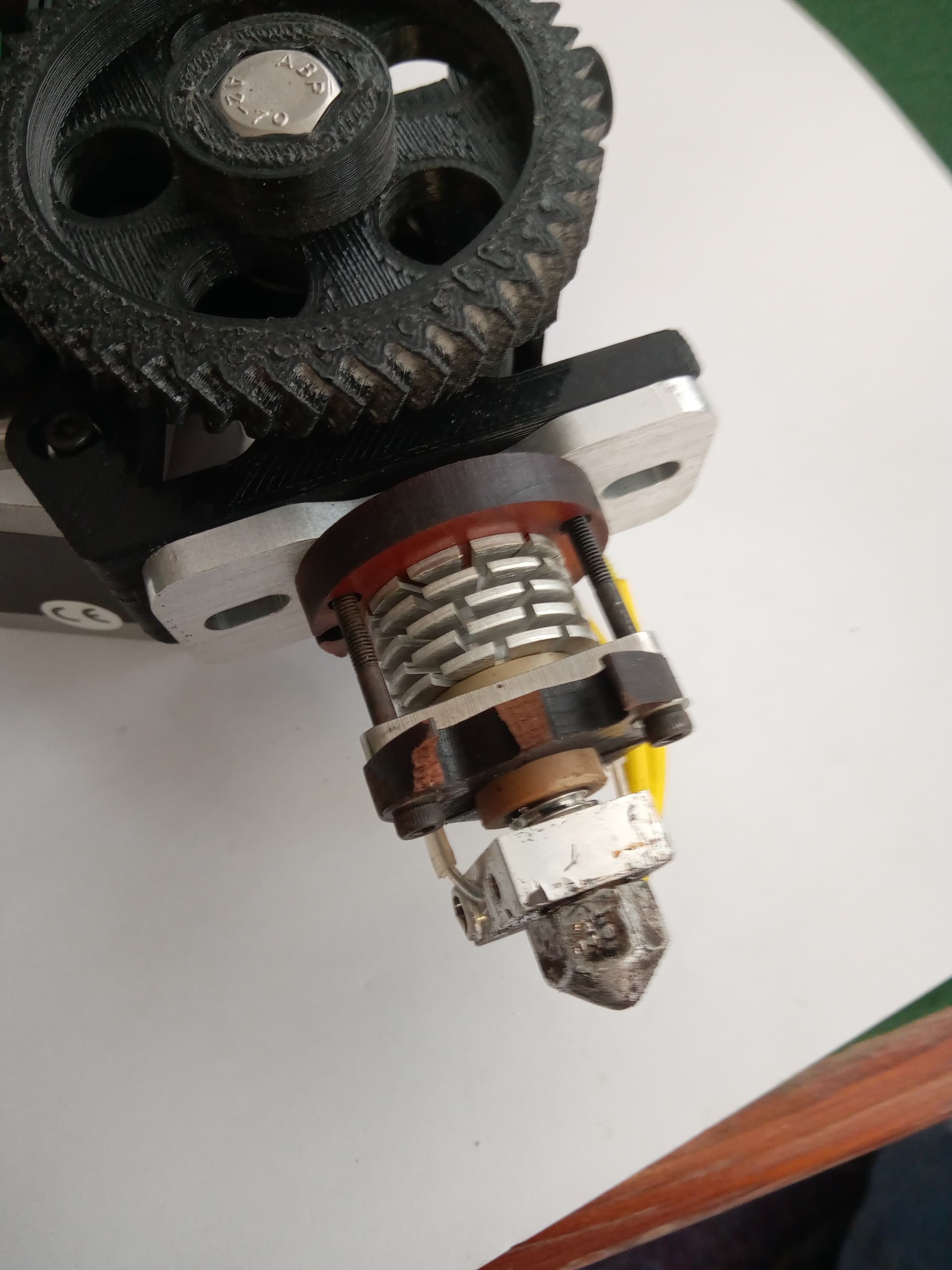

So, it’s definitely not a mini, which explains a lot of the confusion.
What are your goals with this machine? The current parts would let you print OK in ABS (and possibly nylon) with an enclosure, but PLA and most other materials are out of the question.
If I were to try and make it useable again, here’s what I’d do:
Replace the extremely outdated hot end. That budaschnozzle hasn’t been considered great for almost a decade. It’ll do ABS and some other materials that don’t need cooling, but you can’t really get replacements parts for it. A Biqu H2 extruder works good on these. If you’re on a tight budget, the BIQU H2 V2.0 Extruder For B1 BX Ender 3/ 3 V2/5/6 CR6/10 – Biqu Equipment is under $70 and I use one on my machine, but the BIQU X E3D H2 V2S Revo Extruder 3d printing parts for Ender 3 Voron V0 Voron2.4 BIQU 3d printers – Biqu Equipment is a good upgrade for the price.
