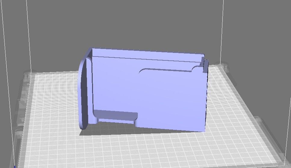

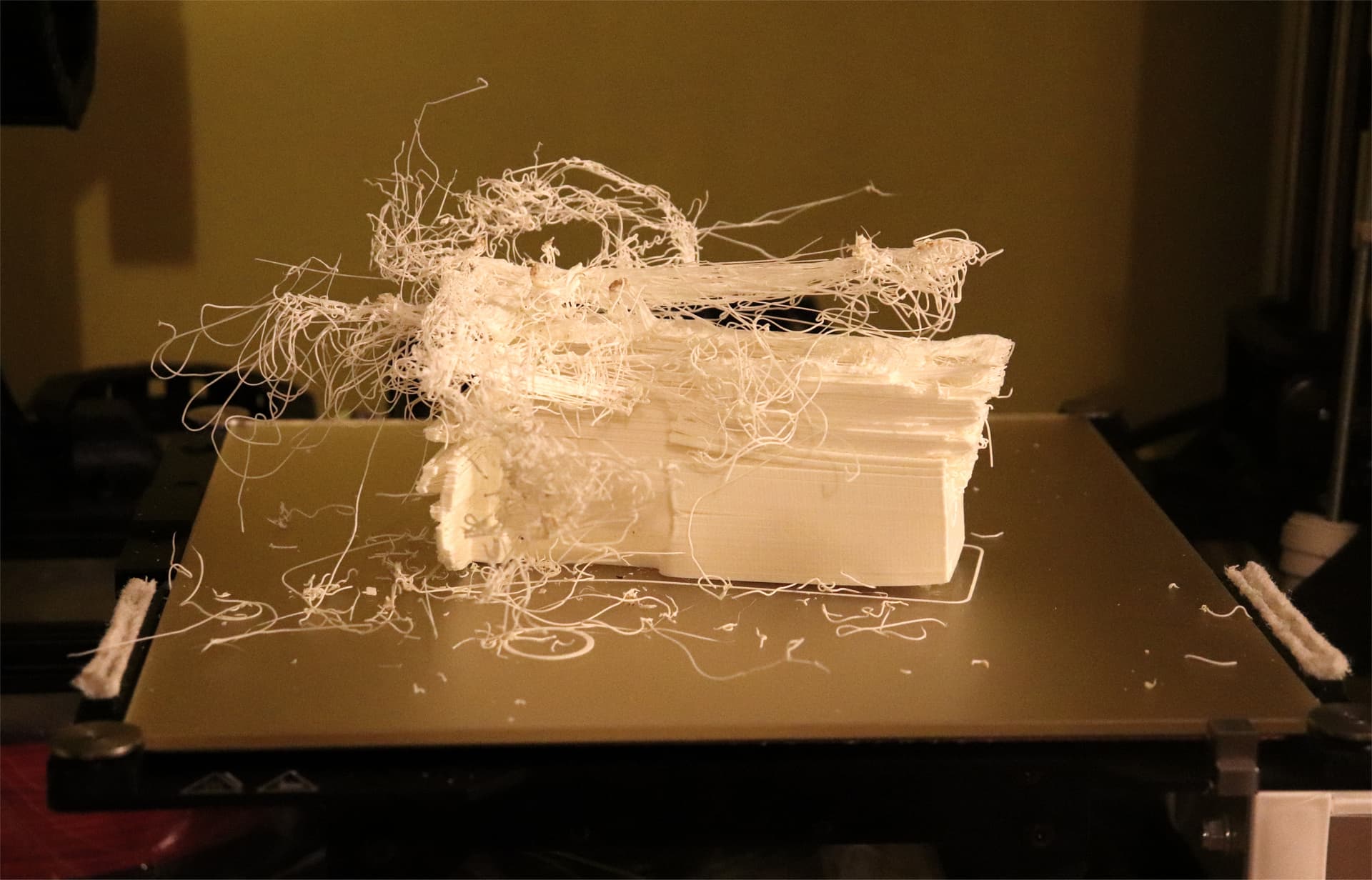

This is an enclosure box for a Ring doorbell camera:

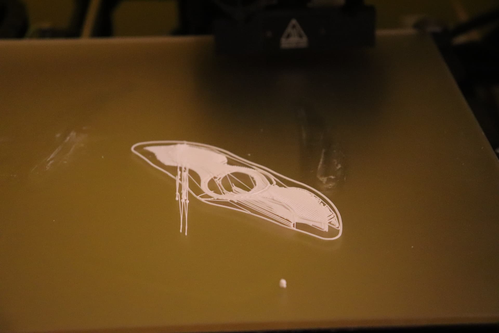

This is how it printed:

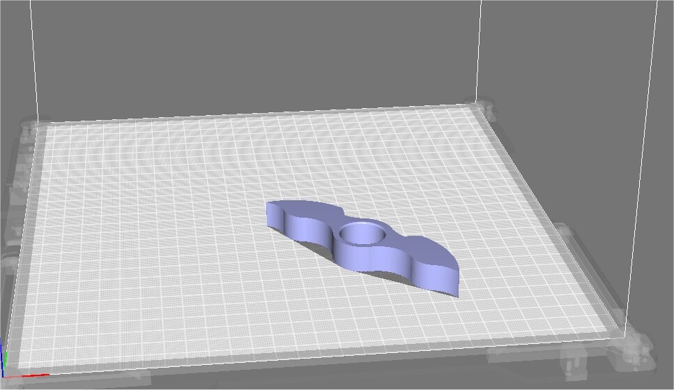

So as a test I tried going smaller again with this page holder:

After getting no real print problems with the Taz 6 in five years of use should I expect the Pro to do the same or is it something I am doing wrong rather than a fault with the printer?

It looks like the Z offset may simply be too high. There’s nothing on the first layer from that second print that looks right.
I also had issues with the grub screw for the x axis motor not being tightened down, which essentially was causing it to have about .8mm worth of motor rotation before any movement happened whenever it changed directions. Check that.
