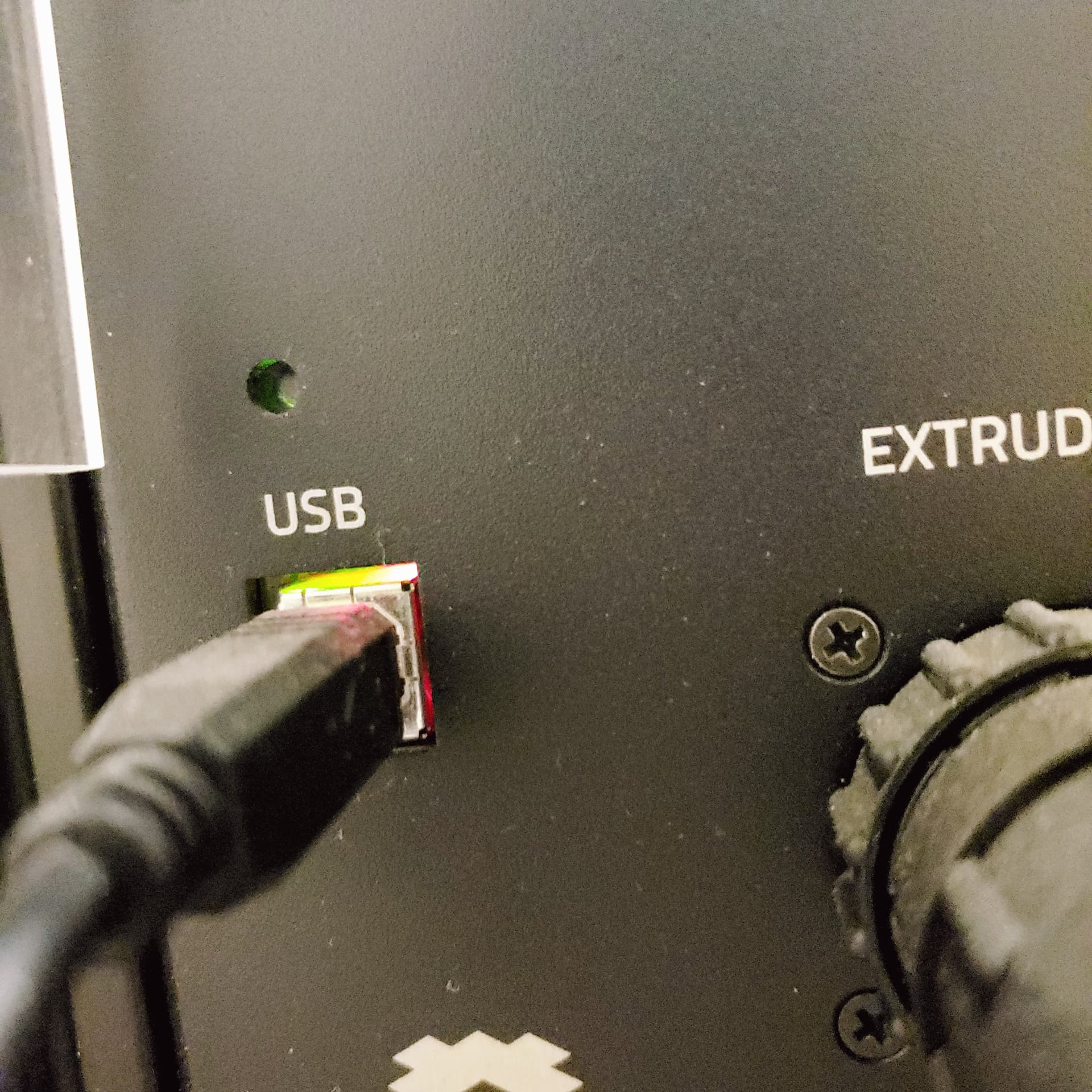

My computer for whatever reason does not recognize the Rambo board. The USB lights on TAZ works. I’m not sure why it won’t communicate.

It’s me again, does your 3D printer led work? Even when idle if it is connect via the USB to USB?
I didn’t even know there was an LED!
There appears to be light around the USB plug. Not sure what that circle above the lettering is supposed to be.
I took the side cover off and the hole above the USB connector is for the reset switch.
There are two small LEDs on the board (mine is a 1.3L) labled LED1 and LED7. LED7 (Power?) is solid green when the power is on. LED1 (Status?) is off.

Thank you mine does that too. Everything else regarding the board works LCD, motors, heater controls, etc. Not sure what has happened. If I was going to get another board would you upgrade to a 32bit Archim?
