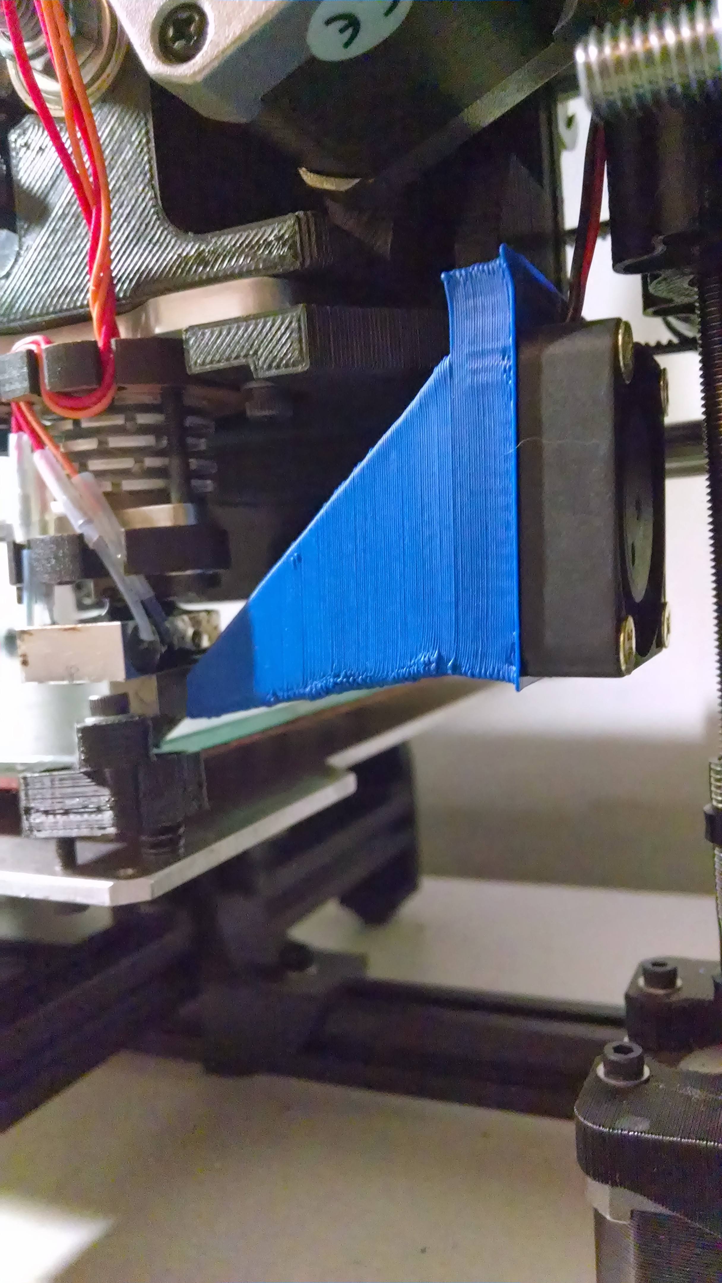

I attached the fan mount using two 16mm long m3 bolts. Had to drill out the holes to get them properly sized. Chicken and egg - I had to print the fan mount without a fan mount, it came out pretty messy. ![]()
The fan mount’s author mentions using heat set nuts to attach the fan to the mount; I found 6-3/4 wood screws worked fine too.
The fan’s labeled side faced into the duct. Or another way to be sure you dont get it backwards; you want to be driving the screws/bolts into the side where there’s a circular indentation around the bolt hole. Or, just remember which way the air blew when you had it turned on.
The duct’s shape is such that, when running, much of the air will rebound out against the fan; this might make you wonder if you got it backwards at first, as it did me.

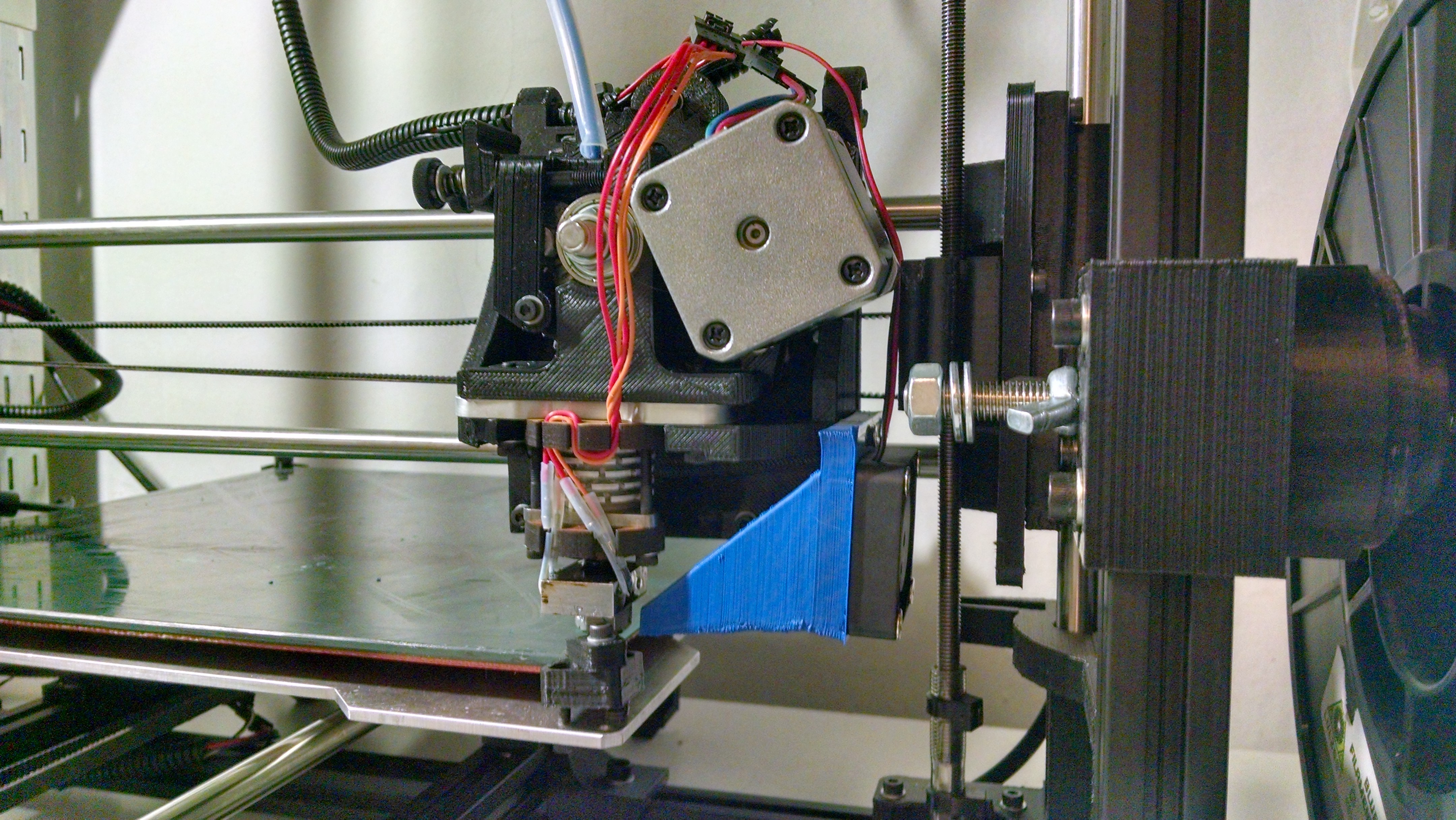

The result looks like this:
You can see here that this fan/mount combo does not intersect either the bed clamps or the Z-axis threaded bolt at all. My compliments to the designer.

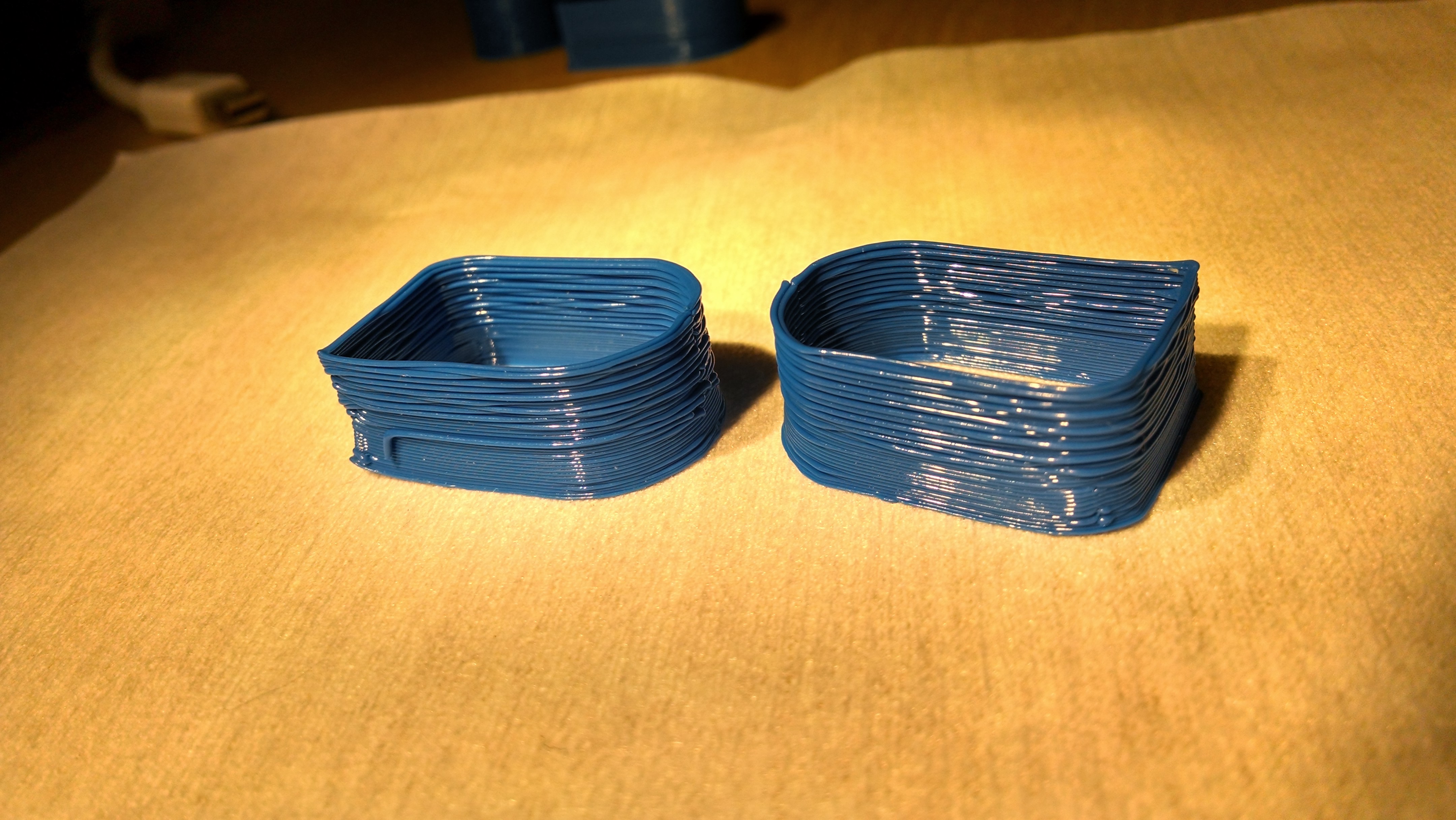

Results pretty much speak for themselves. For this STL (taken from here: Calibration · slic3r/Slic3r Wiki · GitHub):
_40x10.STL (85.1 KB)
Before:

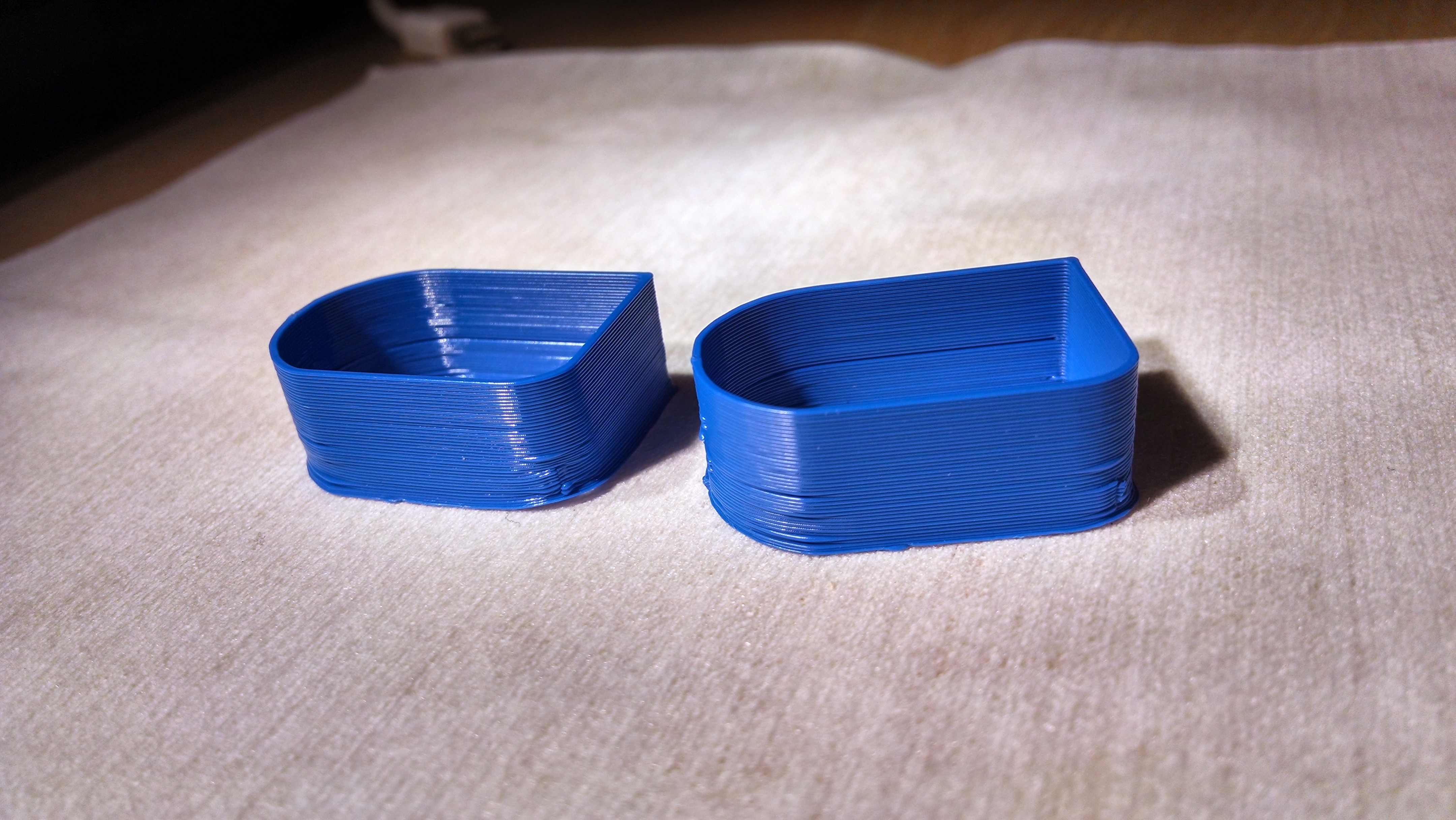

After:
That’s an immediate, dramatic improvement in PLA output quality right out of the gate. I haven’t even started tuning settings on it yet.
