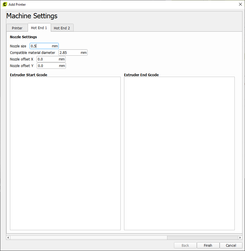

In the machine settings, there’s places for gcode for both extruders, they should be empty. That’s a likely spot for a change that’s screwing things up to have been put.
I’m doing a quick comparison of the default 3.6.38 and what you posted, and it looks like they have hard-coded values for soften and wipe temps, probably as part of being the “testing” version instead of release. It’s hard coded for PLA temps for the nozzle wipes and probing. If you do a clean install, you’ll want to change those back to the {temperature} variables from your old code so they change with the material you’re using.
If you still have issues, you can wipe all settings and customizations:
Close cura, open the file browser, and type in %appdata% into the address bar.
There will be a cura-lulzbot folder in there, just rename to cura-lulzbot-old. If you get an error that stuff is open, restart windows and go back to the folder and rename it.
Next time you start up Cura LE, it’ll be fresh.
On the Taz Pro, just go into config and restore factory settings. You’ll need to recalibrate your z offset, and re-do your esteps, but other than that it should be fine to at least start printing again.

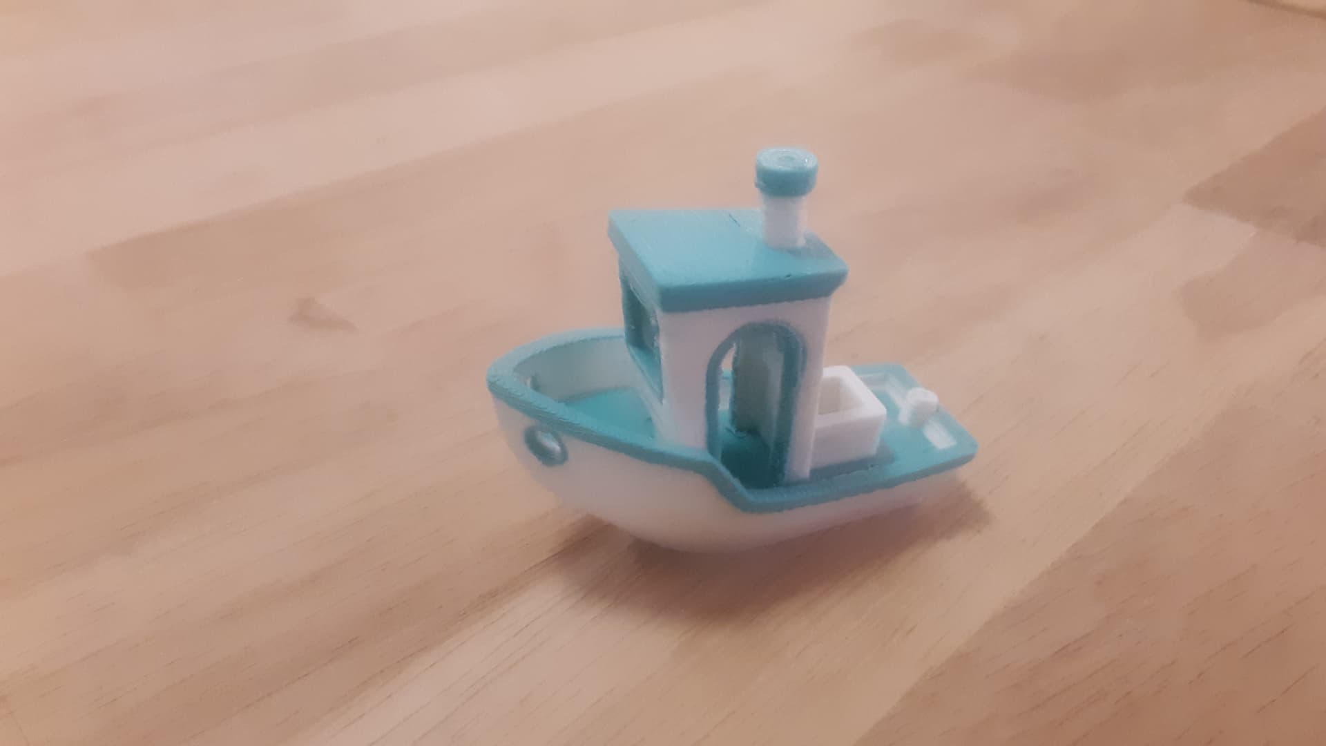

Great! Now you gotta pay the toll with a picture of a multicolored Benchy.

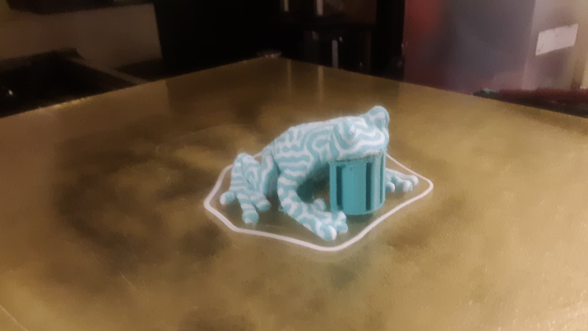

I got you :wink:
Also just for fun
