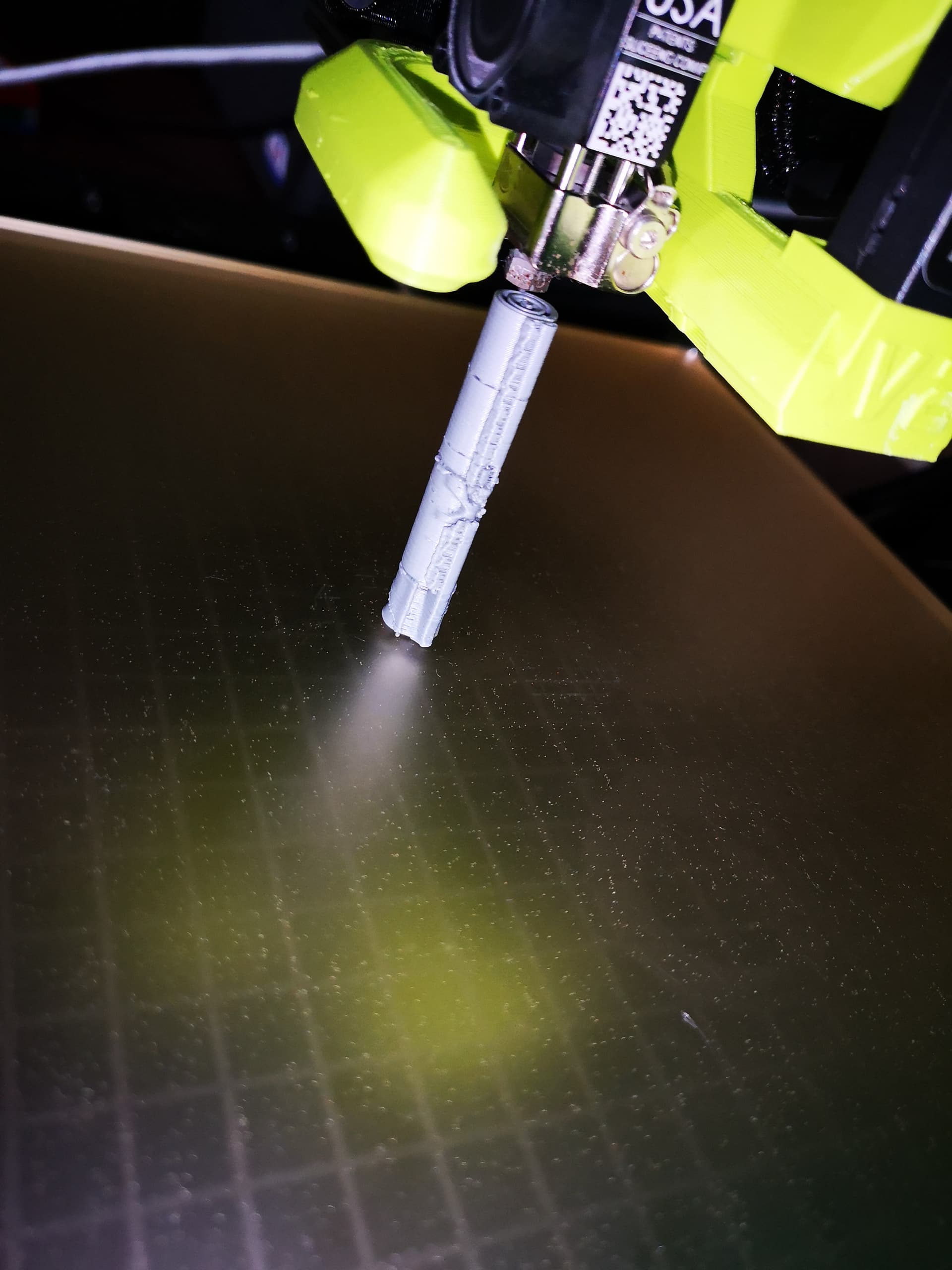

I’ve been playing with my new Taz Pro S for a few days, and today it started pausing mid-print for a bit, then continuing, then pausing, etc. It has done a few good prints, and I first noticed this after updating firmware, but it does it randomly.
I’m using Lulzbot Cura on an iMac, and the computer is very busy when it happens, so I’m wondering if it’s a computer issue, though I’m new enough to the printer that I don’t know if that’s even possible.
There are no errors or messages other than “printing” before, during, or after the pause.
Any ideas?
See pictures showing layer that it kept pausing every couple mm. It should have been uniform, with layers above & below.

The first thing I would do is to verify that “computer is very busy” is the culprit. This means stop everything else and just print the object. Instead of that, you could copy the gcode to the SD card and print from that (assuming that the TAZ Pro S still has an SD card).
I have my TAZ 6 connected to a Raspberry Pi running OctoPrint. For less than $100 (even as little as $40) you can provide a host for your printer that will give consistent results. Use your iMac for designing, modeling, slicing, etc. and let the RPi patiently feed the gcode to your printer.
The print jobs have far more g-code instructions than the printer can hold in the memory buffer. The printer usually only has a handful of move instructions buffered.
If the computer is busy, the printer can drain the buffer and pause waiting for the computer to send more instructions.
As @b-morgan mentions, you can use OctoPi (a Raspberry Pi running OctoPrint). A Raspberry Pi 2W is easily powerful enough to run it and these cost about $25 … but you also need a microSD card (about $10), and a power supply (about $8 … basically a microUSB power supply that can provide 5v with at least 2.5 amps). You can either buy or 3D print your own case for it.
The hardest challenge with OctoPi … is finding a store with a Raspberry Pi in stock. Go to RaspberryPi.com and they list resellers.

Even if it stalls for a fraction of a second you end up with little “zits” on the walls of your part … everywhere the printer paused even for the tiniest fraction of a second.
