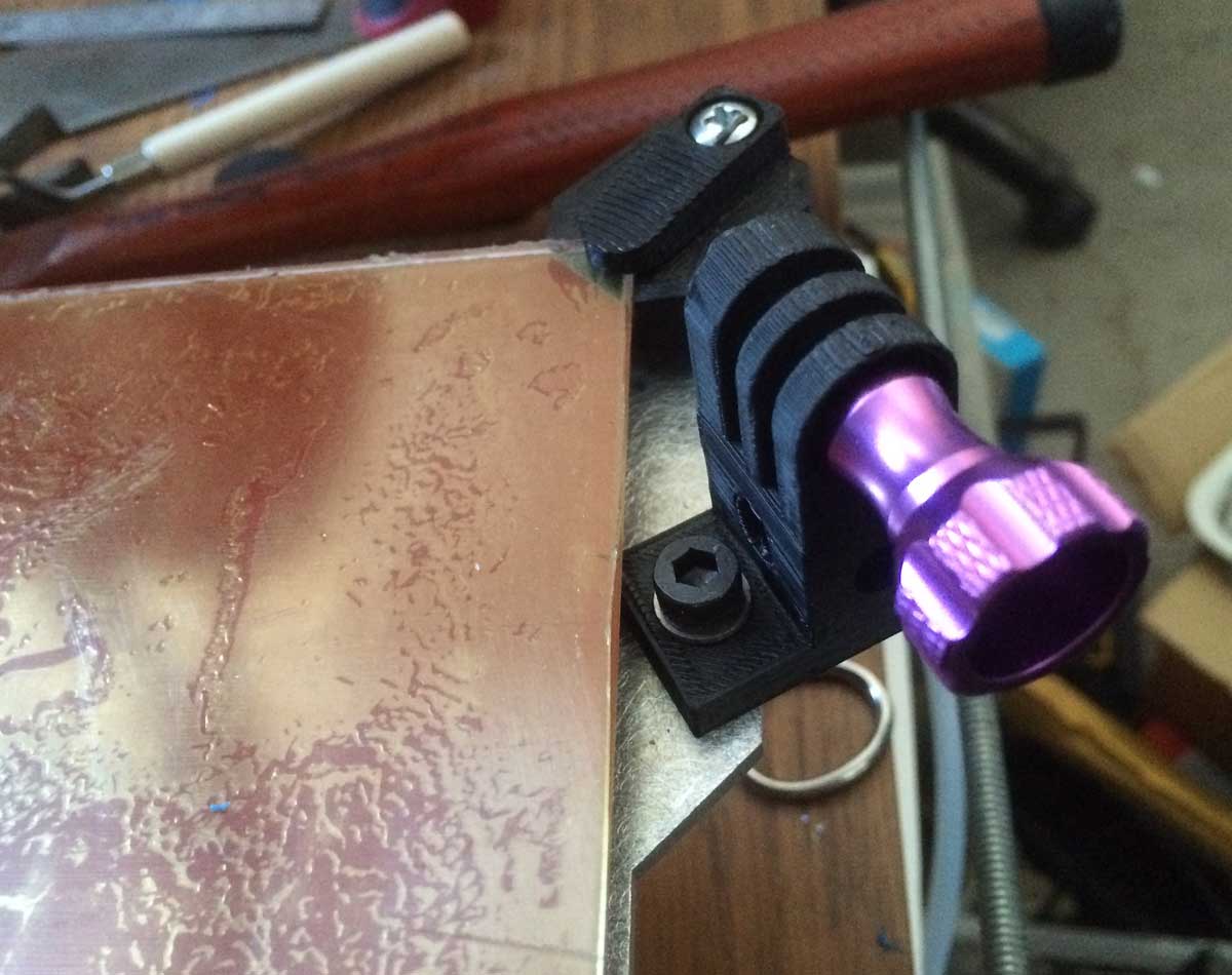

I use one of my GoPro cameras attached near the corner of my bed.
This is attached on the front of the bed? Does it get in the way of the print head? Also is there a file for the holder?

I attached mine to the front right of the bed, as long as I don’t tilt the camera inwards there is no touching. I never uploaded the file but I will attach it here. You do need to drill a hole in the metal plate Just use my photo as a guide. I often use GoPro extenders to get the camera up a bit higher.
When I want to get a more close up for small parts that print in the middle of the bed I use an extension arm and then as soon as the print head moves toward the center I pause the print and lean the camera in for a closer view, this way I can get closer without the X axis smacking my camera when it homes.
Alum Bed Gopro Mount2.stl (500 KB)
