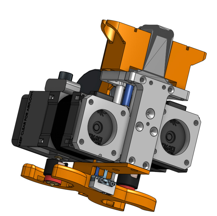

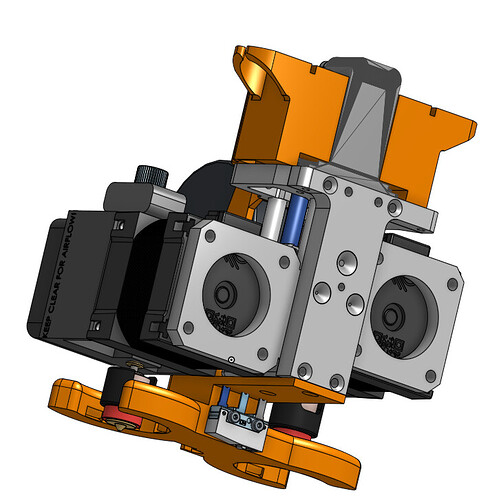

What kind of options are there for a DUAL 1.75mm extruder?
Build one from scratch / Modifying the Pro extruder / Is there an out-of-the-box extruder available?
Now, modifying the pro? That’s where the fun starts. I run dual Hemera Revos on the one I converted at work, but for my personal one, I’m planning on doing a dual orbiter setup. Not sure on hot end yet. The Hemera Revo setup shifts nozzles, so you can’t hit the whole bed with either nozzle, so washer-based leveling isn’t possible (good riddance anyway).
The only parts added were new part cooling ducts, cable holders, and the addition of a microswitch for auto bed leveling. Probably a few M3 bolts/inserts too, but it retains the lift mechanism.
