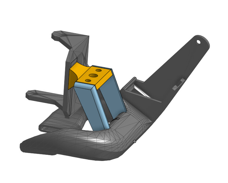

For the Biqu H2, I made this for part cooling and BLTouch mount. The ducts may not hit the right spot with the Revo nozzles though.
