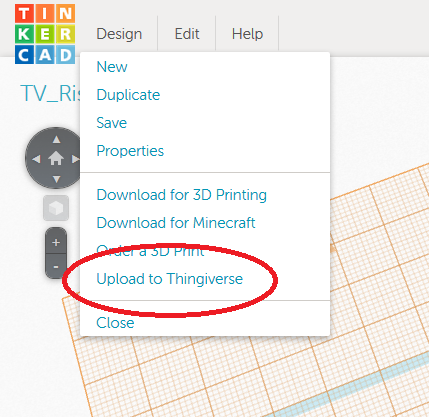

I don’t have a chromebook, but this might help.
Can they upload to thingiverse and then have the teacher download it with a desktop or laptop machine that has permission to access these files?
This will reduce the privacy of their design probably, but it may be a workaround.
Thanks for the quick response. What they are currently doing is just designing in TinkerCad on the Chromebooks, and then logging on to their Tinkercad account on the Laptop that is controlling the LB Mini printer, “Downloading for 3D Printing” from there, then loading the file into Cura. This can be iffy, since the laptop is very old and doesn’t run Tinkercad reliably. When that doesn’t work, they have to get on a third computer that can both run Tinkercad and allows STL files. They save the STL file there, then copy to a thumbdrive (we haven’t figured out how to get Tinkercad to save it directly to a thumb drive - it always want to go to the downloads folder on the computer), then bring the thumb drive to the laptop controlling the Mini.
The upload to Thingiverse may work better. We’ll see if the ancient laptop controlling the Mini can access that more reliably than it can Tinkercad. That would minimize the need for a third computer and resorting to Sneakernet to deliver the files to the printer (The kids looked at me blankly when I first used the term “sneakernet”. Hard for them to imagine a time when all of this stuff wasn’t connected.)
