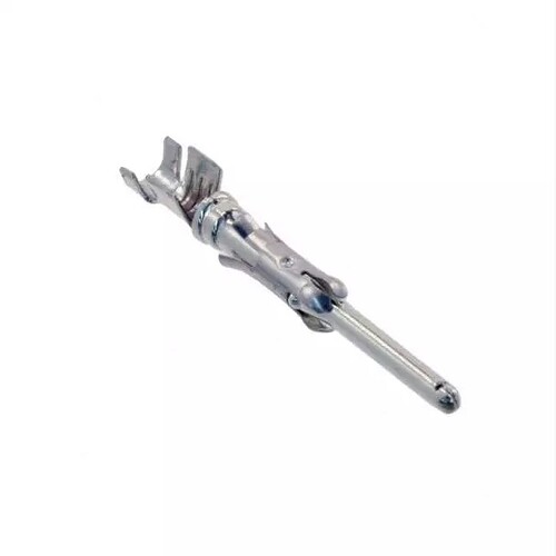

What kind of pins and crimper is needed to create my own connections in the 20 or so molex at the top of the print head on a Mini1?
I have a Mini1 that the hot end is ruined, and I’m looking to replace a lot and fabricate my own blower, etc. - but to tape into the factory wire harness that sites under the plate which is on top of the print head - what kind of pins and crimper tool do I need? I bought some Dupont style (link here) thinking that was right - but apparently, they A) are not long enough and B) do not have the prong on the back that stops it from pulling back out of the Molex. I’ve seen some pictures of Molex SL male pins, but I cannot find a small order for these and also cannot tell the actual dimensions for ordering - seems like even amazon wants you to buy them in 20K bulk or higher…
The ones I’ve pulled out of the existing wire-harness are about 22mm long - and 15 or 16mm to the locking prong on the back from the insertion point/tip.
Anyone guide me in the proper direction for OCD? :slight_smile:
I know I could pull all new cables and create my own harness, maybe use silicon this time, etc - but hopefully I’m just missing what pin/crimper style and it’s easy to obtain and use…

I’m not sure if they actually cover what they crimp with, but for the really fine ones - 22awg or smaller, usually a pair of needle nose pliers is all you need.

The connector is the same across the different Mini 1’s as far as I know. I had to buy the parts online from digikey.com
They are molex micro-fit connectors. We were able to easily find female pins but the male pins, good luck :frowning:
You might want to check out IT-Works 3D. They offer a variety of connector pins.
