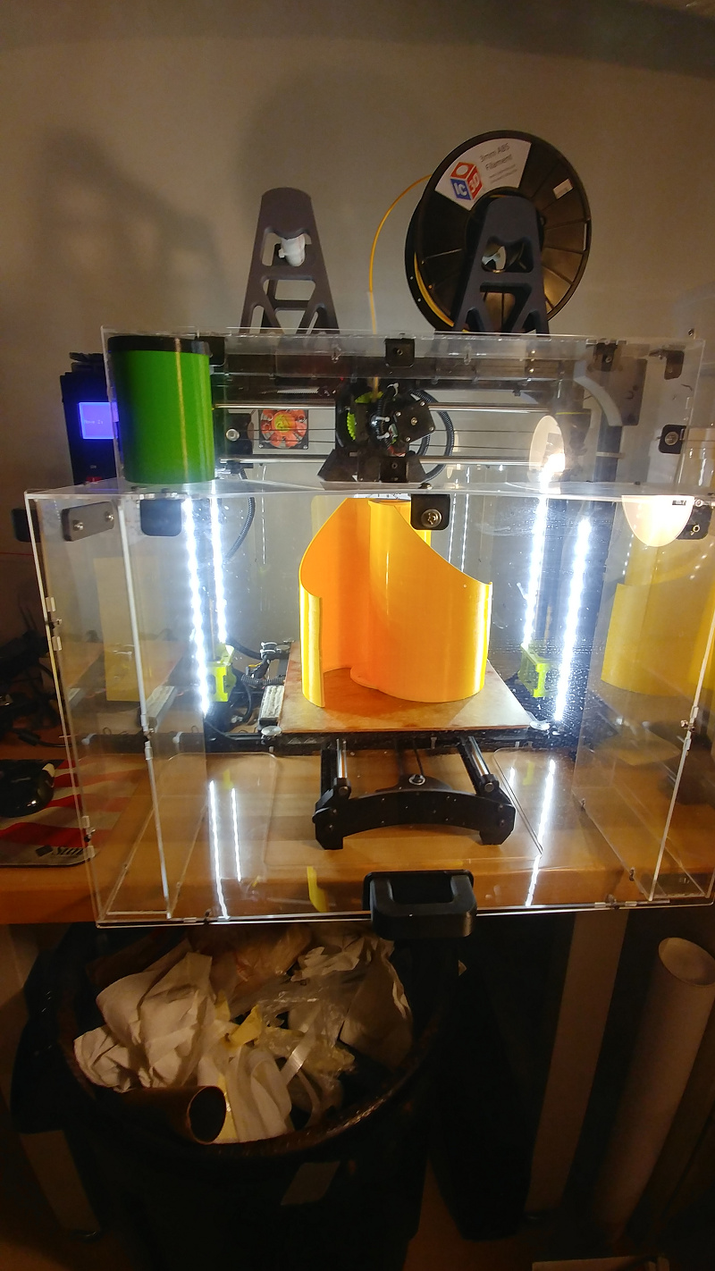

This image is of a Savonius wind turbine printed in ABS. It is almost 100% of the capable volume of our printers. It is very large - 20+ hours.
I used the high speed ABS (IC3D) profile with a 2 mm brim, 40% infill and z seam alignment random. I almost always use ABS - with the right setup, good filament and clean nozzle (tip and sides) it prints very-very good.
Print temp in the profile is 245C and the bed is 105C - don’t try to invent settings, use stock profiles…

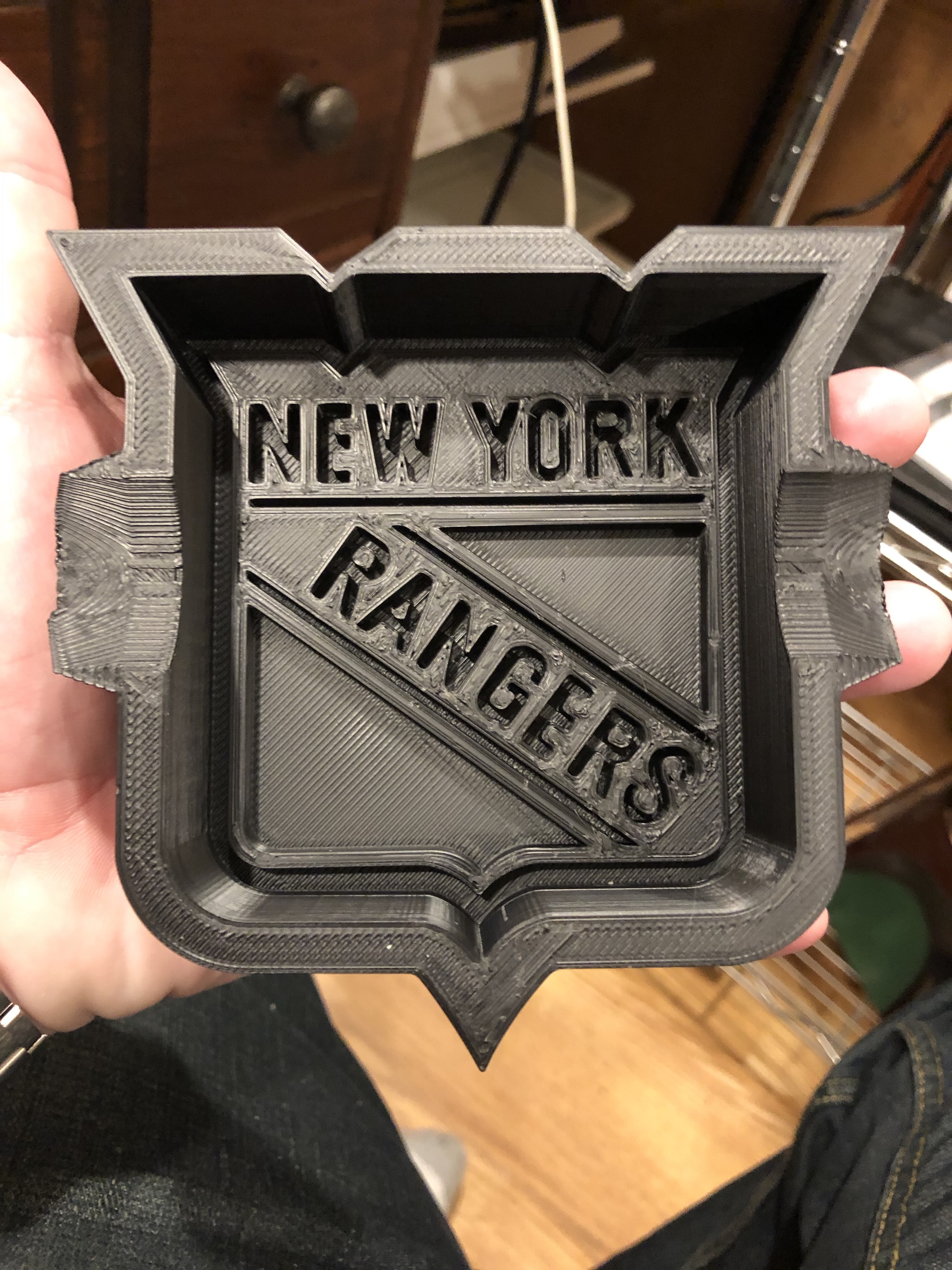

Thank you. I will order the IC3D, I will enclose. I think ABS is best for my ashtrays, which for now will be 85% of what Im printing until I can come with other things I can make for my business. Your enclosure looks to be quite sophisticated. Do you think I could simply make a square box from plexiglass and cover the whole thing?

You can buy the lulzbot enclosure which is pictured above or make one yourself, mines a cabinet type thing with plexiglass doors, I’ll take a pic later. Also you mention 65degrees on the bed, for abs I’m running 105.

Thank you for the great advice. I’m thinking ABS, although the right material to make ashtrays, may not be the filament to learn on. I have moved on from the cheaper, no-name brand filaments, ordered better materials. I keep the bed clean. Use glue stick and scrape/wash after each attempt/print. I will look into changing toolhead once I go back to ABS. But honestly, if the PTFE works well and is strong enough, Ill stick with it for now. Like I said, I’m just making cigar ashtrays now, nothing fancy nothing with much detail. Thank you for taking the time to help, truly appreciated.
