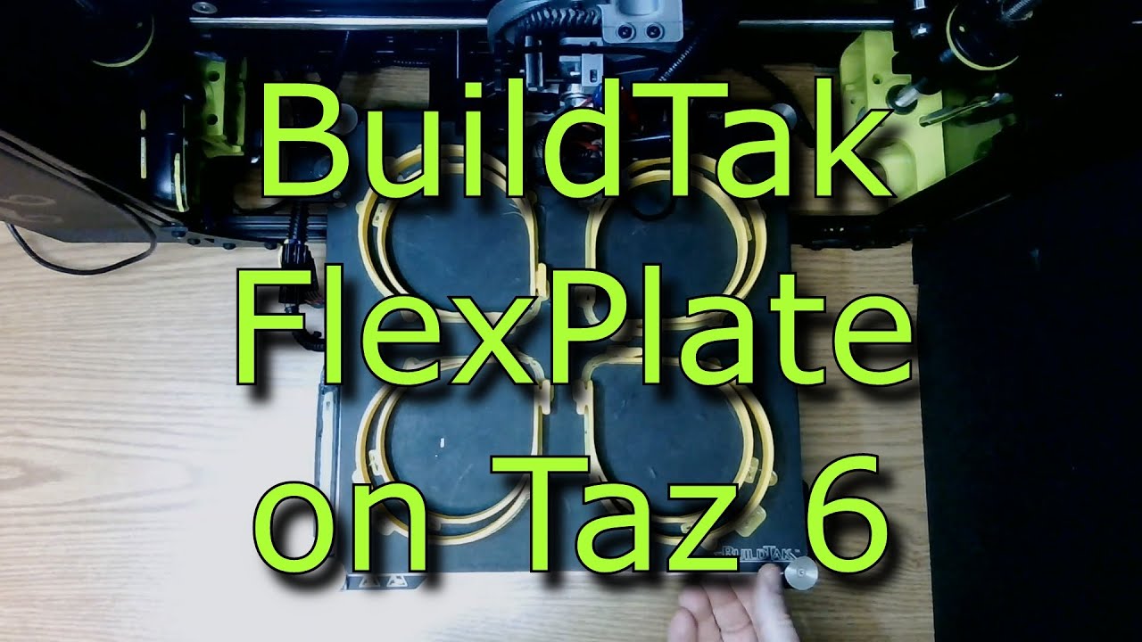

I put a Flex Plate on my Taz. My video has some settings and may help. The numbers may be a little different and I been use Octoprint.
Thank you for the video. I ended up taking a much harder look at my GCODE and found the issue.
