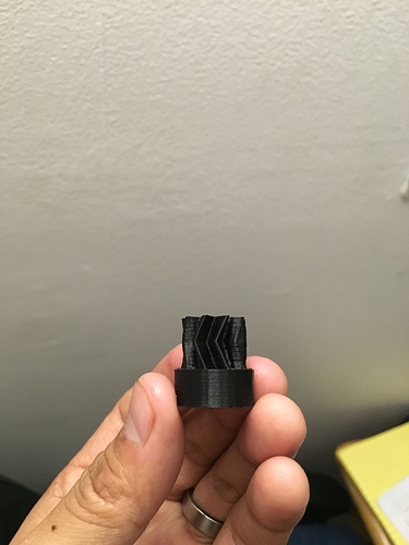

So, I was wondering why the lower layers delaminated and the upper layers seem fine.
Taz 3
Hatchbox 3mm ABS
230C nozzle / fan OFF
90C bed
50mm/s
.3 layer height
The small herringbone printed just fine, same settings. Bed was leveled hot before the print.
Try pushing the nozzle temperature up to 235. You can’t safely go much higher than that on a buddaschnozzle equipped Taz 3. Also raise the bed temperature to 100. It looks like you got a bit of corner lifting on one side, minor, but that might have contributed.

It’s Hatchbox 3mm ABS. The whole thing was actually pretty stuck to the bed. That corner might have been me trying to pry it off. I’m thinking about upgrading to the hex hot end, would I need to change anything in the firmware?

So would it be better to just upgrade the Z axis, and hot end and upgrade to the 5 firmware and start tuning from there? Also I think Ive figured out whats going on… When doing an infill, it seems like it extrudes too much on one side, causing the raised layer look (not really delaminated in that sense…) I think it has something to do with retraction. Not really sure where to start… It seems that the extra ooze trades back and forth depending on which way the fill is going back and forth… It seems to happen more on long distance infills.

Check your belt tension (probably the X belt) and make sure the motor pulley setscrews are down and tight. If it’s only happening on a long distance travel, it could be a slightly loose belt or pully causing a very small layer shift. Those wouldn’t show up on a slower perimiter infil, which is what the rest of the duct is necessarily.
