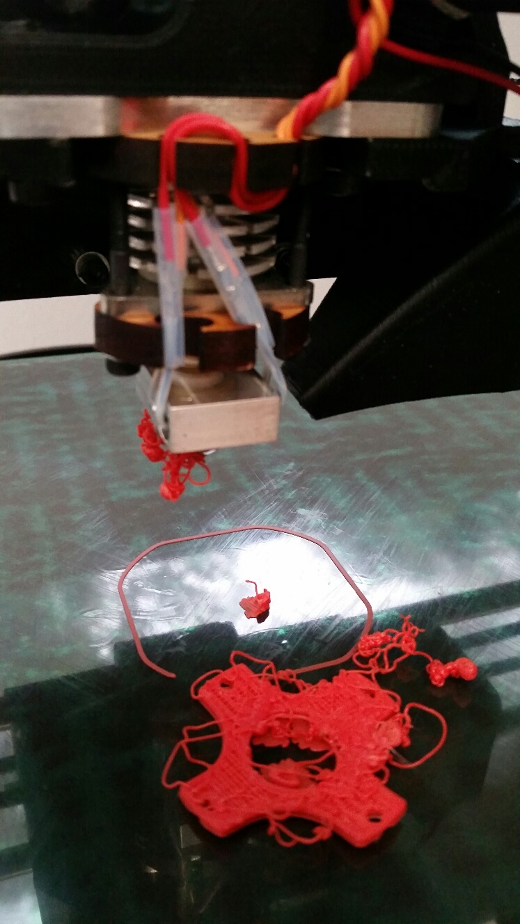

I have a brand new Taz 4. I have made several prints on it before one of the corners on the last one started to lift. I made the juice with acetone and 75mm extrusion sections and then wiped it over the bed and now nothing will stick to it. I can’t print at all. The juice was 3/4 of the acetone bottle with 8 75mm strips in it as recommended in the manual.
ANy ideas?
Yep.
#1) throw away the current batch of Lulzjuice
#2) get a rag and straight acetone and clean off your PET sheet really well
#3) remake Lulzjuice with less ABS
#4) Just apply enough new juice to PET sheet to give you a slight haze
#5) try printing again
The ratio of ABS to acetone is pretty touchy. Too much or too little will result in parts sticking or not sticking.
You have to find the best balance for you.
I assume your bed is level, your first layer is set to something reasonable, the temperatures you print at are proper for ABS, the ABS you’re using is of high quality…
This ratio here works extremely well for us:
10mm of abs filament dissolved in 10ml acetone
So we do 100mm per 100ml :smiley:
Good luck.
OK, it’s official, I’m over it.
Bed temp is 85C
head temp is 230C
I completely cleaned with Acetone and started with weaker and then stronger wipes of ABS juice.
Photos are attached. Does the juice look like the right consistency?
Any ideas?
The part edges curling up off the bed is indicative of ABS printing issues.
First thoughts are these:
  1. Raise your bed temp. I usually print at 95c degrees bed temp. Sometimes I raise to 100c degrees for first 2 or 3 layers then drop temp to 95c. 85c may be to low.
  2. Is your printer fully enclosed? Or open to drafts and room temperatures? Enclosing the entire printer so that ambient temperature during printing is somewhere around 90F is a HUGE help with printing ABS.
As for your juice consistency I can’t say. In the picture you posted where the part broke free and things got messy I’d say the haze on the PET looks a little light, but it’s hard to tell.
Are you using the Lulzbot provided configurations for ABS?
What’s your first layer height set to? May want to try increasing it to something higher?
You could also experiment with adding a “brim” feature.
Add more of the solution to the bed, while it’s hot. You want a visible smear left on the bed, not too heavy, or larger objects will be a pain to remove, if at all. Find the balance.
