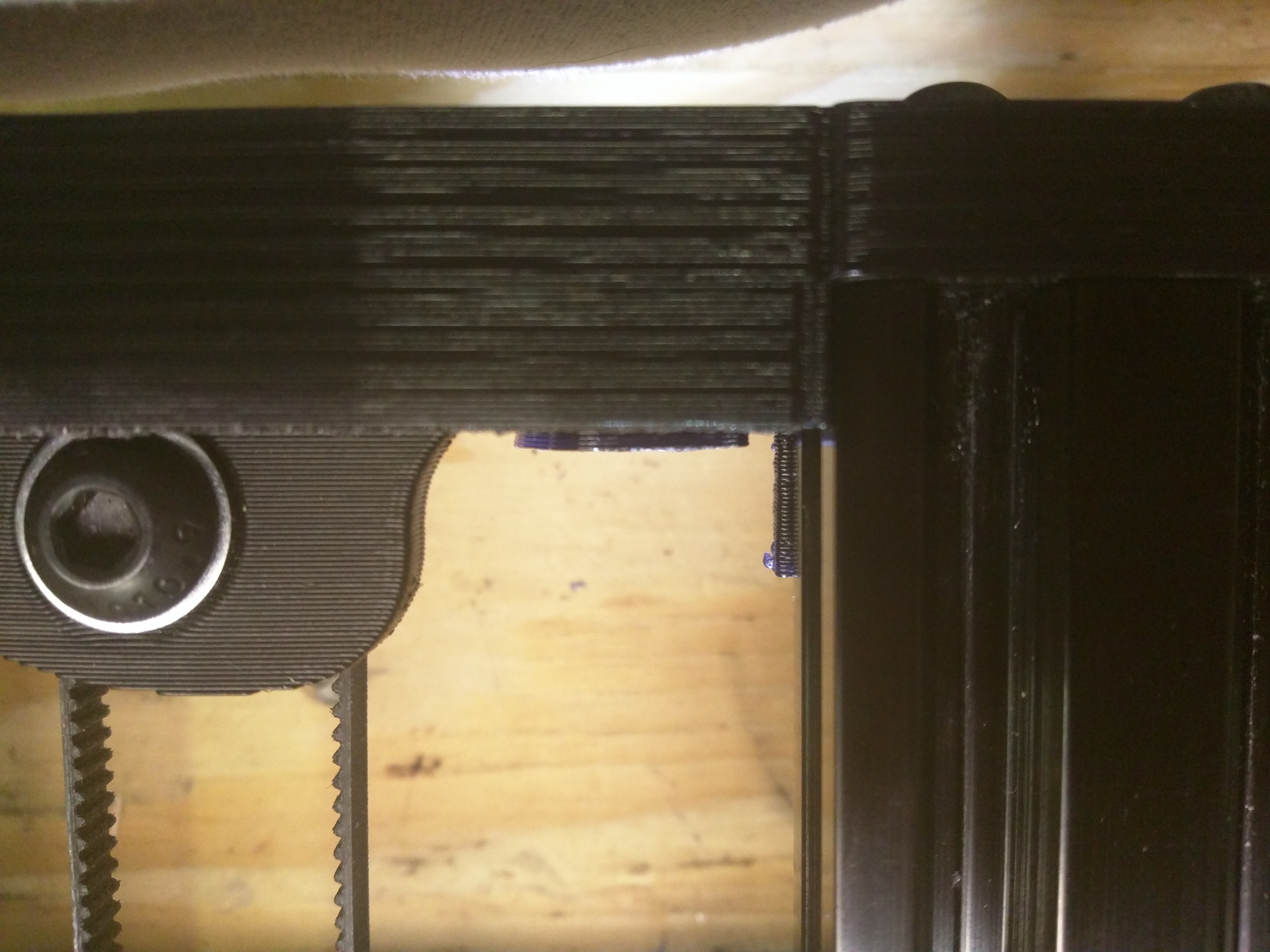

Assembled w the end plates on backwards. Belt would be straight w the offset reversed.
Idler side end stop switch is 4.5mm short of making contact, which is the difference that top center lip sticks out past the face of the stock idler bracket. I like that extra material there to align the rails and its nice having one single part for both ends.
The easiest fix would be getting two bolts 20mm long for the left side of the idler. Print up a small 5mm thick spacer that spans those two bolts. Spacer will be pinned off the top bolt, on the lower bolt put a nut to lock the spacer on.
Would of been amazing if this worked… a 20mm long upper bolt w 2 nuts locked together on the end misses depressing the button on that stop switch by 1.5mm. I’m sure someone makes a huge oversized nut, but my spacer idea would eliminate having to hunt this down.
Last thing i forgot, every program i opened up this end bracket model in filled in these offset holes. The plug was only about 1mm thick, i drilled it out.
I’m gonna run this as is w the stop switch temp rigged up, reprint the corrected endplates and spacer.

I figured out what was up w that part, must of been accidentally flipped when you exported the stl and added it to the archive. In the archive when that part is opened…the print side is facing up and incorrectly offset while all your other parts are orientated print ready. All I needed to do is flip X then rotate z 180. I bet your file is correct on your pc which is confusing us both
Not sure reducing the Y build volume is good. Might be better to reduce the lip at the top so the switch/bed can travel to the proper location.
The front and back plate are the same, short side to the left as stated in the directions, but the pictures for the motor are backwards.

IMG_20170509_134021.jpgHow about this- i cant find the pics to back this up, but for some reason the thought that your stop switches had the big metal arm on them and you directed someone to bed the arm out a bit to make contact? Maybe that was someone elses mod? The 6s button only sticks out 1.25-1.5mm.

The stop switches are 2" past the edge of the build platform. Adding the shim has no effect.
See if this one works
Looks right, other than it comes in upside down.
This was your file I flipped and printed. Its oriented print ready-
Taz_V6_Openbuild_Y_Endplate.stl (119 KB)
Idler spacer I made-
Taz_6_Idler_Spacer.stl (171 KB)
