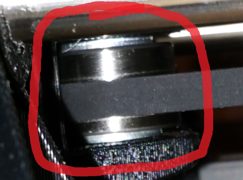

Take a look at the Y-axis belt path/travel. I wonder if the belt is moving up and down along the pulley when it’s moving. If so, move it down on the pulley and see if the belt can sit along a straight path.
The belt tracks in one spot on the Y-axis belt pulley, namely the lower half of the pulley (see pic). It does not move up and down, but I’m wondering if it should it be more centered on the pulley to eliminate the issues at hand?
If the belt is not moving up an down along the pulley/bearings it’s fine. Wipe your rods or look at your bearing holders to see if they need to be snugged up a bit closer to each other.
I wiped the rods, but the bed vibration persists. What’s the minimum distance between the bearing rod holders that will still give me excellent quality prints? Will I need to remove the bed to adjust the distance between the bearings?

Check the belt path to make sure it’s not pulling the bed up or down along the Z, and see if it’s rubbing against the belt mount. Alternatively, loosen and slide the bearing holders closer together (it’s fuzzy, there’s no exact measurement, provided your movement is smooth with very little resistance.
