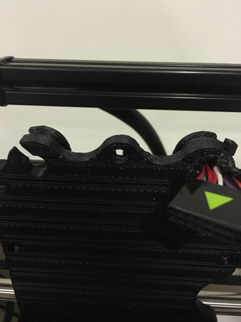

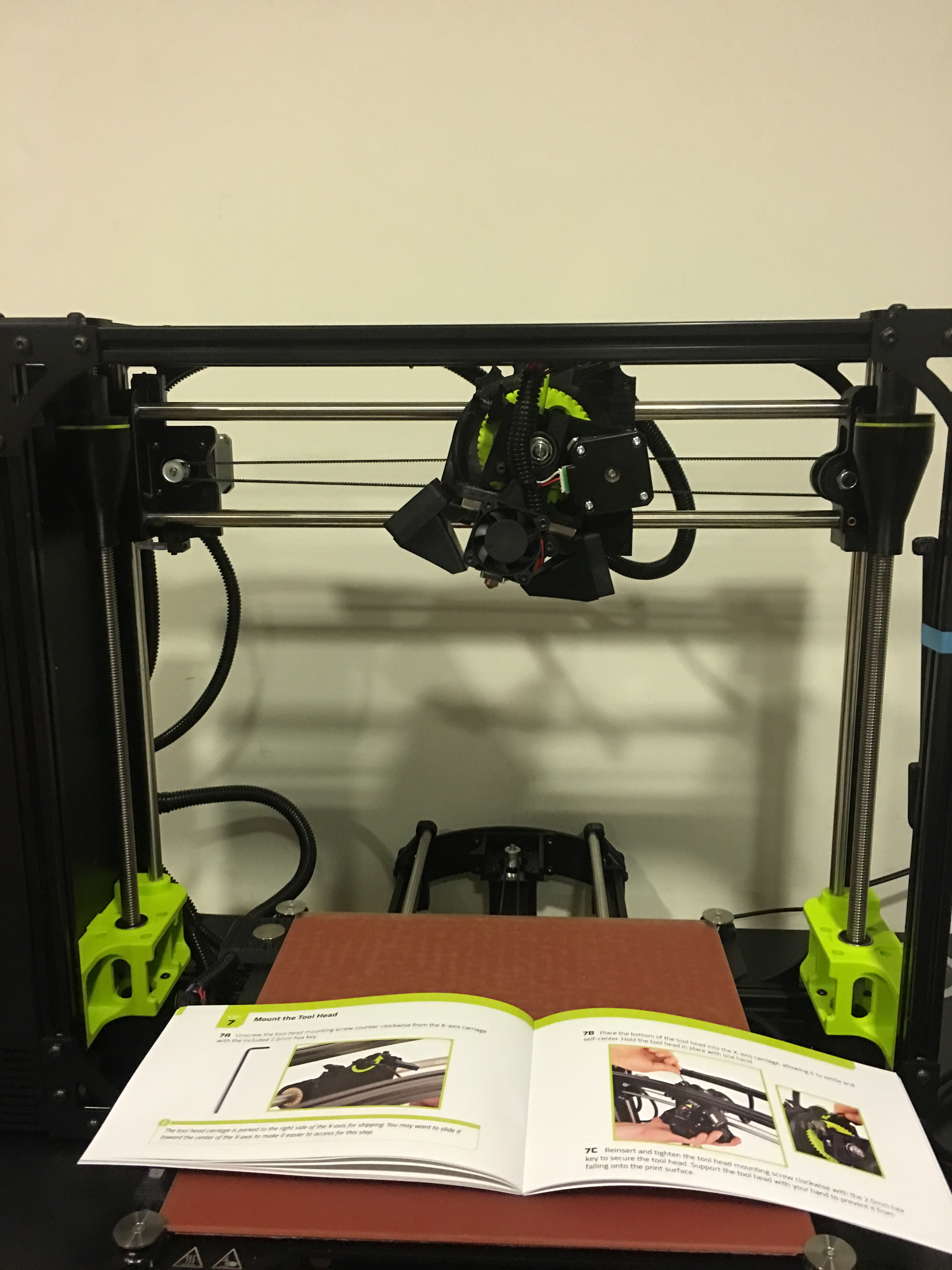

As you can see, my printer slants to one side and does not centralise when I try to do so.

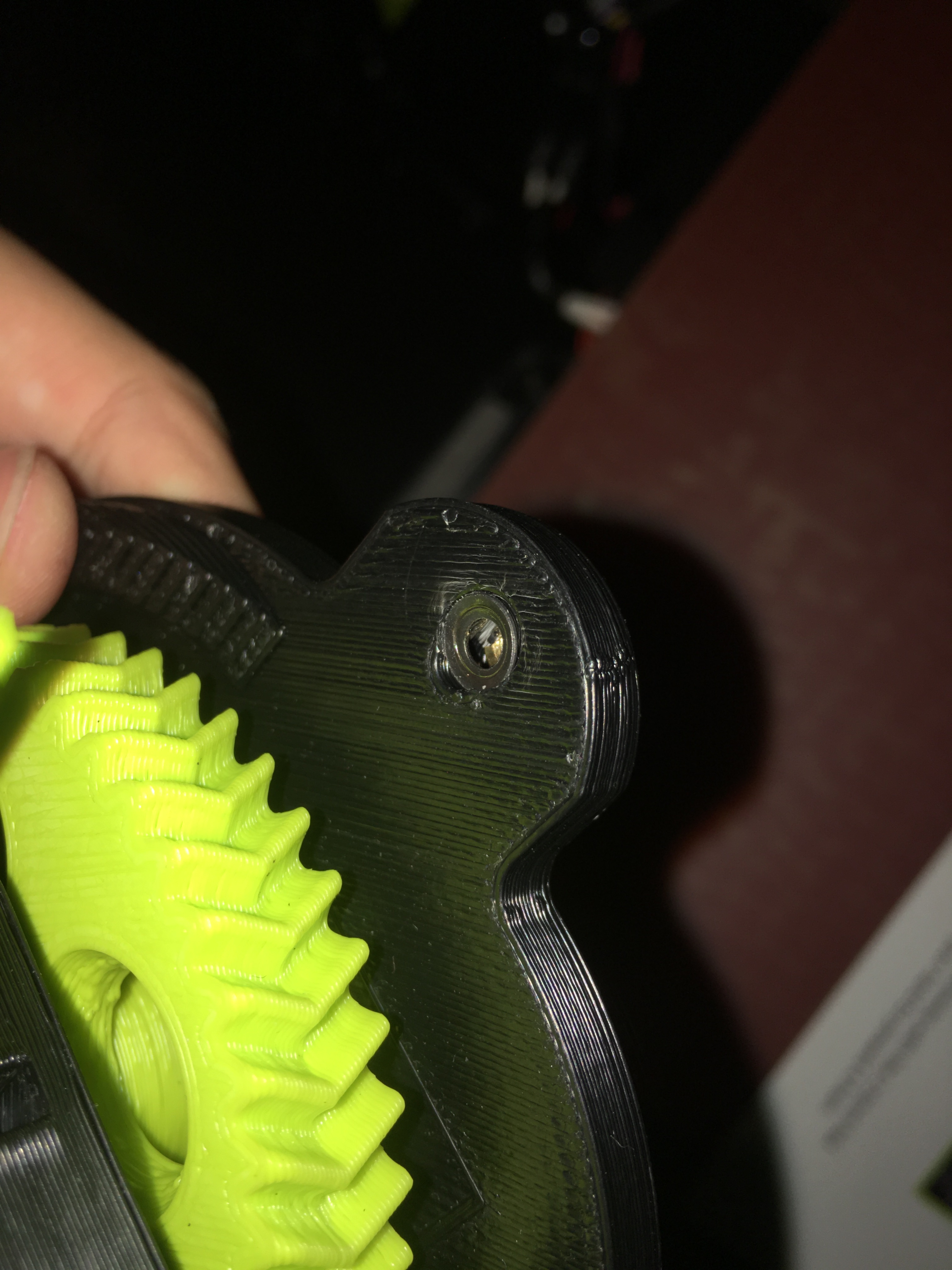

I then tried to centralise it myself by manually adjusting it and slowly tightening the m3 screw
No matter how much I tightened (And i did it really slowly, bit by bit to see if it helps), the tool head would be loose.
After a while, and without any indication (it was still loose), it got over tightened and it broke as you can see below.
For starters you re missing a washer on the bolt that holds the toolhead to the carriage. Also, you torqued that bolt down wayyyyyyy to far. it’s not supposed to be recessed all the way through the toolhead. The missing washer might be a quality control issue, but the overtightening is kind of a common sense issue. I’m not sure you can blame that one entirely on them.
