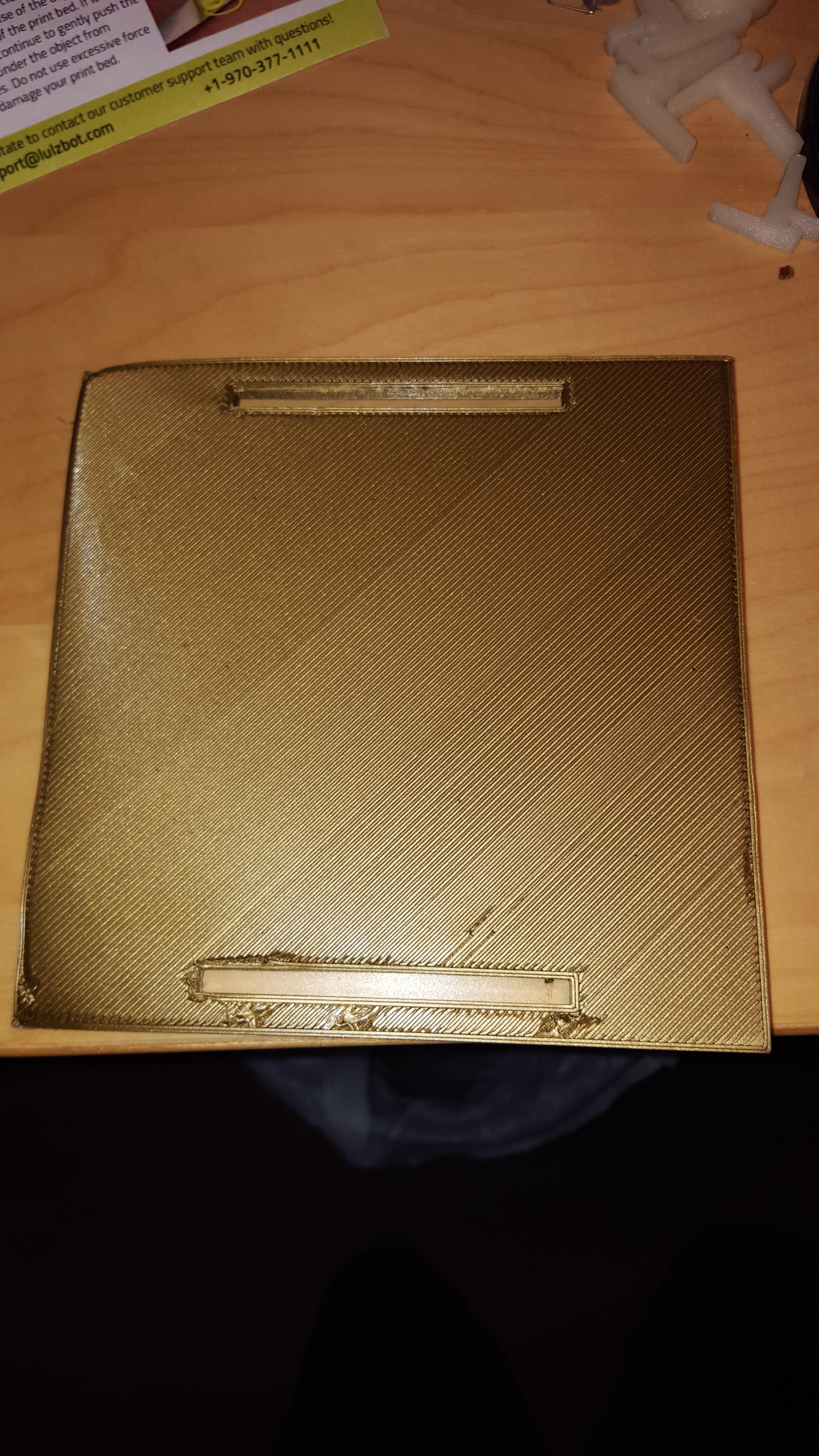

Thanks for the advice. Will look into those dial gages. Seems way better that the other way. I’m never quite sure I’m measuring exactly the same points on all sides. Here is a picture of the bottom of that print. Both corners on the left side have pulled up. This is the worst print we’ve gotten as far as both issues. Will bump up the top she’ll as well. The default setting was 1mm, which is what this was printed at.
Judging from the print, your initial nozzle height looks good.
Does it consistently lift off the same side of the bed? May want to try sanding with a fine grit. I regularly use a Mr. Clean Eraser Sponge… just abrasive enough to get rid of any oils.
PLA likes to be cooled throughout the print, so make sure the fan is on from the first layer.
