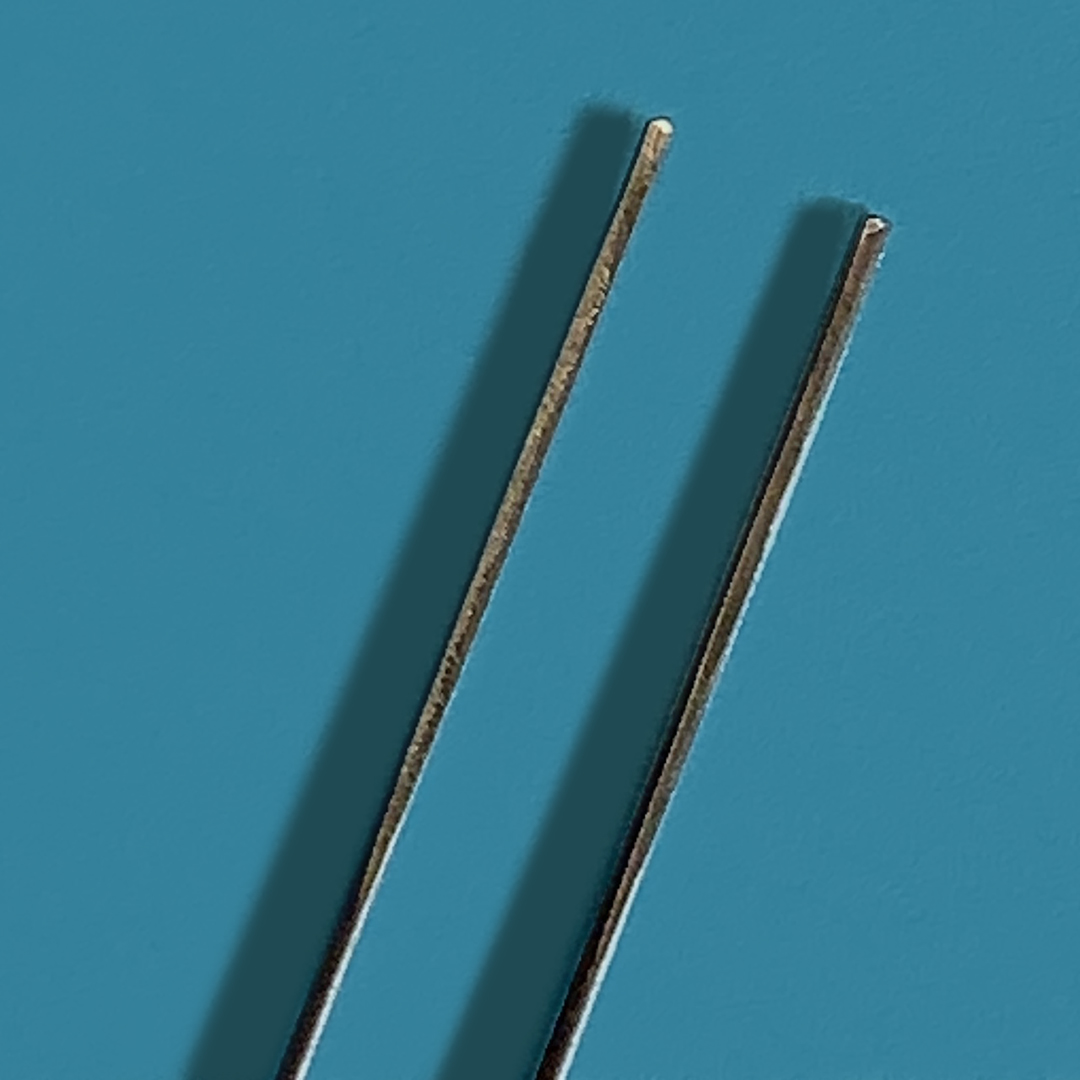

Can someone point me to the specific pin removal tool OR
the aerostruder molex connector part number so I can identify which version to use on this connector?
The instructions link to:
https://www.molex.com/pdm_docs/ats/ATS-011030043.pdf)
But numerous tools are listed.
OR
More details on how to use “some sort of tool with a small point”?
Solved
watched:
made two “probes” out of .03" music wire (hammered flat, filed, rounded ends, removed burrs):
pliers used to poke around until felt probe slip in a short bit (one side of pin at a time) as shown in video.
A pick or sharp object usually works to push the pins/latches on the connectors…
I use upholstery pins.
