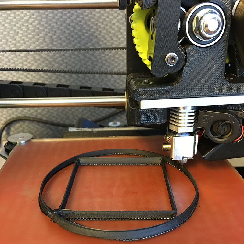

Yeah, it doesn’t work at that fine a level. Just seems to crash the app and then the machine freezes. Here is where mine stopped.

My only other problem is that when I print from my Mac, my models come out like blobs. Somehow, I think that will be easier to solve with more research. See photo: Printing Blobs. Somebody Please Save me!
Thanks again!
