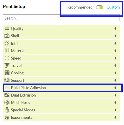

It appears that the build plate adhesion isn’t set up correctly under the recommended print settings on Cura 2.6.52. We have created a ticket to address this. It can be found here if you would like to follow it: LulzBot 3D · GitLab

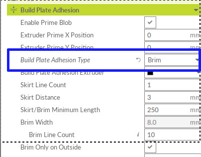

If you toggle to the custom setting, brim can be turned on under build plate adhesion. You can also adjust some other options there as well should you so desire.
