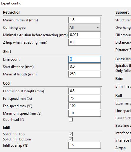

I’m new to this world, but already printed several 3d models. for my work there is a 3d design (small camera holder) which stands the sizes of the print plate (length is 15mm exactly) and even if I modify the print size it still shows in Grey color in CURA and not giving me the option to click on “Control” and start the printing.

There’s not enough space left on the bed to print a skirt around the perimeter of the object.
Go into Expert Settings > Skirt
Removing the skirt or reducing the perimeter down to 0.8mm would change the model to “green”
