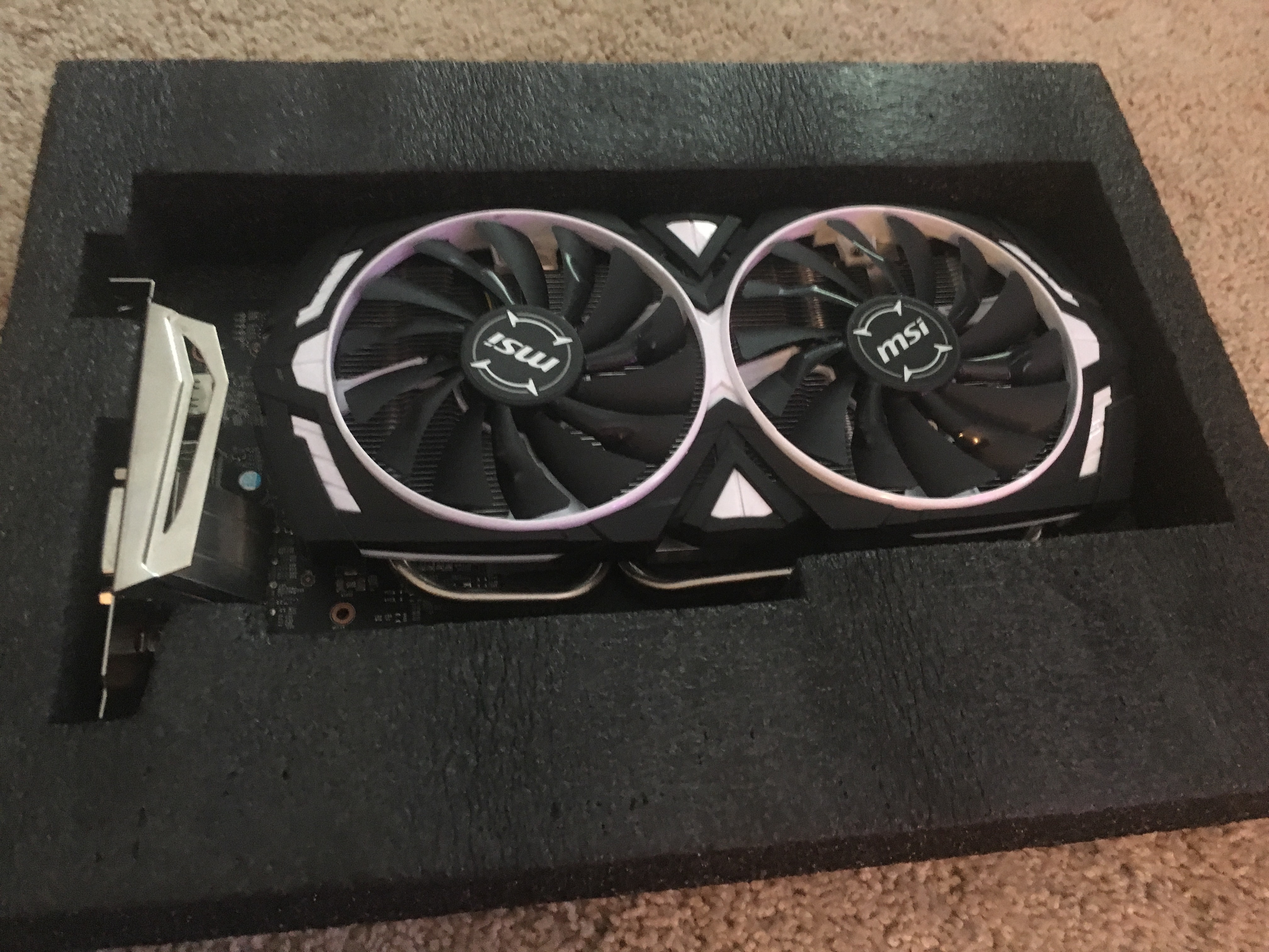

Thought I’d share the project I’m working on. I’m building an external GPU setup for my laptop so I can work on VR projects and in real-time development environments. I’m using the PCIe card/bracket/fan from an AKiTiO Thunder2 enclosure, 550w computer power supply, and a front intake fan from an old Antec case collecting dust.
MSI GTX 1060 3gb Armor, designed the enclosure so that I can upgrade to just about any full-size card and a powerful enough power supply to handle any card on the market.

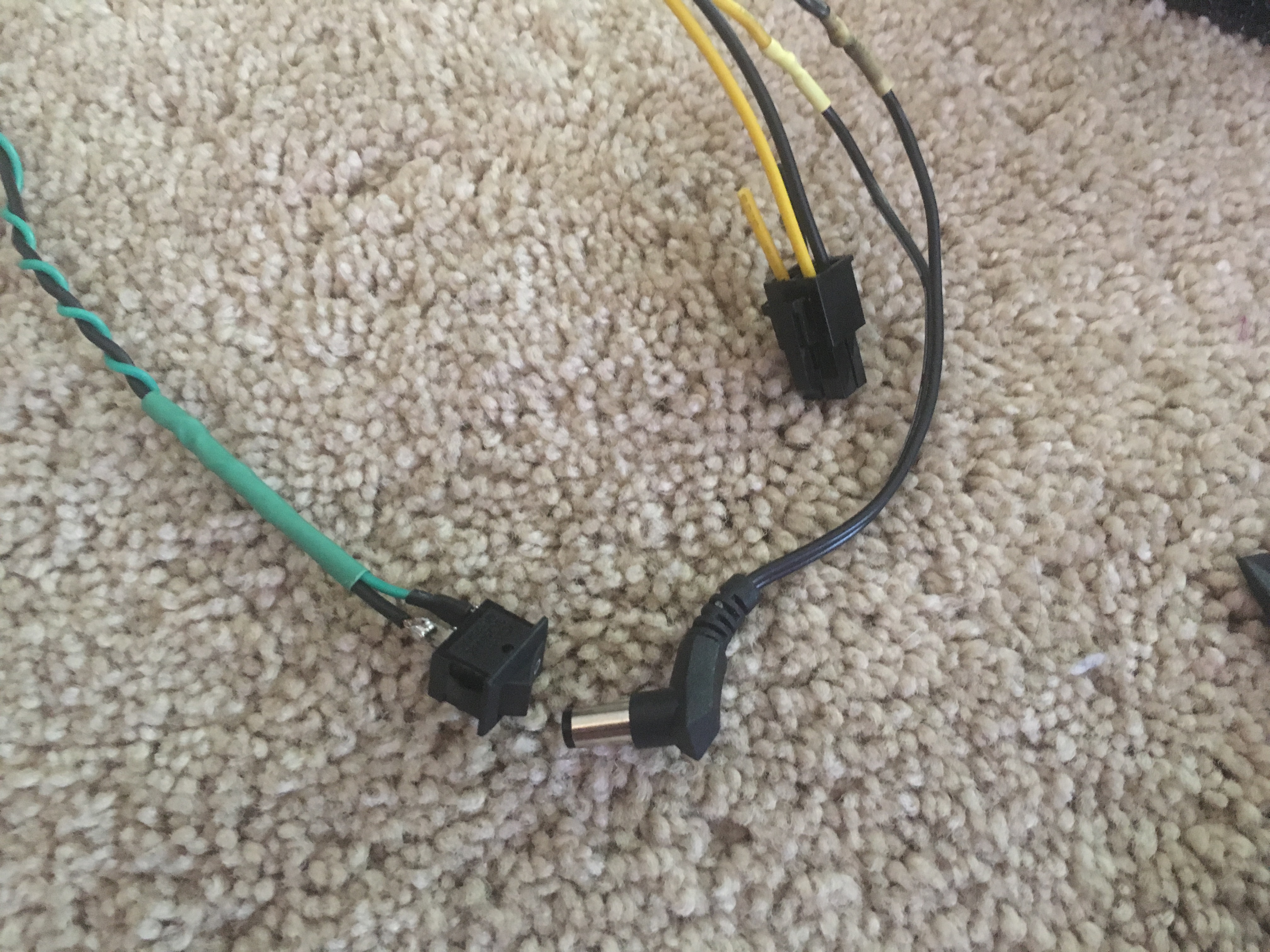

Need to add a connector for the on/off switch wires so it can be installed from outside the case. Was originally going to keep the bullet plug, but I’m going to solder directly to the board instead and add a connector between the PSU and the wires soldered to the TB2 board.

Should be able to fit any gpu in the case.
