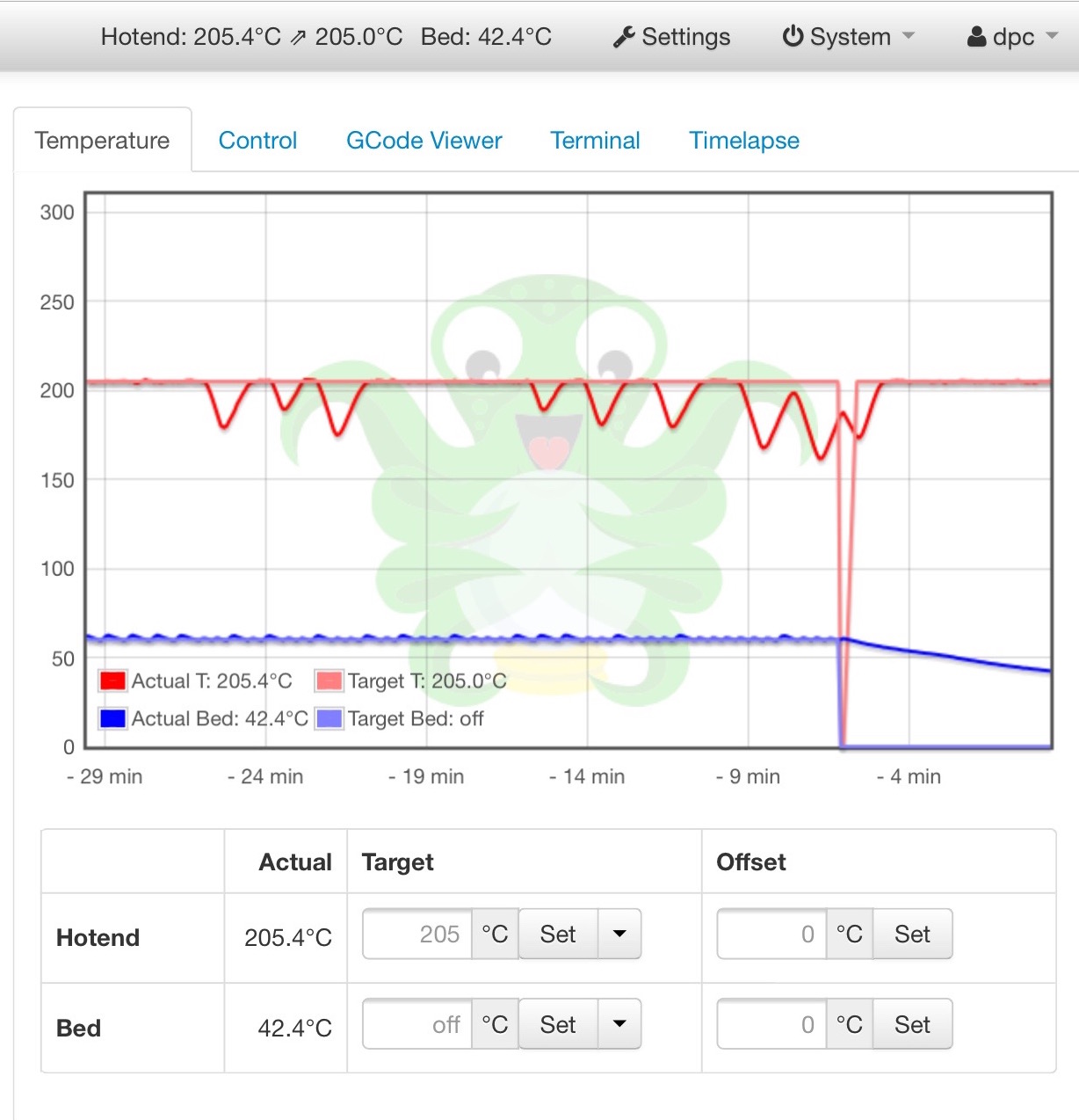

extruder temperature dips
I downloaded the latest Lulzbot Cura, and updated the firmware for my Mini since it mentioned something about fan hardware related updates.
Now my prints have become problematic. layer delaminations and other print quality issues. I had not changed anything else from proven files (had printed same .gcode before the firmware update). I think I have uncovered what is going on: temperature stability on the extruder. See attached temperature graphs. I have never observed previously the temperature stability problem.
How can I switch back to the previous firmware?

Wow thats a heavy temperature drop!
Do you know if the fan speed was related to the drops? I would recommend to flash back to the version that was working for you, then contact Lulzbot to let them know they may have a bug in the latest release…

I noticed the same kind of temp graph on my heater bed some time ago.
It turns out that a wire was failing between the print head and the controller board. The continuous flexing caused one of the wires to finally break from fatigue. What you may be seeing, as I did, is the connection being broken and reconnected. It didn’t seem to follow a pattern with the movement of the bed, but then I didn’t really analyze it.
It was difficult to find the point in the wire where it failed because the covering insulation was not damaged at all. When I did locate it, I could see the darkening of the individual strands where it had been arcing as it failed.
I replaced the wires and the problem ended.
Cheers,
Gary
I also had this problem, resulting in a complete failure of the bed heater. The wiring for the bed heater was replaced in an RMA process. Ultimately, it looks like the replacement of the bed heater wiring may have loosened the adjacent extruder heater wiring on the electrical board.
Since I’ve reseat the wires in their posts on the electrical board (ended up doing this while in consulting with Lulzbot support) I have not had an extruder heater temperature control problem.
I would double check the tightness of the connector screws to make sure they are tight and compressing the wires in them. There is a number of amps of current going through then both and if not tight, will heat up and cause intermittent problems.
Great minds think alike, I guess. :laughing: I had done exactly this , especially after I had noticed one of the wires had some of its insulator flattened and compressed under the screw. This must have been the source of my extruder temperature issues, since my Mini has been working great since.
