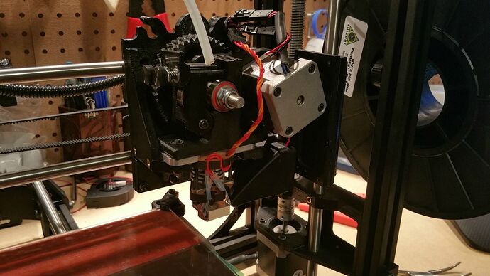

Can you post a picture of your printer here so we can tell which model you are dealing with and then find you the correct firmware?
Happy to provide all the info I can.
The printer itself in all it’s glory. Bonus: messy workbench.
Picture of the extruder

That sure looks like the right firmware and you definitely have a Taz 4. Might be worth a call to support even out of warranty. There may be something wrong with the firmware download irself, possibly it’s pulling from the wrong location. Also try the one directly from download.lulzbot.Com in the Taz folder then under the 4.0 directory. On a tablet at the moment so I cant easily get you the full link. But that’s a different copy than the one you have so it might work. Another option for you would be the copy of the firmware in the development forum project for adding status indicator lights to a taz.

If I remember right the leadscrews on the 4 use a higher step value so you probably have the wrong firmware on it somehow. Also is 850 your correct step value? I don’t have my printer with me at the moment so I can’t check mine for you.
Edit the firmware steps values are stored in the configuration.h file.
You should be getting 1600 back for the Z steps, 400 is the value for the TAZ3 machine with the old style Z screws.
