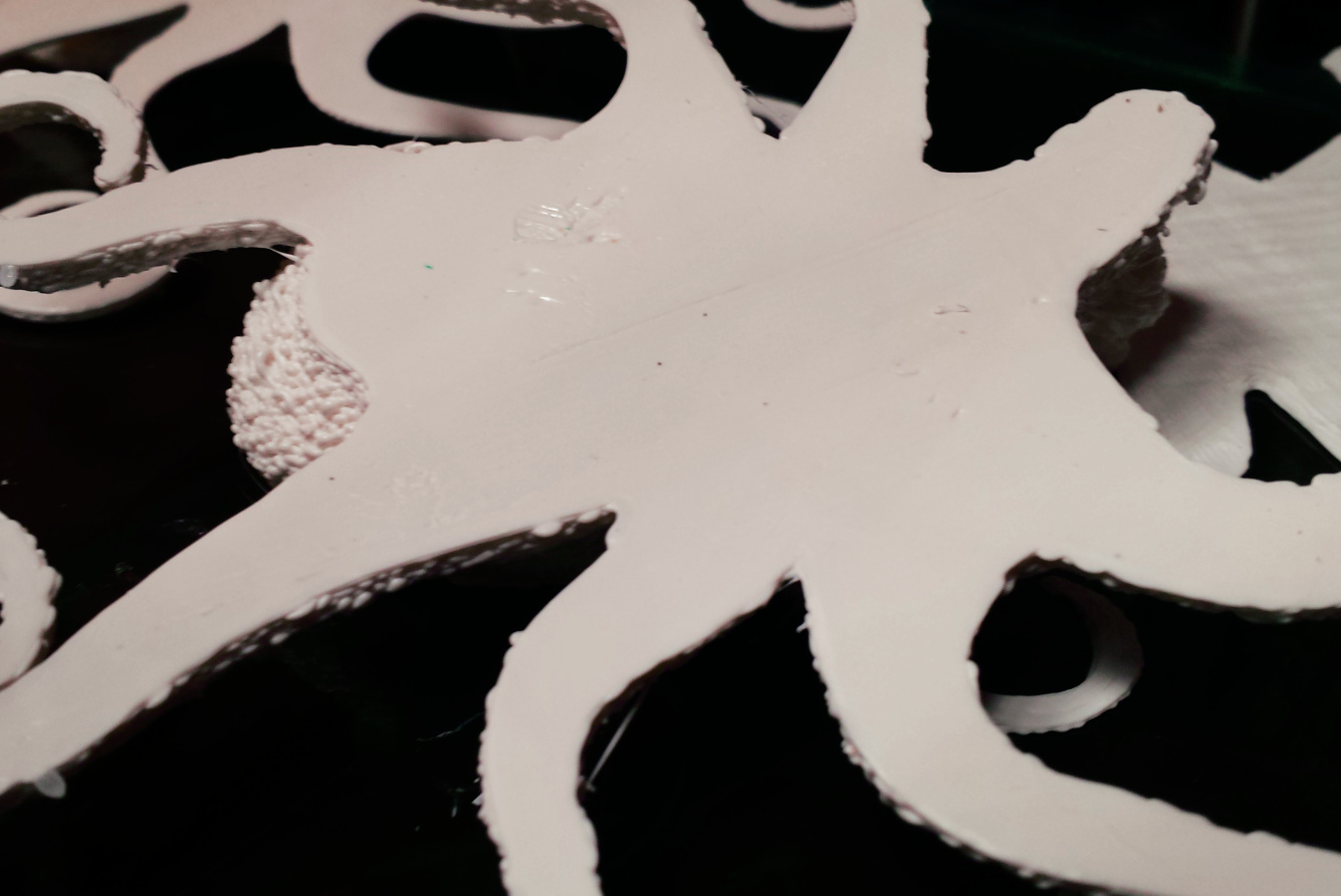

I opened the rocktopus_v1.9 inside of Netfabb to get the exact dimensions so i can check compared to the real print it shows me that length is 146.57 width is 148 and height is 47.17.
I will come back to this a bit later.
This was print 1 and how it failed - that’s ok prints fail although i am not quite sure why it failed.
Print #2. completed but didn’t look right. in the Z axis
Print #3. completed again looked even worse, I assume it was because it was on fast. but the Z layer height was still not quite there.
Using part 2 and 3. I started to measure it compared to size i saw in netfabb above.
X accuracy is right on.
Y accuracy is right on.
Z height however. is off by almost 50%
Netfabb says that the model should be 47.17mm tall.
Z height for #2 is about 20 MM
this is print #3 height it comes to about 22mm
top view of #3
Top view of #2
Bottom Bed adhesion of #3
Bottom Bed adhesion of #2
failed print #1 bed adhesion
I have re flashed my firmware to the TAZ 4 single extruder, adjusted my E steps based on https://ohai-kit.alephobjects.com/project/extruder_calibration/
I moved the Estep value from 1140 to 879.7 based on what was in the tutorial.
I made a mark at 120 and it leave 20 out

The Taz 4 has supported Leadscrews top and bottom on the Z axis. The Taz 3 and below has a threaded rod supported at the motor. The thread pitch is significantly different between the two machines. You either have a Taz 3 with Taz 4 firmware on it, or a Taz 4 with Taz 3 firmware on it. If you want to post a picture of your whole printer I can tell you which one for certain. If it ends up you have a Taz 4, and you reloaded it with what should be a Taz 4 firmware, let the lulzbot peoples know exactly where you downloaded it from. it’s possible there is a firmware somewhere with an incorrect value.
That specific issue is pretty much only caused by Firmware not matching the hardware. It’s theoretically possible it could be 2 loose motor cables as well on one specific pin, but that would be highly unlikely.

Your Z steps should be 1600 if you have Taz 4 firmware loaded. So, either that copy of the firmware is wrong, or you somehow have all or part of a 3 firmware compilation loaded.

I just double check the firmware flashing guide, and you may have downloaded the incorrect file. TAZ 4 Budaschnozzle file should be Marlin_taz_4.1_revb.cpp.hex
We used the 800 steps/mm in our TAZ 1-3 models, as they had a different Z axis drive rod.
I certainly downloaded the right firmware based on last statement
I went ahead and modified my
ZSteps from 800 to 1600 and i am currently in the process of trying to print again to see what happens. I would like some clarification as the difference between the numbers and why they are the values they are.
Z steps per milimeter is a measurement of how many motor steps it takes to move the motion axis 1 milimeter. Under the Taz 3 and below, the threaded rod actual thread pitch and rod diameter is significantly different than the thread pitch and rod diameter of the leadscrew. The motor is the same. In order to move the more accurate leadscrew axis 1mm, you have to turn it twice as far (mainly because the rod is much wider), hence the larger number. That is set inside the configuration.h firmware file inside the firmware package itself. Your firmware was showing 4.1, but it has the old value. Which is wierd. But someone else ran into that same issue in the forum. they fixed it by uploading a different firmware. My guess is that at least one of those downloadable firmware packages for 4.1 on Cura has an incorrect value in it somewhere. Not many people are going to upgrade the firmware on a 4, and Cura was introduced more towards the 5 so probably not a whole lot of 4 owners are using it.
I am normally not one to get hysterical and say Success! but in this case I’ll take it. all I did was change the Z Esteps value to 1600 and I got this print
