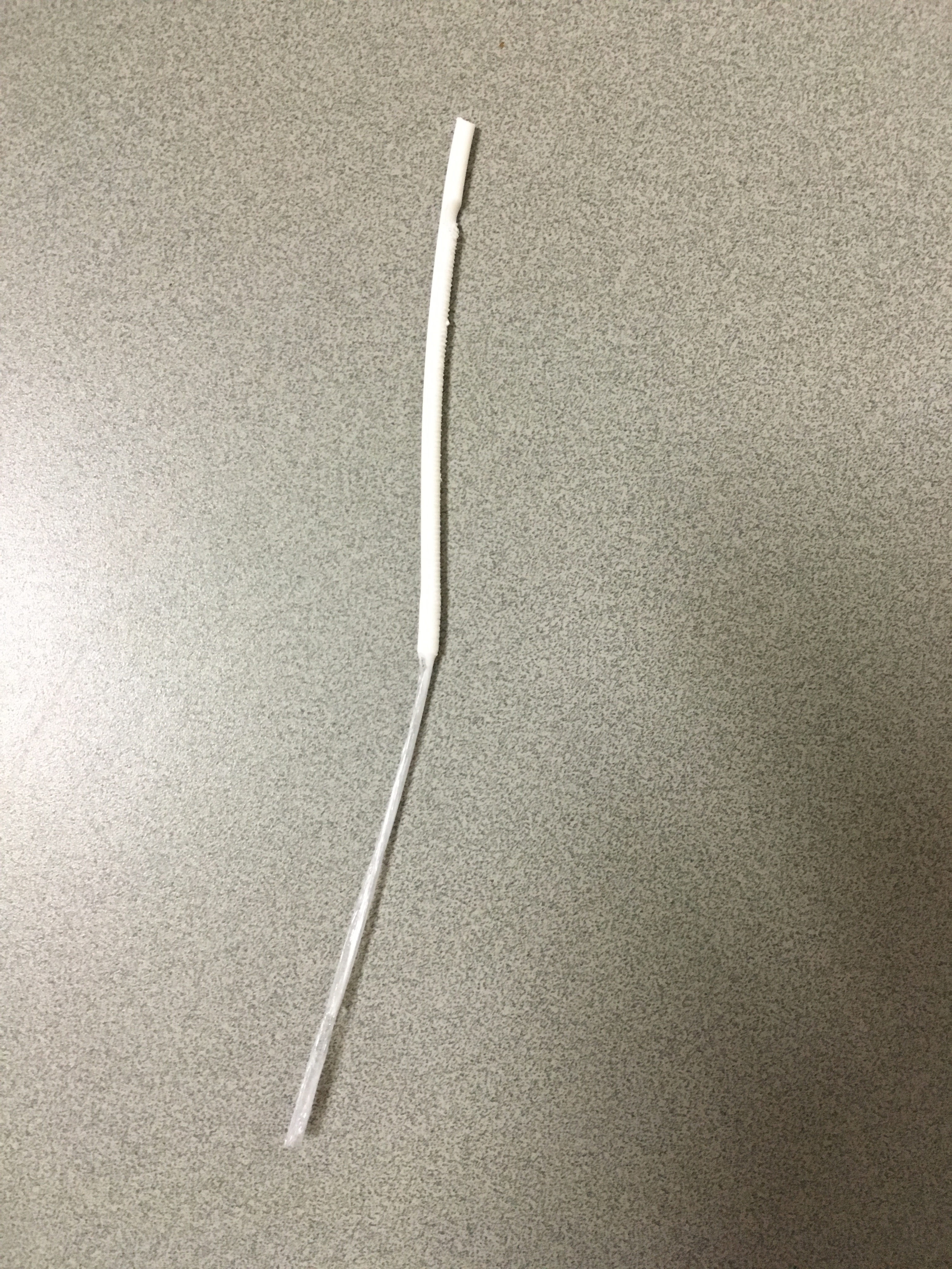

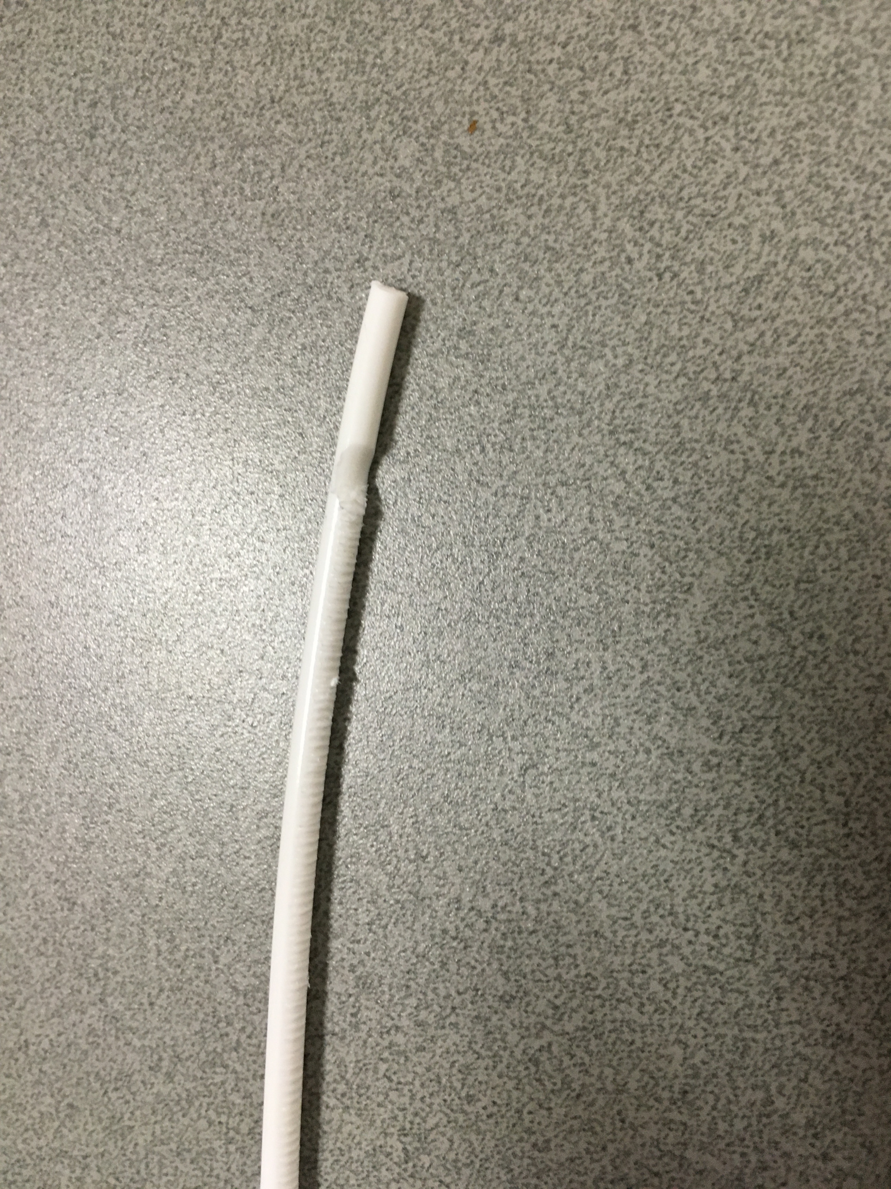

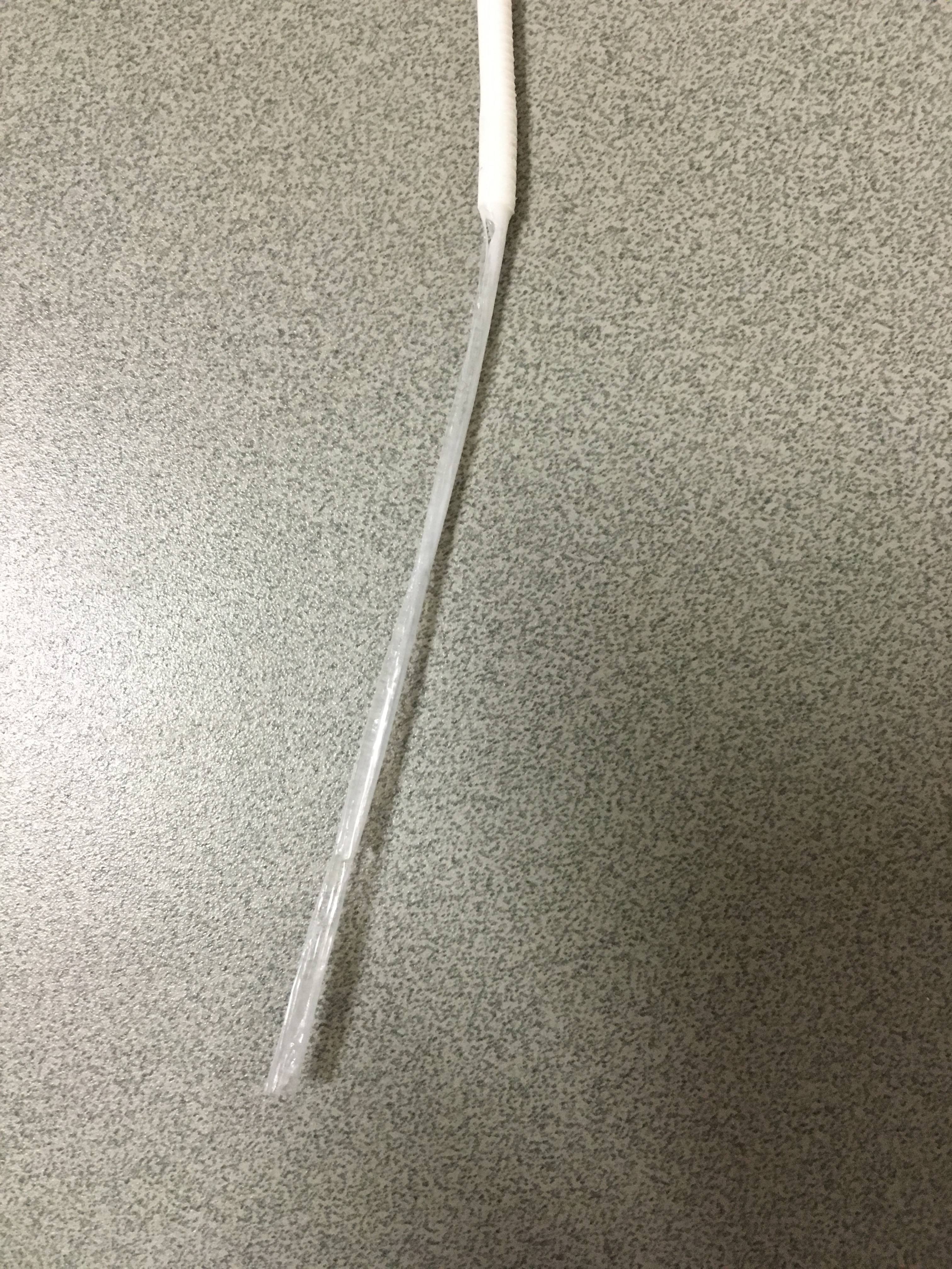

Having issues similar to what other have described and have tried a number of suggestions from the thread. The Mini seems to be good for about an hour and then the filament jams and gets chewed by the Hobbed Bolt. Before this happens the filament begins to extrude in a patchy manner. None of the suggestions from this thread have seemed to fix it. I took some photos of the filament that I backed out after the last jam. I have not seen anyone posting anything like the first shot. It looks like the plastic has been extruded out leaving a clear husk. No idea what would cause that. Anything else to try or anyone know what this image might be indicating? Thanks.
