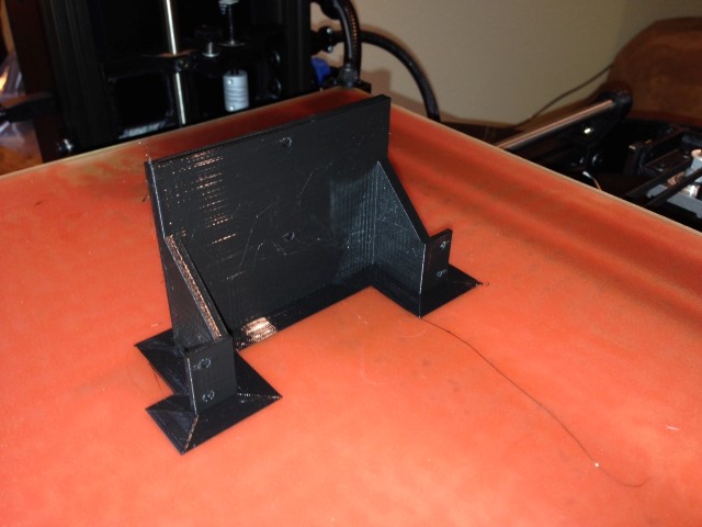

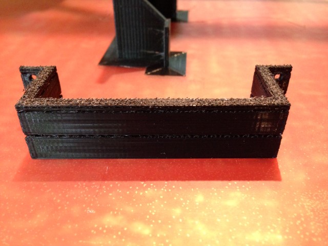

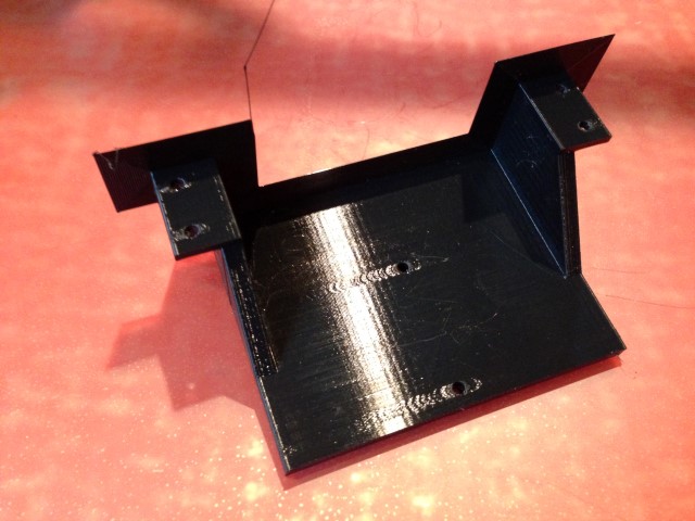

Since I’ve still been seeing jams occasionally, I created a little oiler that can be used to help keep things moving smoothly.
Just put a little cotton ball in the well and add a few drops of your favorite olive oil.
Haven’t done much testing but here’s some pics and the files for the part if you’d like to give it a try.
The design file was created using Autodesk 123d.
(Printed with support structure touching build plate only.)
Oiler Base v6.zip (229 KB)
Oiler v6.stl (3.93 MB)

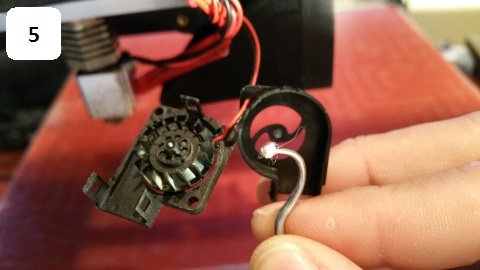

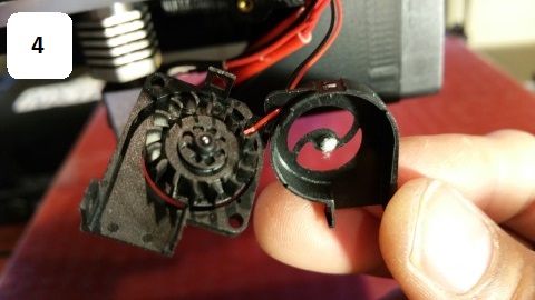

The micro blower is spec’d to be “always-on”. When I researched the problem further, it became painfully clear that if this blower is stalled, heat will transfer upward from the hotend to the (finned) 6061-T6 aluminum cooling block all the way to the top of the 330 stainless steel heat break tube (the top of the tube is supposed to stay cool). Heat was also transferring to the 6061-T6 aluminum mounting plate! Without the micro blower the heat break tube will get hot enough to melt the filament before it makes its way to the hotend. With that much heat the filament will soften at the top end of the heat break tube. The cooling tower and mounting plate shouldn’t be too hot to touch because PLA has a low melting temperature (lower than ABS). When those components heat up (especially the cooling tower & the heat break tube that it surrounds) this will cause the filament to expand and jam above the heat break tube. At this point the hobbed bolt will also begin to chew away at the filament and, you guessed it, you’ve got a jam.
Note: In case you’re wondering what the heat break tube is, it’s where the filament first encounters metal. You can find more parts specifications directly from their publicly accessible documentation at: Index of /hot_ends/argon/pdf
jammed filament (leftmost side was inside the heat break tube, rightmost side was beginning to get chewed up by the hobbed bolt)
Solution:

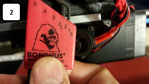

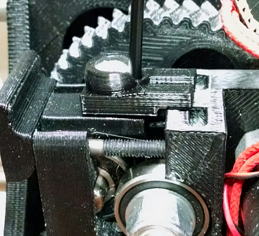

Using a 1.5mm hex key to remove the micro-blower from the remainder of the assembly, I carefully unlatched the 3 clips that keep the blower’s shroud in place and discovered that fine spider-web-looking strands of filament had collected at the outside-facing end of the blower spindle (outer housing). After carefully removing the collected filament strands, reassembling the micro-blower and bolting it back in its original location, I turned the printer on and heard the welcome buzz of the micro-blower immediately return. The metal components above the hotend are now able to be touched - even when the hotend temperature is at 220 degrees.
The below images are for visual reference:
the micro-blower
1.5mm hex key for removal
remove the single bolt and carefully remove the blower
collected PLA filament strands in the blower shroud
careful removal of the strands
Per three separate, and successful, tests following this procedure the PLA filament jams have been resolved. I documented and posted this in the hopes that it can help someone else save money, frustration and tremendous amounts of time if they run into a similar issue with jams and a stalled micro blower.
