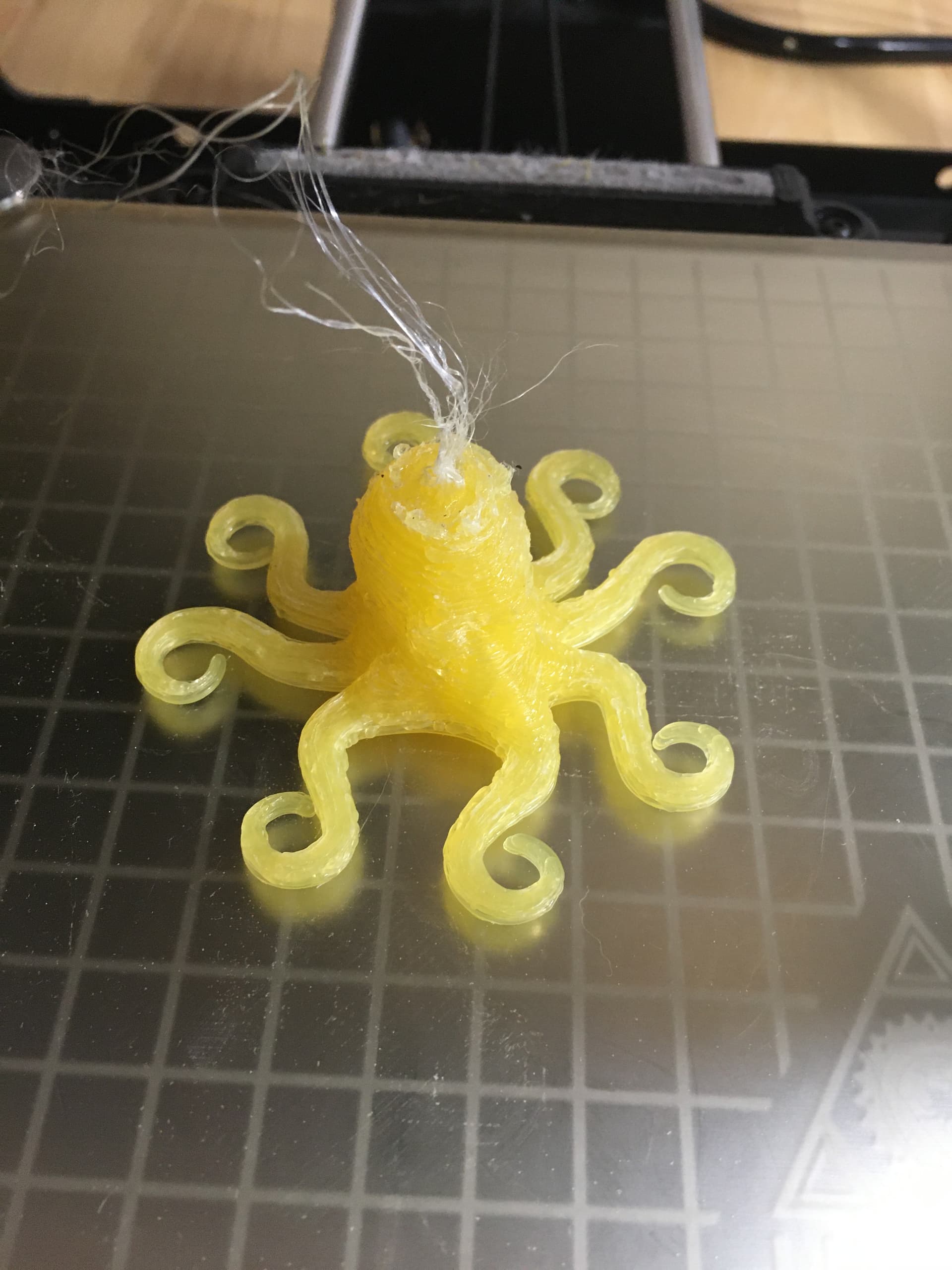

I just got the printer used and was doing a test print. I tried restoring the defaults but still no luck. Any help would be appreciated!

The printer is a Lulzbot Mini 2. It has a M175 tool head. The filament is Polymaker Polylite PLA. Printing temp 210-230 and printing speed 40-90 mm/s. The Cura version and Printer firmware I updated yesterday. I am trying to do the test print. I’m using a windows 10 laptop connected via usb. I have already reset to defaults (was a used printer).
Thank you for that.
A few things I would like for you to check.
First, be sure that the estep value for your printer is set to 415 steps/mm.
Next, It is possible that the gcode flavor in your Cura got changed to Marlin(Volumetric) by accident.
It should just be Marlin. This can be adjusted by going to settings>printers>Manage printers and clicking machine settings. Then change gcode flavor to Marlin.
If this is not the case, can you please send us a gcode file that you sliced? This may give us some insight into the issue you are experieincing.
