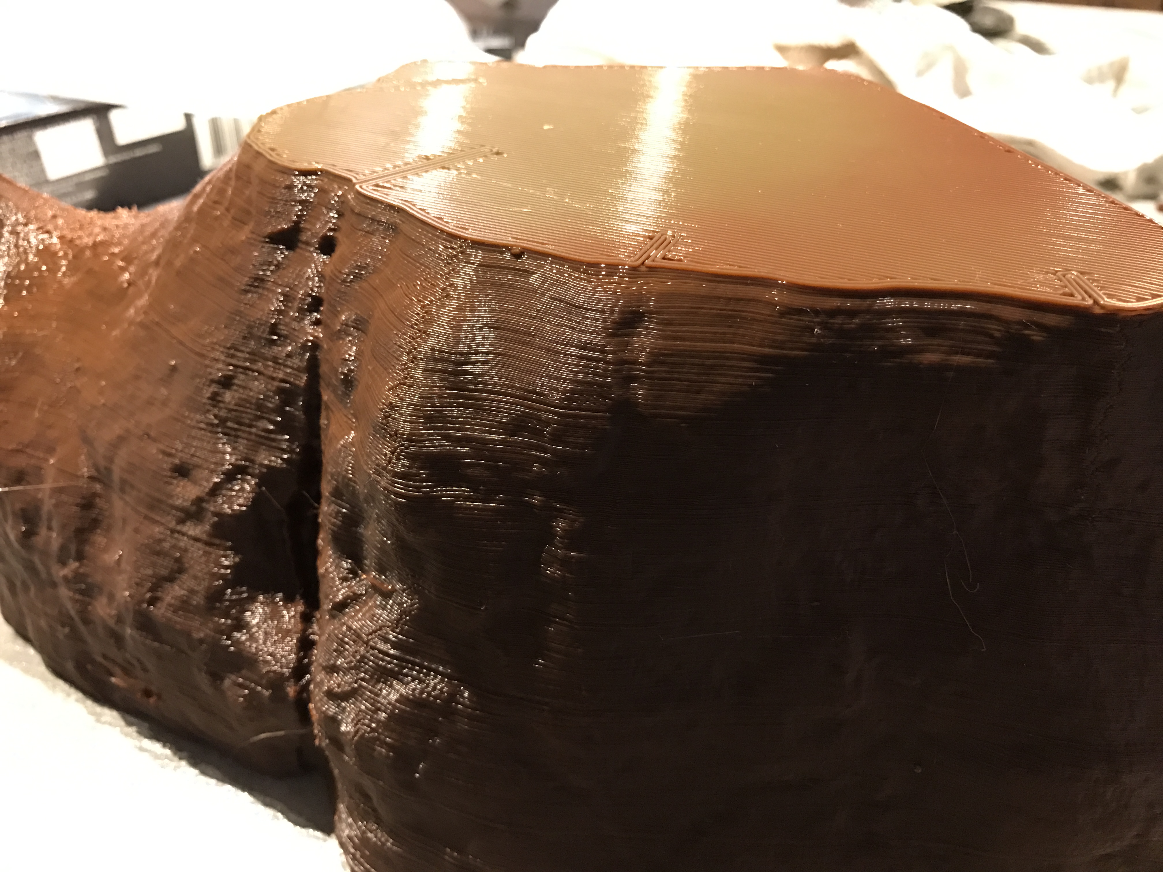

Hi all. I’ve just received my Taz 6 and love it… but it’s been a challenge dialing it in. My rocktopus printed fine and my first print went alright as well in Ngen, however now I’m printing a life size trex skull (estimated over 30kg of filament) and I’m getting heavy banding in the z axis. I did have one failed first print that resulted in a HUGE tangle of filament and that caused the z axis things to bind up as well as the y axis belt to loosen but i tightened it up and relevelled the axis and thing I have that sorted out. I’m just getting heavy banding with PLA (maybe other filament as well but haven’t tried) and it’s super ugly.

There isn’t an anti wobble that will fit a Taz 6 yet. There is a bit of a space limitation in the Z axis design that makes fitting one problematic without a redesign. You can try the “clock one of the leadscrews over 1/4 turn and see if that fixes it”

Not so complicated as that. You basically just power the machine off and unplug the motor, then deliberatly turn the leadscrew a bit just so the thread pattern is slightly offset, using the auto leveling to compensate. It can work, it may do absolutly nothing for you through too.

Basically an anti wobble device divorces the x and y motion of the leadscrew from influencing the carriage position, while preserving the exact z axis position the carriage should be at. Each time you turn a leadscrew, the leadscrew nut tends to want to shift slightly to one side due to the angle of the threads in contact and gravity due to the tiny amount of play present between the nut threads and the leadscrew threads, and in thevery case of the Taz 5, flex in the x end plate. A bent or malformed leadscrew will increase the presence of wobble.
Two contra rotating leads crews would help combat the issue, but they are somewhat rare. De syncing the leadscrew rotations so that the thread positions are slightly different can sometimes also help. It doesn’t always. It also doesn’t matter which screw. The downside is that doing do places the bed slightly off level.
How this all translates into cleaner layer lines is related to whether your printer is experiencing wobble or not. To tell if you have wobble, print something, preferably a cube or a cylendar, then hold it up next to your leadscrew. If there is a layer offset pattern that matches the leadscrew thread spacing, you have z wobble. If it doesn’t match it’s a different issue. If wobble is present, the anti wobble just prevents the offset force from trying to move the print head, leading to no layer offset.

For the Taz 6, you would need to lose a good 22mm worth of print travel to fit one in, which is the main reason there isn’t one yet. That or rebuild the x ends. The 6 generally doesn’t have wobble because the z rods are better placed than they are on the Taz 5. Where it is present, there isn’t a good permanent fix for it.
