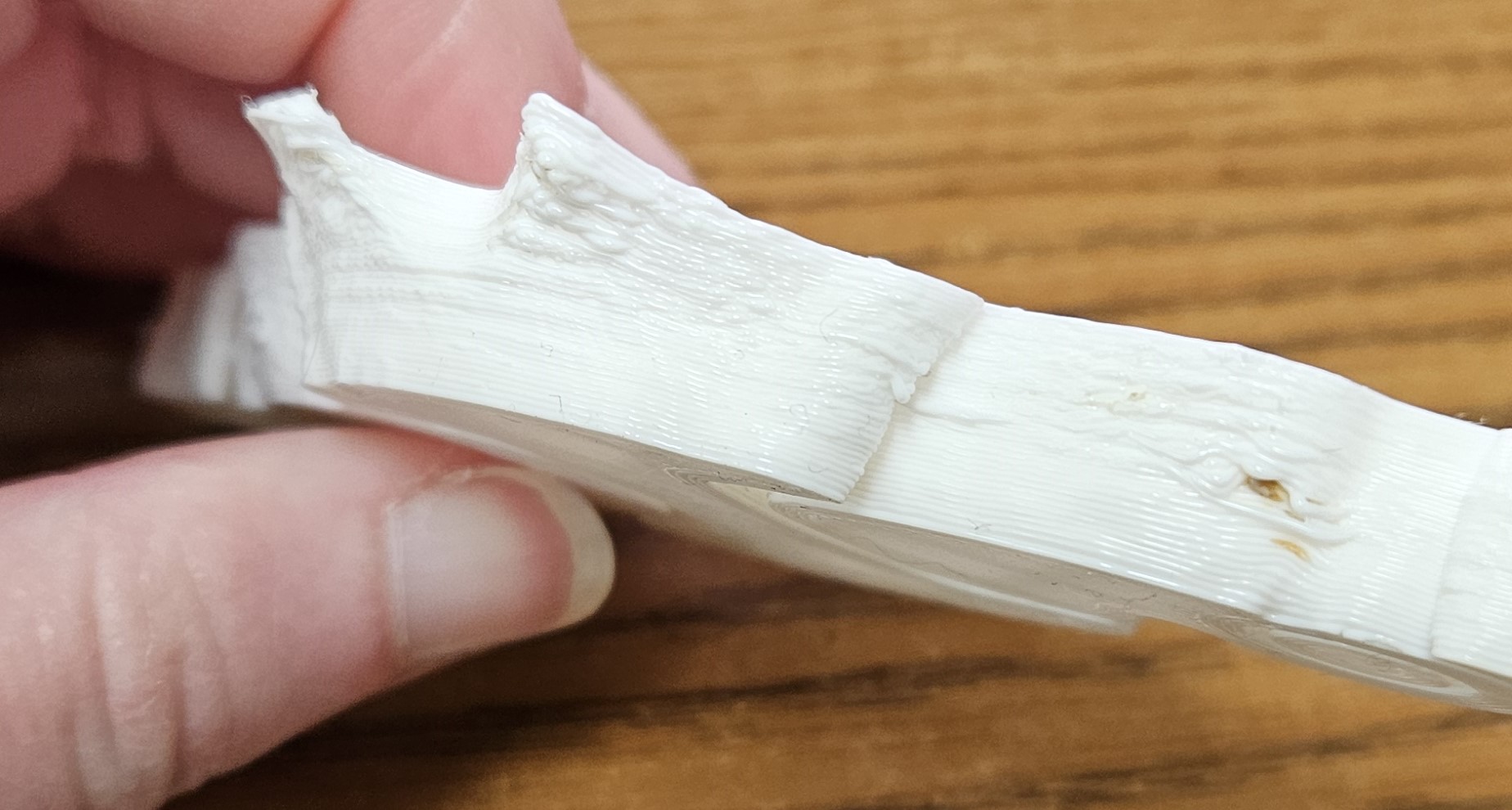

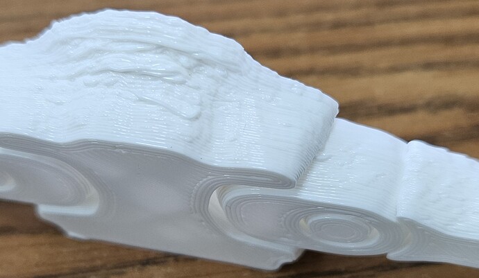

I was doing a print of “Rat Articulated Fidget Figure” by MatMire_Makes over at Cults3d and noticed that some sections of the print (including some some of the joints) looked like they were not cooling fast enough. I don’t think it’s step skipping since other sections of the print on the same layers is fine (there are supposed to be some bumpy areas as it’s supposed to be “fur”) and we did a print a few days ago that was mostly just a cube with minor issues on one side of the print at different points but nothing like what happened with this print.
Is there something I need to adjust to see if it helps with this problem? This is only the first attempt at the print as we can only print on the work machines for 8 to 9 hours in the day.
The machine we are using is the Taz6 with SE Tool Head (0.5 mm). Cooling is Enabled though the only fan I notice running is the one on the left side of the tool head, not the front one… so not sure if that is playing a factor. Default printing temp is set to 205℃, with initial layer being 210℃ and initial print temp at 195℃. Build plate is set to 60℃ with flow set to 100%.

The extract you posted from (I believe) CuraLE (unknown version) shows that the part cooling fan should be off for the first layer and then on at 100% for subsequent layers. Although you didn’t mention the type of filament, the temperatures you are using suggest PLA. This type of filament loves part cooling so if the part cooling fan isn’t running, this could be causing the issue.

The front (part cooling) fan will come on and off via control by the slicer. As B-Morgan said, if you aren’t seeing this fan on during all but but the first few layers of the print with PLA, there is something wrong with the fan, wiring, or control board.
